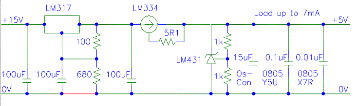

Those designs with LM317 & TL431 are good ...
T's classic with update (2012):
maybe time for some updates.
If you need more current than the LM334 can produce use an LM317, it makes an okay CCS. If you can, use a discrete C4S, but the difference will be much less in reality than the few 100K of the 317 or 334 vs the GOhm of the C4S suggest.
Nowadays I bypass the upper resistor of the Voltage set in the 431, even in tiny "microshunts", but it is not an absolute requirement.
In those days Cap's where at 0805 for pretty much the limit. Nowadays, if you can manage the layout you can use 0612 Parts or 4 pcs 0603 in parallel.
So make the 10nF X7R 4pcs of 100nF 0603 in X7R, add 4pcs 10uF 0603 in Y5U dump the 15uF Os-Con for several 100uF of the cap you like best.
Depending on application I use nowadays either Sanyo Os-Con 470uF/6.3V, Elna Silmic II 220uF/16V or Nichicon/Sanyo Low-Z up to several 1,000uF...
Around the 317 I now use large ESR output cap's, usually 1,000uF or more, to kill the inductive tendency of the reg. Think of the Cap as a Zobel that flattens the impedance of the 317 and select capacitance and ESR accordingly... I learned this trick indirectly from Jocko's SPDIF input circuit... 😛
In fact, you will still find variations of this regulator circuit (with a variety of actual CCS Circuits, from 317 to C4S and anything inbetween and a variety of shunts from discrete sub nV|/Hz to the very noisy 431 with or without current boost) all over AMR's gear. We have tried others, so far we keep using this if things really matter for performance. We sometimes tried to "shortcut", deleting either CCS for resistors or using more normal regs, they never seem to cut it as well.
Some of new microscopic low power, low noise regulators from AD, TI and others are starting to show promise, especially if you draw some extra current, they are sufficiently better than 317's to warrant using them in lower cost products where you want to beat the 317 or it's SMD cousins...

For what I know, a non feed-back shunt reg is even better and musical : the TL431 does not output on the load but feed Darlington like a TIP142 or 147 for negative; ok you can filter the resistor of the shunt with a 2 to 4 nano cap. The impedance will be very low and larger, output is the same, the energy came of a big cap before the shunt and the darlington : of course the shunt has its own filter cap also.
Rapid and musical, even if a feed-back could show better results... on the scope only, not to the ears !
Variation exist for the shunt like the Abraxalito one !

read Ts comments in post 22, they use LM317 and CCS then TL431 in many AMR products. I like these regs and have modded 3 cd palyers extensively and like the difference they make. Im sure there are bettter, but for very little money you could build a benchmark psu to use in comparisons while you try more interesting and exciting designs. I also plan to compare some salas shunts at some stage.
It sounds interresting but have a lookt at what ANdrea Mori did already : a great benchmark with powersupplies. I almost sure he already tried those and can answer to you for saving time and money. Peufeu advices could be welcomed also... (if you reading this Peufeu !)
Well have you a shematic of the T' PS : basicly a LM317 feeding a CCS near the shematic Audiolapdance has just given but with a Darlington ? Am I right ?

"glen wrote:
Or just use TPS7A4901 and TPS7A3001 regulators instead of fooling with ancient noisy gloried zener TL431's ?
Those new Chips look at best 3dB quieter, so they are not all that horroshow.
The point of using a Shunt regulator and a CCS is however a little different.
I the thread over at the pub I mentioned "think where the current will flow".
If you think that way you will understand why TL431 and CCS.
Ciao T"
