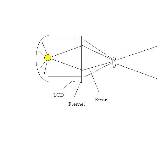

I'm wondering. If a parabolic reflector is used, will not the light that comes directly from the light source (without beeing reflected) cause errors? That light will not come in parallel to the other light that comes through the lcd and the fresnel, and thus the light going through a specific lcd pixel will be placed in different parts of the final image.
I'v attached an image that hopefully will make you see what I mean.
Using a reflector in front of the light source so that only reflected light will come to the lcd would make a dark spot in the center of the image where the reflector prevents the light to pass. Placing the light source a little bit farhter away from the parabolig reflector would "fix" this, but then the light that comes to the lcd won't be parallell.
And also, doesn't this problem exist in most setups that uses reflectors?

Yes, using a parabolic reflector with an unshielded lamp will give you a lot of direct light that may cause a fuzzy image. (Most of that light will not even end up at the projection lens.) But you can add a tiny spherical reflector to send the useless light back through the lamp arc to the parabolic reflector. Lots of commercial projector lamps have such a tiny reflector built into the lamp. It would make a hole in the center of the light, except for the fact that the arcs of the lamps we use are so big that the light is never really all going in parallel.
Spherical and elliptical reflectors don't have this problem when they are used correctly. But still do have the problems associated with the large lamp arc. A really good projector lens will focus all the different rays passing through a pixel to a single point on the screen. A bad projector lens will send them to slightly different parts of the screen to give you a blurry image. You can get a good image with a small lamp arc or a good lens. If you have neither one of these, you will not be happy with the image.

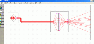

I'm wondering, how tightly could this parallel beam be collimated? Would it be practical to shoot it a distance of say, 15 feet, before the second lens (spreading it to the first fresnel)?
I'm excited about the idea of polarization recycling, and thought it might also be cool to have the light box separate from the LCD box (for noise, heat and bulk reasons). The idea of being able to usefully place beamsplitters and mirrors around my living room, optics-lab style, is for some reason very appealing.
Pipe dream? Too much light loss?

nice drawing
Looks very nice, but I think it is very difficult to collimate a beam to go 15 feet without spreading. You need some very precise aspherical optics designed just for your setup. It would also probably have to use a dual-slit device to remove non-parallel rays. That works by just throwing away the light that is not going in the right direction. With the typical lamp arc lengths in the bulbs we use, you could never do it.
Maybe you could satisfy your need for nifty optical displays by adding some laser beams bouncing off mirrors in your media room? They could do something useful, like serving as aisle indicators, etc. They do tend to be collimated very well, since it is far easier with monochromatic light coming from a very small point source.

Thanks very much for your response Guy. I wouldn't want to remove 80% of the light just to make the lightbox a little more distant... better off just using a 80% smaller (quieter cooler lighter) bulb in the LCD box!
