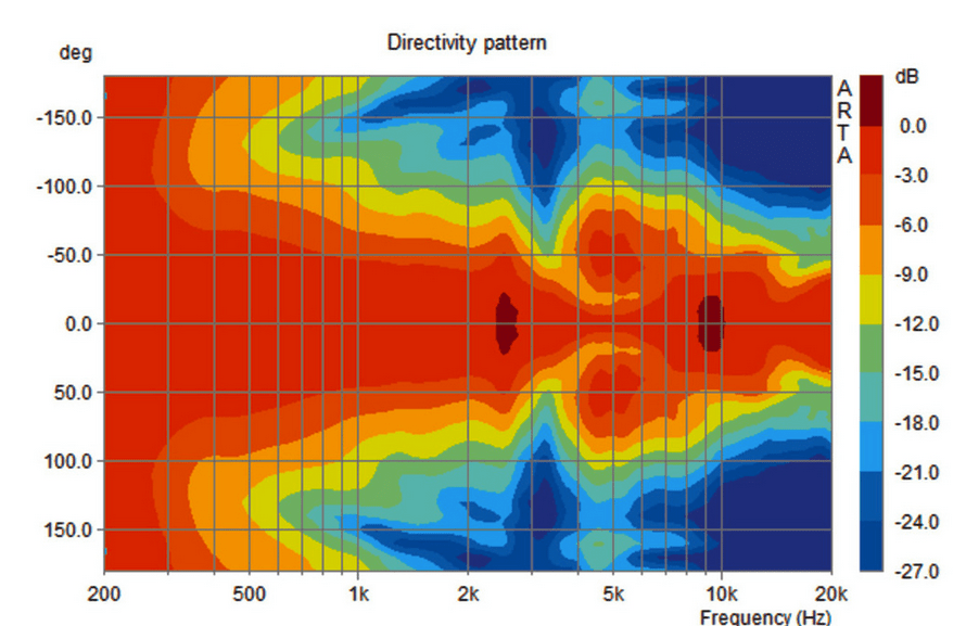

I'm not sure if you're lumping the overall crossover integration into your "phase alignment" bucket, but more shallow crossovers and larger driver spacings tend to take more distance for the drivers to integrate properly. Listening or measuring closer than the design distance can introduce frequency response changes.
Expanding a bit on what newvirus2008 said:
If your speaker has a significant lobe in its vertical directivity (especially one with a tilt), listening at a different distance may put you into or out of that preferred zone. First order crossovers typically have a tilt in their vertical directivity pattern, which is why you often see sloped or stepped baffles to counteract that, inverted driver configurations, etc. with them.
Beyond all that, near-field listening tends to give you more direct sound from the speakers, since room reflections are proportionally lower in level and more delayed than when listening at greater distances. Some people just prefer the near-field sound. How the room is set up is also likely to influence things. If your speakers are farther out into the room in general, some of the distance-related room effects may lessen.

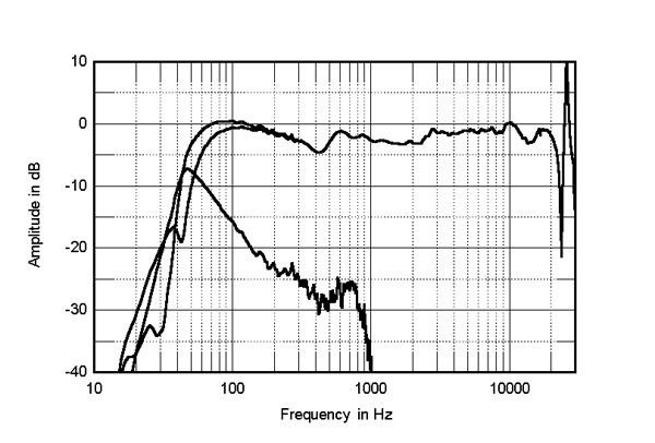

here is from a stereophile review on genlec 1031a
An 8" 2 way with what I would call an amazing way to horn load a dome tweet.
"The Genelec 1031A Studio Monitor is a so-called nearfield monitor (footnote 2). This means simply that it's designed to be listened to from up close, which is how I first heard a pair of them—from a distance of a little more than 30"........Nearfield monitors are designed to have a slightly depressed midrange, to make them sound farther away than they really are, and are not intended to be listened to from 7' or 8' away.......
From a nearfield listening distance of a little over 3', the Genelecs sounded almost shockingly real, with the kind of micro-detailing that is rarely heard outside of a live performance—barely perceptible finger squeaks, page turnings, valve clicks, and glottal sounds from vocals. This was detail of definitely high-end caliber. The Genelec has the best-sounding amplifier of any powered speaker I've heard, and delivered some of the most realistic, alive sound I've heard in my home.
Unfortunately, at a typical home-theater listening distance of 7', some of that magic was gone. Some detail was lost, and the high end became slightly hot, while the range below became (in my relatively dead room) a little laid-back and subtly blurred, as though the system was involving the room acoustics too much."
and
"So...would I recommend this system to a Stereophile reader? Not for typical listening at 7'."
eek..........................
"But Genelec's 1031A speakers are not crap; they are superb for the purpose for which they were intended—close-range listening. My problem with them in the context of this review is that they are being marketed for applications—far-field and multi-channel listening—for which they were not designed and are ill-suited.
It's obvious, though, why Genelec speakers are so popular with recording studios: Used as they are designed to be used, they are amazingly accurate devices."
and
"I recommend Genelec's 1031A for close-in stereo use"
here is stereophile's freq response chart

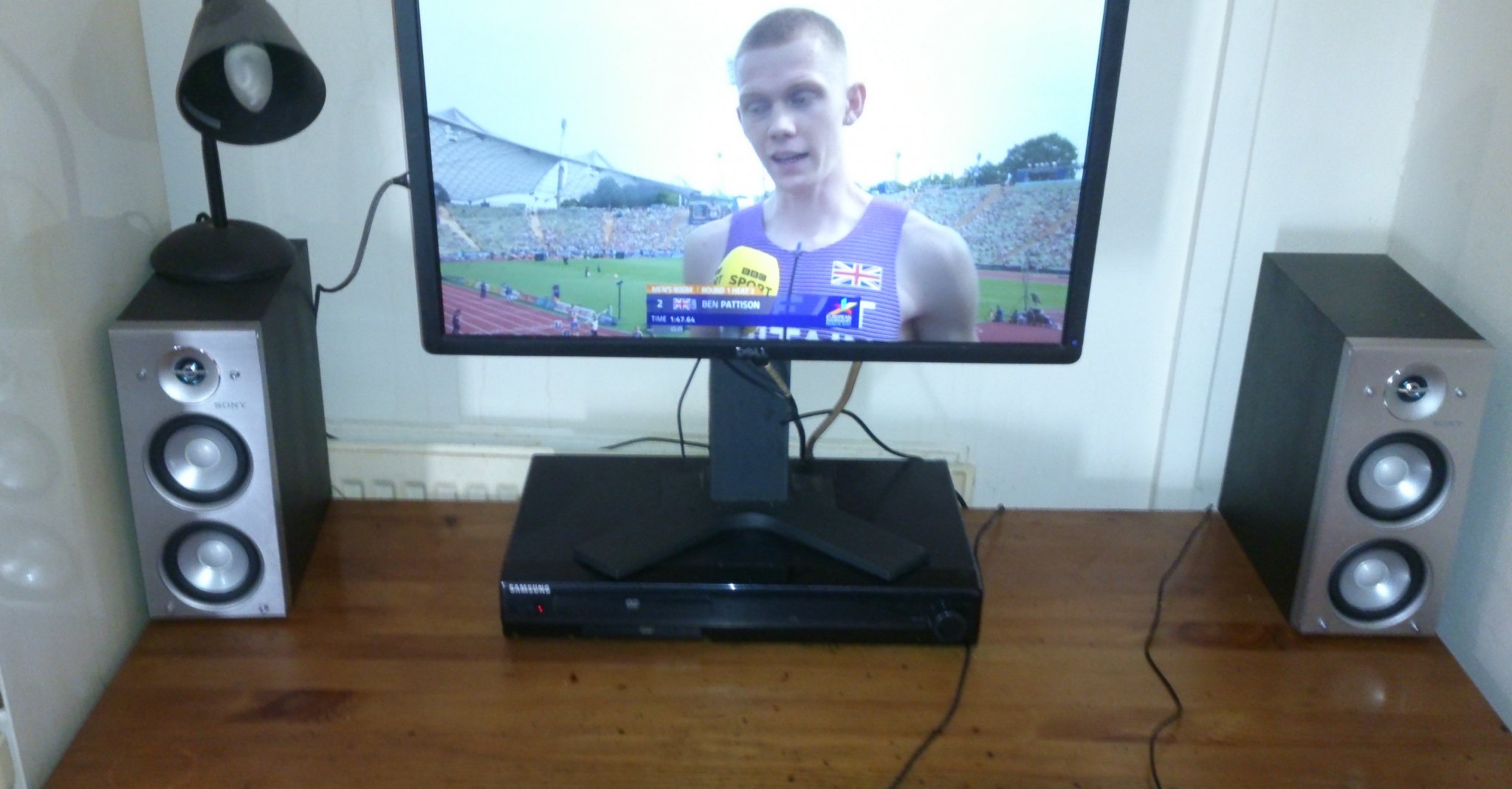

I have a similar issue so I'll semi-hijack this thread. My question is with regard to desktop acoustics. From anywhere in the room my desktop satellites sound fine, possibly a little bright for most tastes. However, sitting at my desk they sound awful., the vocal range is far too loud. The speakers are four feet apart with a three foot listening position.
I can only surmise that my issue is due to the cubby-hole effect.
Yup,
From the amplitude perspective - I suppose there might have been a speaker designed for such a space, but it would be a unicorn - profoundly rare. The lack of dispersion in your cubby would cause a plethora of unexpected bumps and dips in the response. With some effort, you could fix the ampltude problems with a MiniDSP and UMIK-1, but this would be tedious and would do nothing to affect the early reflections.
From the phase and reflection perspective - The early distinct reflections from the side walls and desk top would be very close in arrival (at your ear) with the very clear primary wave form. This would make the perception of distortion very profound.
Moving away - As you move into the room, all of the wave forms overlap and get muddied. This makes things... tolerable - in my experience.
Can't tell from the picture, but those speakers likely have rear ports. If so, placing them against the wall is going to really boost the bass. Way too much. If that is the case you can try to plug up the ports with some cloth. Won't solve your problem completely, but might help somewhat.
