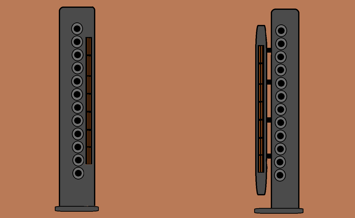

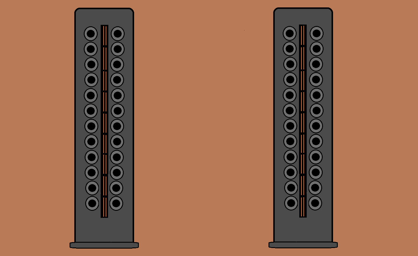

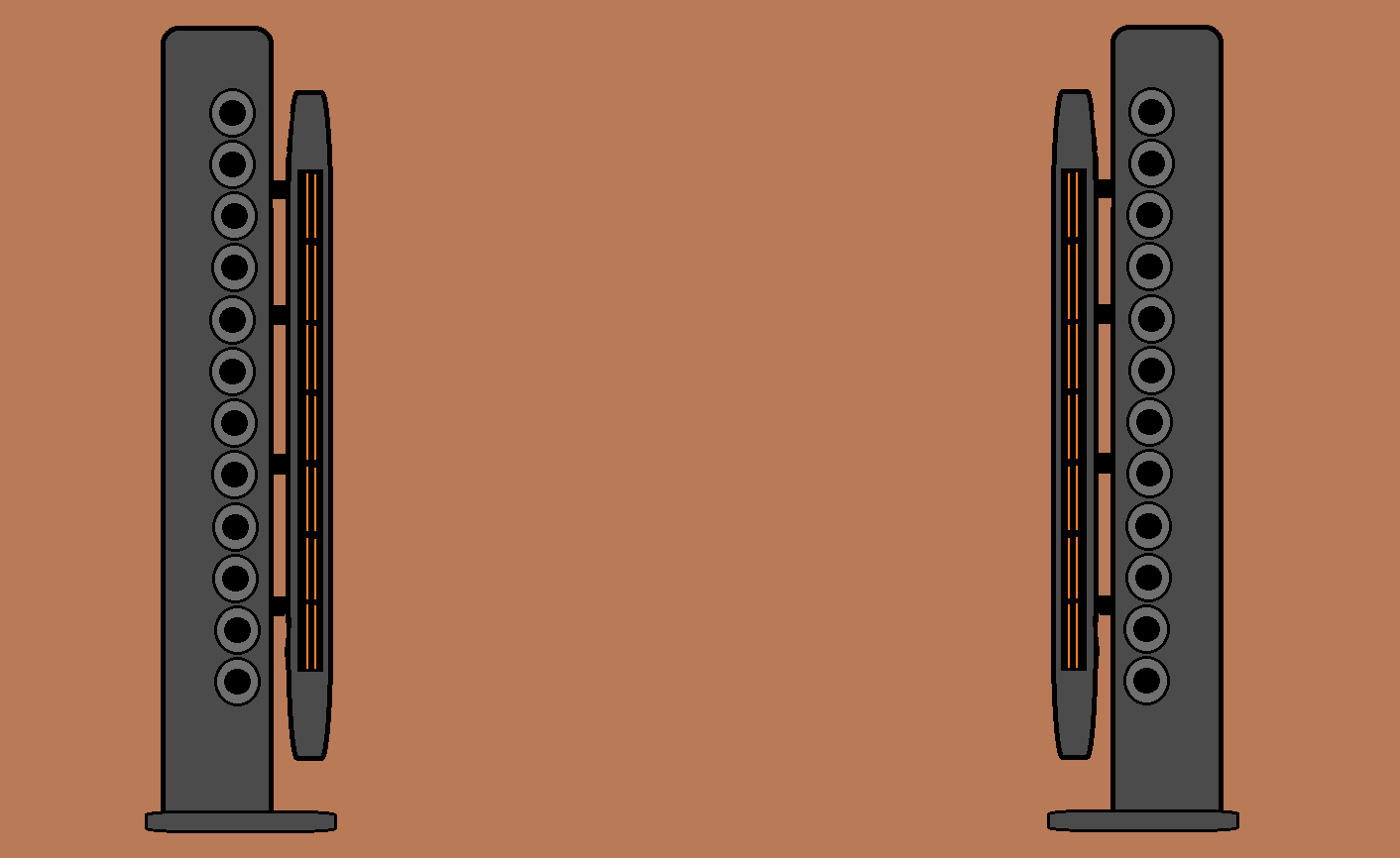

Cool. At least I can have symmetrical lobing even though my baffle is going to get bigger.
It looks like my biggest issue, at least on paper, is the size of the 6 1/2" drivers I chose even though I haven't heard any issues (subjectively) myself. They have an Fs of 52Hz and I should have them crossed above 208Hz but I tried crossing them at 250Hz, 300Hz and they sounded better to me crossed at 75Hz where my subs take over.
I chose them because, well they were cheap buyouts and have a high qts for open baffle. I tried crossing my planar tweeters lower (around 2kHz) but it didn't sound good. When I crossed then at 3200Hz it sounded much better even though with the 6 1/2" diameter they shouldn't. So far I've been using 3rd order slopes on everything.

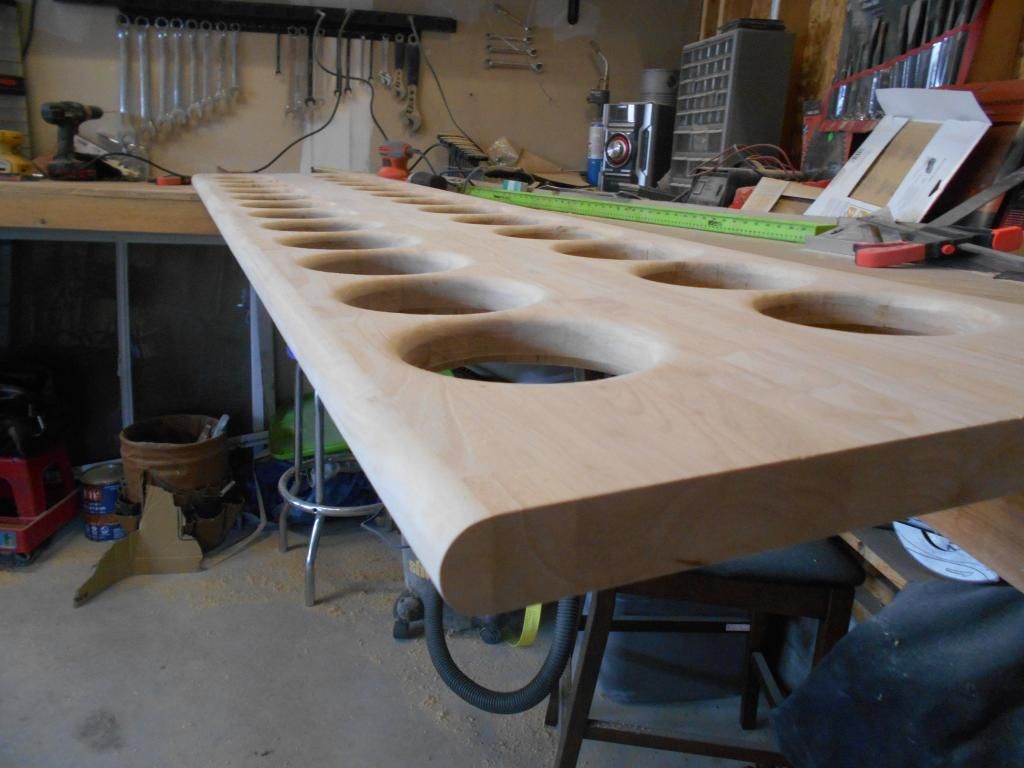

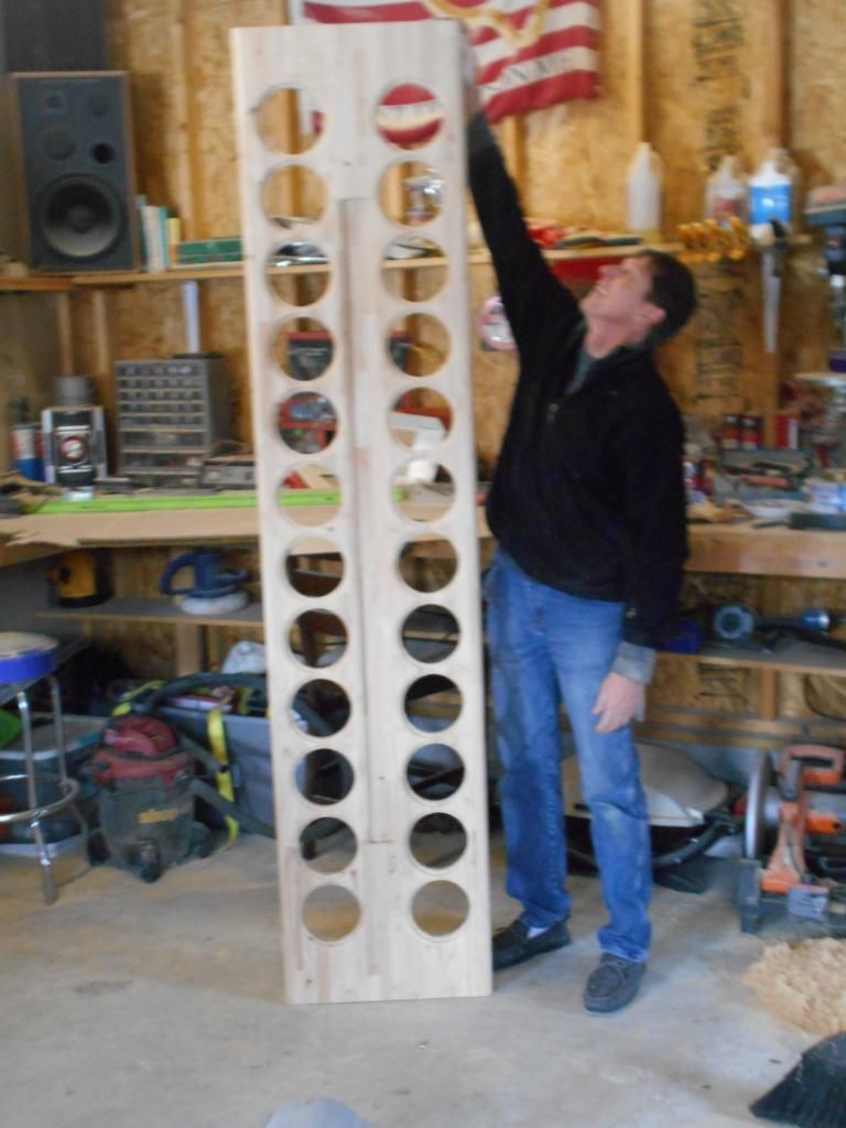

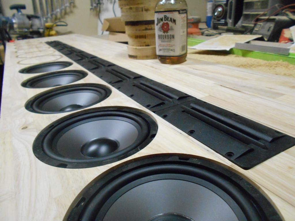

Just ordered the additional drivers. Now I get to look forward to drilling for and flush mounting 33 drivers per baffle!

Actually the mid-woofers are 6 5/8" inch apart vertically C-T-C and they are crossed at 3200Hz. I know, that's way out of spec to prevent combing. They were cheap Buy-outs with a high Qts suitable for OB and extend as low as I needed. I put them in a mock up 1x12 and added a single PT2C Planar to the side. I used a pair of woofers crossed at 75Hz located elsewhere in the room. I figured I'd hear some nasty combing but I didn't. Maybe my ears just aren't as trained as I thought they were but I really liked what I heard even though I shouldn't have.
That's when I decided to go forward and got a total of 18 of the PT2C drivers and enough mid-woofers for 24 per baffle.
In My next build I'll do my best to give more consideration to the fundamentals of C-T-C spacing. 😀
