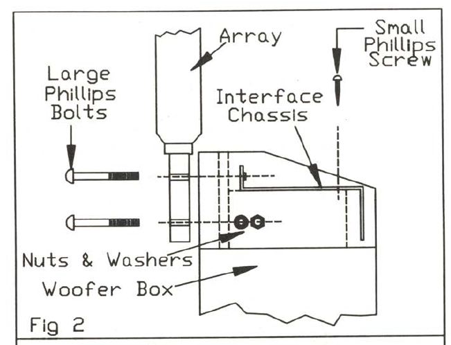

Dissasembly of Acoustat Spectra 11
You will need one small and one large Phillips head screwdriver.
A pair of pliers may also be needed to hold the lower nuts, although fingers have always worked fine for me.
Attached also is the manual and other info you might find useful.
