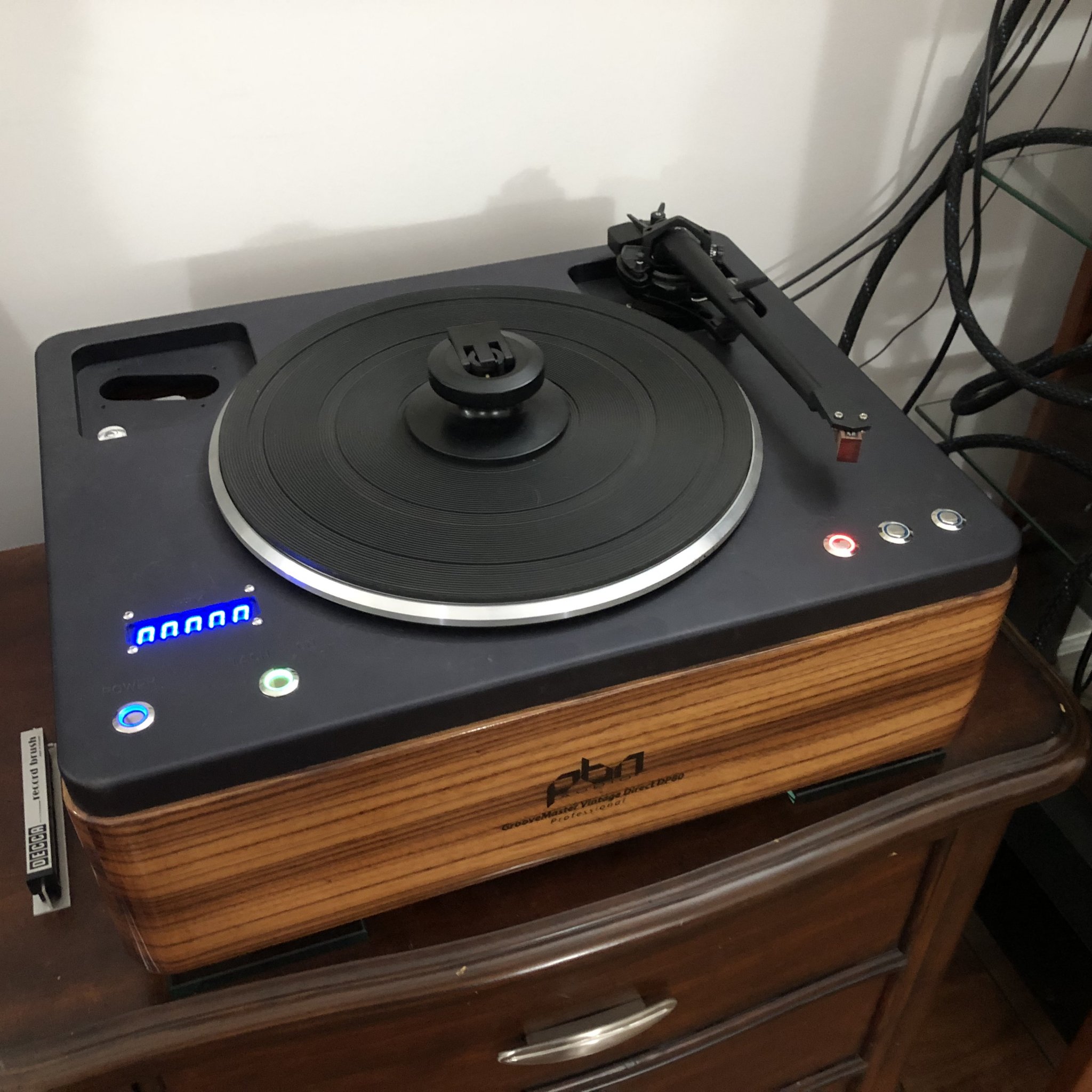

Display Turntable speed with an Arduino Nano
Some turntables come with a way to adjust the speed, some with a way to see the speed, but most do not have either. This project is for the person who wants an inexpensive but accurate way to see the speed of their platter on a digital readout. The display is five seven segment LED displays, two whole numbers and three decimal places. The Tachometer cost under $50 USD to build and is quick and easy to build. It is on 2 ¾” square PCB so will fit in most any table internally with a window to see the display and the trigger LED.
The project uses an Arduino Nano to perform the timing counts, calculations and run the display. The Arduino Nano’s clock crystal is neither stable enough nor accurate enough to use for the clock, fortunately the Nano can be configured to accept an external clock as the timing base. I used a 10-Megahertz oscillator that is good for +/- 2.5 PPM (Parts per Million), so within 9,999,975 to 10,000,025 Hertz. That’s a 0.00025% error rate, accurate enough for even the most stable tables. The 10-Megahertz clock output is run through a divider chip with does two divide by 10’s, so the clock is 100 kilohertz to the timer counter.
The Arduino has three timers built in but to make the timing accurate you must shut off the other two timers, timer 0 and 2, so there is no processing overhead to mess up the timing. Timers 0 and 2 are 8-bit timers, too small for counting the 100 kilohertz clock, produces too many overflow interrupts. Timer 1 is a 16-bit timer which is adequate to the task. As you can see from the source code the setup() procedure’s first five lines manipulates the processors registers to set the timers up. The processor uses two interrupt service routines for timing, one internal to count the number of times the counter over flows and the clock pulses, and one external interrupt connected to a Hall Effect sensor which is placed under the rim of the turntable platter and a small button magnet is glued to the underside of the rim of the platter. The magnet is small enough and light enough not to affect the platter balance.
The PCB has a 5-volt regulator on it so you can feed the board 7.5 to 12 volts DC. The optimal voltage in is 9 volts DC. While the regulator can handle higher input voltages the heat dissipation may be too much, 12 volts is pushing the thermal limit of the PCB heat sinking capability.

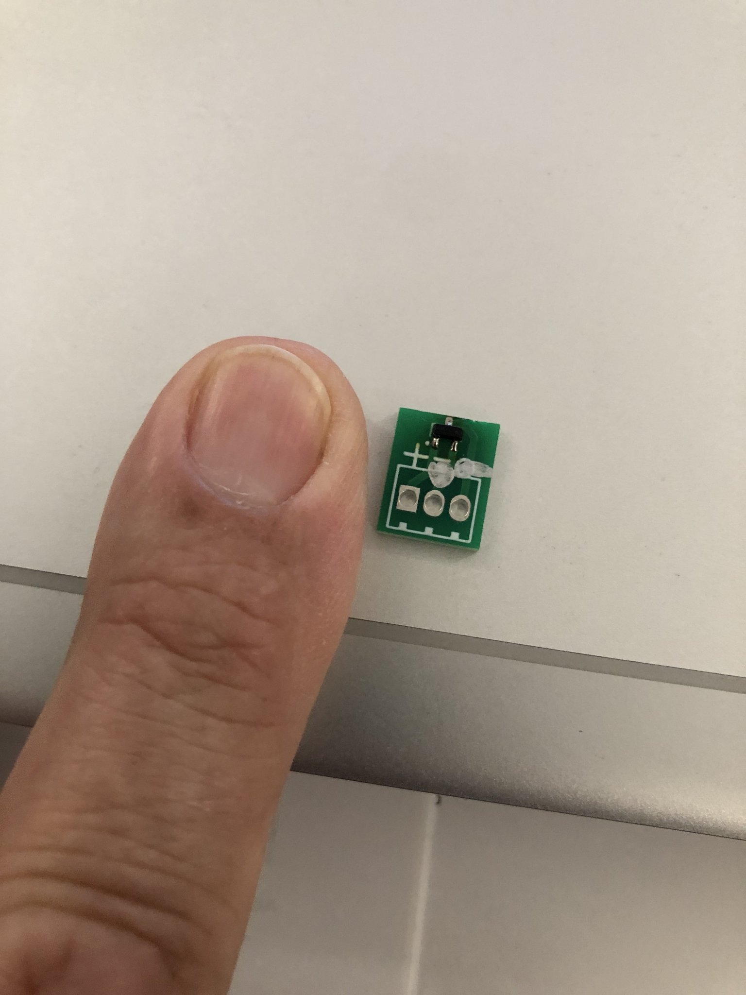

Note: the cost of the tach is using Blue LED displays, we build one with Red LED displays, a lot cheaper, and it still looks good. The hall effect sensor is around $10 but I designed a small ½” square board with a $0.60 hall effect sensor on it so cut the cost to about $1. So, an overall savings of $15 with Red LEDs and the home-made sensor. I will post the gerbers and part number for the Hall Effect sensor in another post.
This post has the PCB gerbers, the schematic, the BOM, a couple pics, and the code.
Operations: when the tach is powered on it runs through the setup of the Arduino and, before it exits, turns on all the LED segments for 5 seconds, this is a test to show you if you have any issues with your soldering. Then the main code runs, loop(), which looks at the number of overflows of the counter, which being 16 bits can only hold 65535 clock cycles before it trips the overflow flag and resets. If the platter isn’t turning the overflow count will keep going up, but once the number of overflows is over five, long enough to see the platter isn’t turning, it shut off the display. As soon as the platter starts turning the overflow number is reset by the triggering of the hall effect sensor and the display comes on. Whatever speed the turntable is spinning the speed will be displayed whether it is 33 1/3, 45, or 78 rpms. My table is a Denon DP80 built into a heavy plinth and typically displays 33.332 to 33.334 which is extremely stable and what Denon was known for. A friend is working with some Pioneer high end tables with a custom platter and heavy plinth and is seeing similar numbers, once the tables warm up. For grins I stuck a magnet to the side of an old, cheap Girard table and it was varying a lot more than I would like to see in an audiophile table.
