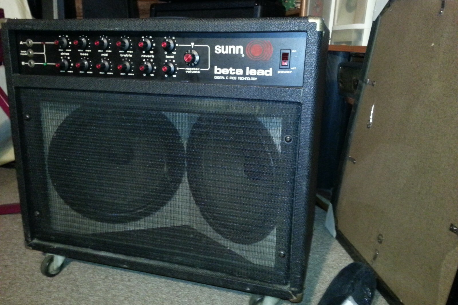

FOLLOW Physics Laws instead of fighting them 🙂
People who KNOW their Physics:
SUNN
Behringer/Bugera
CARVIN
SUNN
Behringer/Bugera
CARVIN

Now, that one I had never heard about. Thanks!JMFahey said:Gibson GA79RVT
So the idea did catch on with at least a few guitar amp manufacturers - but very briefly, apparently ending after Watkins, Fender, and Gibson each made a single model.
I'm not surprised Leonidas cost-engineered his way to a flat baffle. I'm a little more surprised Gibson didn't continue with the idea.
Perhaps customers didn't want the unusual appearance?
Of course, two angled speakers don't actually solve the dispersion problem. You have two searchlight-beams of treble instead of one; an improvement, but not the same thing as uniform dispersion over a reasonably wide "sweet spot".
