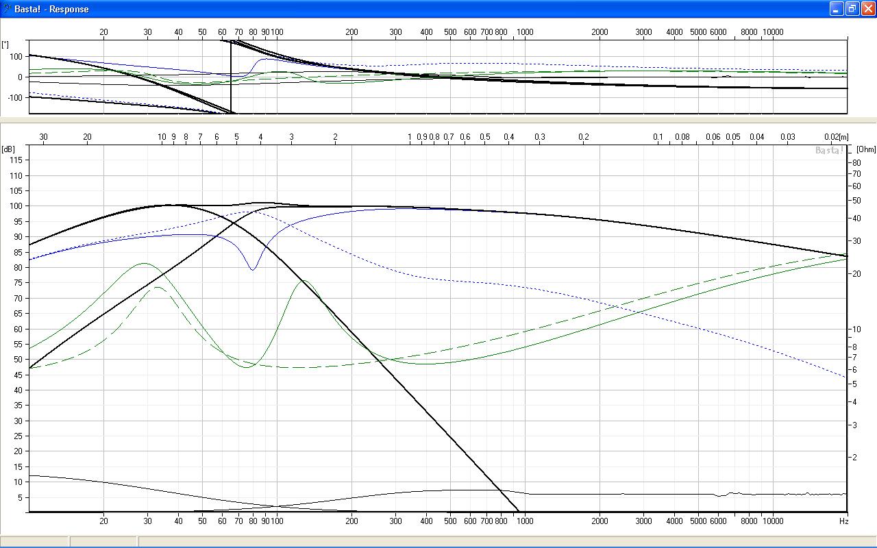

So, I've decided to keep the 12PE32's and match them up with the DE250/ME45 horn, crossing over at 1kHz or thereabouts. Active crossover @ 24dB. For the lowest octaves, I'm using the Dayton reference 12" subwoofer and the O Audio BASH plate amp in each box. Each loudspeaker will then be 44" tall or so, 16" square, give or take, about 3.5 cu ft total per box. The baffle will be covered with 1/2" sonic barrier. Here's hoping!
So, the ME10/DE10's and the D54's are for sale on eBay.
Here's the combined response of the 12PE32 and Dayton 12" subwoofer. The 12PE32 is cruising along at 1 watt whereas the Dayton needs 10 for the same SPL. I think it's pretty good in simulation anyway. The Dayton has a 24dB active filter set to 70Hz. Hmmm, I can't remember if the O Audio has that kind of filter in it...
