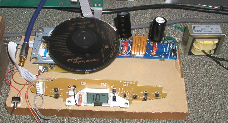

When I saw a dismantled HDD it looked so much HiTech than my CDPRO that I felt (feel) ch**ted. :D
Don't worry, I'm presently using transport that I took out of $50 boombox and it rivals CDPRO. And all those ideas came from looking inside Shigaraki, which I liked a lot ;)

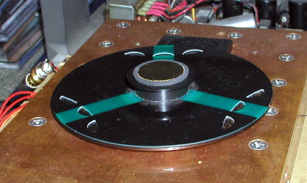

On my CD-Pro I'm using non magnetic clamp which is made out of Marigo mat, CD-Pro clamp with removed magnet and brass insert added for weight. That clamp made substantial improvement over standard magnetic clamp supplied with the mechanism.
I tried it also on a transport pictured previously, but I still preferred the magnetic clamp that came with a boombox: the sound is more open and airy.
I will later try to install a turntable with 3 springs that hold CD, like in Rega Apollo.
