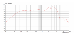

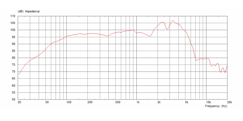

I've played an electric guitar straight into a bass guitar amp, and I agree, the sound is less harsh than the same guitar into a typical analogue SS guitar amp (but also sounds duller).
That difference almost certainly comes down to the difference in loudspeaker frequency response: most guitar-specific speakers have an enormous treble peak at around 3 kHz, right where the human ear is most sensitive. That peak can give the guitar "bite" and "edge" when a good tube guitar amp is in the mix, but the same peak accentuates the harsh clipping from high-NFB solid-state gain stages in traditional analogue SS guitar amps.
For instance, here is Celestion's published frequency response for their very famous and very popular G12M Greenback guitar speaker. There is about a 10 dB (!!) peak around 3 kHz.
-Gnobuddy
