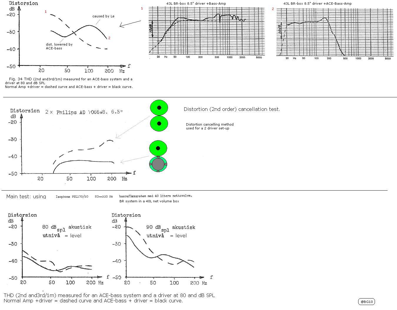

I wonder if a typical plate amp could use a dirtied up tube input stage to flood the amp with 2nd harmonic distortion for this.Taking aside the 2nd harmonic cancellation of the sub box/driver design what if you power said sub design that has a amplifier power source that is maybe designed deliberately to re-inforce said 2nd order harmonics? Does this give you the perfect sub?
