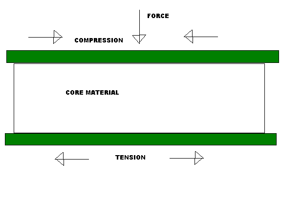

In a structural sandwich system, a thin top and bottom layer is attached to a core material. The core material may be strucurally weak on its own, but with the addition of these layers, deflection strenght is increased. The strenght of these layers is along thier axis, they resist stretching.
When force is applied to the panel, the nearest layer is in compression, the farthest is in tension.
The potential benefits are negated when used on an extremely rigid material like HDF.
Now that you have shot down Dave's building methods and my considered methods, perhaps you could suggest a few of your own that you consider worth trying. It's always interesting to see how others build.
Why are the benefits negated? This whole principle combined with the extra strength added by having a variety of grain directions is the reason that many consider plywood to be structurally more sound than solid wood or mdf.

The sandwich method to increase stiffness works VERY well. It's a structural system that depends on each part playing it's role. The outer layers have to resist stretching or crumpleing under tension or compression. The core needs to be just strong enough to link the two layers.
The typical hollow slab door in a lot of houses is a good example of sandwich construction. The core is a cardboard honeycomb link the front and back which are thin plywood.
Perhaps to use carbon fiber more effectively, you could form a sandwich panel by putting it on both sides of a core (such as plywood).
