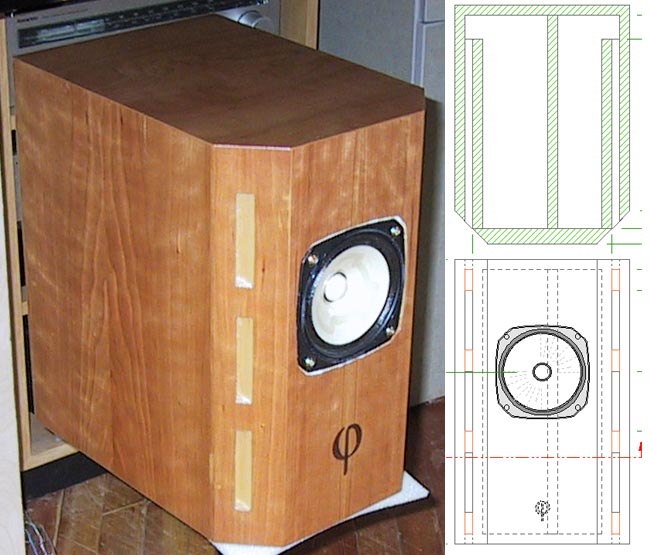

Second, people that I know that know structural dynamics tell me that the best way to apply damping to a mechanical structure is to make a sandwich construction. If the damping layer is in the middle of the wall (eg damping glue between two sheets of MDF) there will be strong shear forces on the damping glue, and so it will absorb a lot of energy.
Applying damping material (asphalt, carpets etc) on the inside of the box is of course not bad, but it is far less effective than a sandwich construction.
The "big" side panels of the Fonken use something like this... mdf + air in a plywood sandwich.
dave
