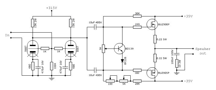

...at the risk of thread-jacking
...has anyone got plans for a really well designed hybrid amp - using the best features of both solid state circuitry and valve technology?
Preferably class A?
I've been interested in this area of amplifier design for a while but there doesn't seem to be much of a following in the DIY world (or maybe I'm looking under the wrong rocks?)
Also has anyone tried using New class-A with valves?
Any feedback on this would be great!
Preferably class A?
I'm running a thread at the moment for a hybrid amp design (shown below), you can find it in eaither SS or valves - I'm currently taking suggestions as improvements to the design. If an improvement proves popular in the thread I'll integrate it into the final design.
This could be a chance for you SS and valve guys to get together and contribute the best of both your technologies?
Any posts are greatfully recieved and the design will be reposted as it is updated.
Thanks!
Thanks!
