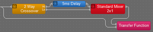

FIR seems like a whole lot of unnecessary processing (a 1kHz sampling rate would be more sensible for subwoofer frequencies than a 48kHz sampling rate, but no one makes hardware like that). The other thought is to do some split band and delay stuff with IIR filters. See the attached screengrab from a Biamp Tesira setup. Something like this... not saying this would work as is. It'd probably need to be more complicated than this. Tesira will show you phase, but it'd be easier to tweak settings for something like this if you could see group delay instead. Note you could get a $50 Biamp Nexia DSP from eBay and do this same sort of stuff with that.

What I showed in that Tesira screen grab attachment is a concept that should work. In my case, it's a typical ported sub. So there's a group delay peak of 20ish ms at tuning frequency of 25 Hz. I've added a subsonic filter as well that adds more delay (I'm debating if that filter is really necessary with recorded music). I can't speed up the output of the sub at 25 Hz, so the idea is you slow other frequencies down instead. With some DSP devices you can design your own signal path. What I showed there was taking the input signal into a 2-way crossover at say 30 Hz. Then I took the HF output through a delay block. 5ms is shown, but it could be more or less as needed. Then I summed the delayed HF with the (un-delayed) LF. This is over-simplistic for the point of showing the concept, but it effectively "speeds up" frequencies around 30 Hz. It would likely take more of these filters, delays, and mixer blocks cascaded. If I ever get this fully worked out and implemented, I'll share the details. I expect this would take a fair bit of trial and error and measurement.

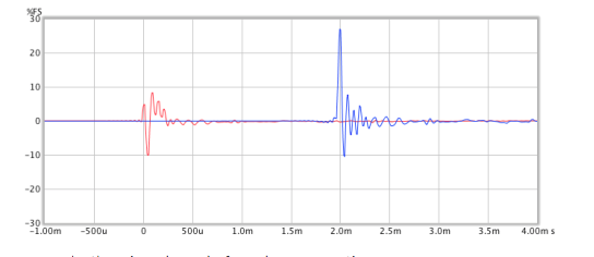

This page gives an example of how they do it with rephase .
Thanks for Rephase link.RobWells;5200828[URL="https://www.minidsp.com/applications/advanced-tools/rephase-fir-tool" said:This page[/URL] gives an example of how they do it with rephase .
Absolutely astonishing square waves! As a youth, I always thought sq-wave reproduction was the sine qua non of audio. Now I realize it is fairly meaningless* and that is because phase, as documented by a mic, is one of the great non-issues in music reproduction.
Looks like "group delay" has to be further separated between speaker mush (which the Rephase program addresses by fixing the crossovering) and driver group delay (a mechanical/acoustic issue) and "net" of at-your-seat sound (which packs driver, speaker, and room) and what I'm curious about fixing.

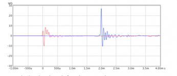

Interesting to see the dramatic effect of Rephase on pulses (see picture below). While the initial pulse (on left) is sure tightened up (by getting the bass and treble drivers to honk together, at least as far as a mic is concerned), the mush dribbling along after the initial pulse actually looks worse.
