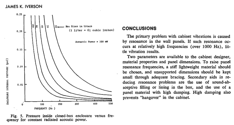

frugal-phile™
Joined 2001
MJL21193 said:
Dave, the inversely proportional thing sounds impressive. Can you please explain it to us who are not math majors?
A graph help? This graph is in units of pressure. It takes energy to excite a panel resonance. If the energy is not at the frequency of the panel rersonance it won't excite that resonance.

Re: Re: and???
planet10 said:
They have already been done. And experimental data to. The 1972 AES paper mentioned earlier is a good start.
dave
That's nothing more than the pressure in the box for constant radiated power for given box volumes. I don't see how that's relevant to your statement here:
"An analysis of the braced comparison -- remember the energy available to excite a resonance is inversly proportional to the SQUARE of the frequency".
That doesn't help the situation directly. As for being inversely proportional, it also indicates that it takes less box pressure to attain the same radiated power, so the fact that the box pressure for a given radiated power drops as frequency rises simply means that it will take less box pressure, hence less panel vibrational movement to attain the same output from a resonating panel. The only important point is that if the resonant frequencies are raised, they may be more easily damped, since most damping materials are more effective at higher frequencies.
If you have some other point of which we're unaware, I don't see it. Raising resonances above the passband of the driver/XO used isn't new, IIRC that was one of the points Gedlee (or someone in the thread) made early on.
Dave
