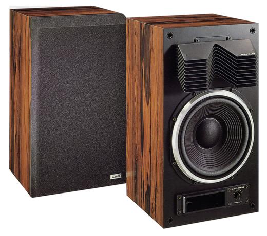

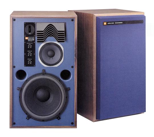

Maybe it's unfair to use the term "non-linearity" wrt to whizzers? Could give folks the wrong impression. Sure the frequency response tends to be a mess, but AFAIK there's no serious non-linearity (as in distortion).
Regarding the "brightness" problem that plagues many wide-range drivers - it seems to me there's two related "problems":
a) Too much treble on-axis.
b) Not much treble off-axis.
It seems to me that an acoustic lens, as used donkey's years ago on horns (and other tweeters) might help with both by widening the dispersion at high frequencies.
Not sure I'd want to try it myself, but if you're looking for something different...
Hmm... Can't find any images of the real oldies on Google, but the attached pics give an idea of the sort of thing I'm talking about (the slanted plates in front of the tweeters).
Cheers - Godfrey

Godfrey,
As usual, I'm a little out of my league when I apply technical terms. But, whizzer's response tends to be a mess due to the resonances, right? And, wouldn't those resonances would show up as a mess in a waterfall plot? If that ringing after the signal isn't officially "distortion" what is it? It's noise that ain't in the signal. I need to get some real measurement equipment. And again, I'd add that I think whizzers might still be better than many other alternatives.
Re: treble rise and dispersion: I think you can balance them to get a relatively flat in room response. For me, my speakers, which have a rise similar to the FE207E, end up just about right a little off axis in my room(s). More rise is too much for me, even well off axis where the response is more ragged. I do accept that other ears and other rooms might work differently.
I think wide dispersion is highly overrated (in a home audio setting, pro audio/live sound is completely different). I like to put box speakers near boundaries for aesthetic reasons and to help alleviate the need for BSC. If they had wide dispersion, it would reflect of the walls. In addition, it would reflect off room furnishings, etc. I don't want a padded room! I also like the ability to affect treble response by adjusting toe-in. For home audio with only a listener or two, I see no real downside to limited (I use the word controlled) dispersion.
