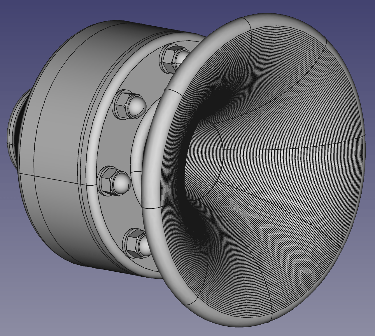

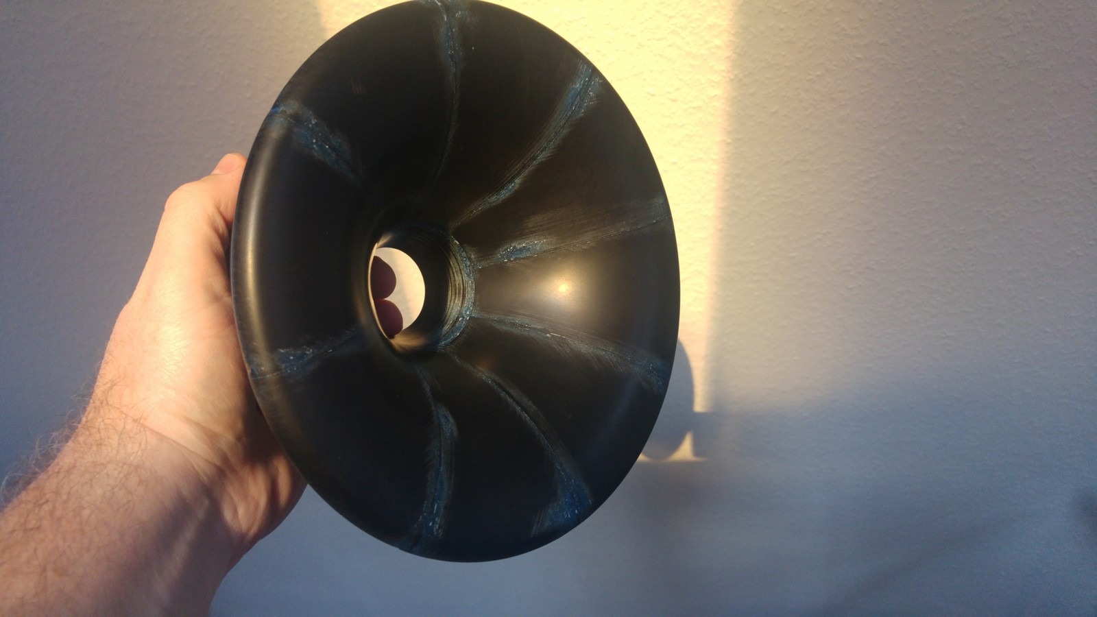

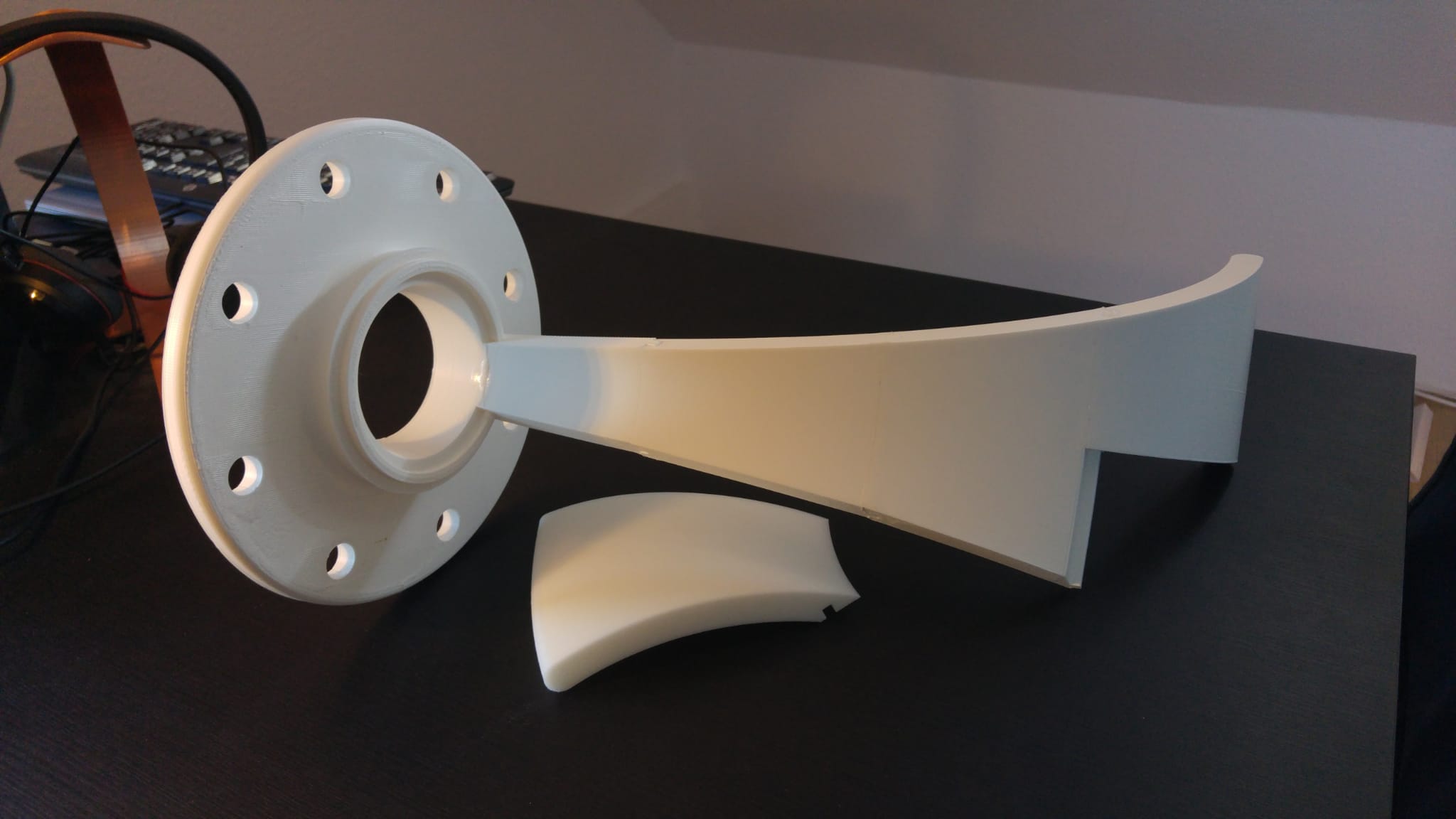

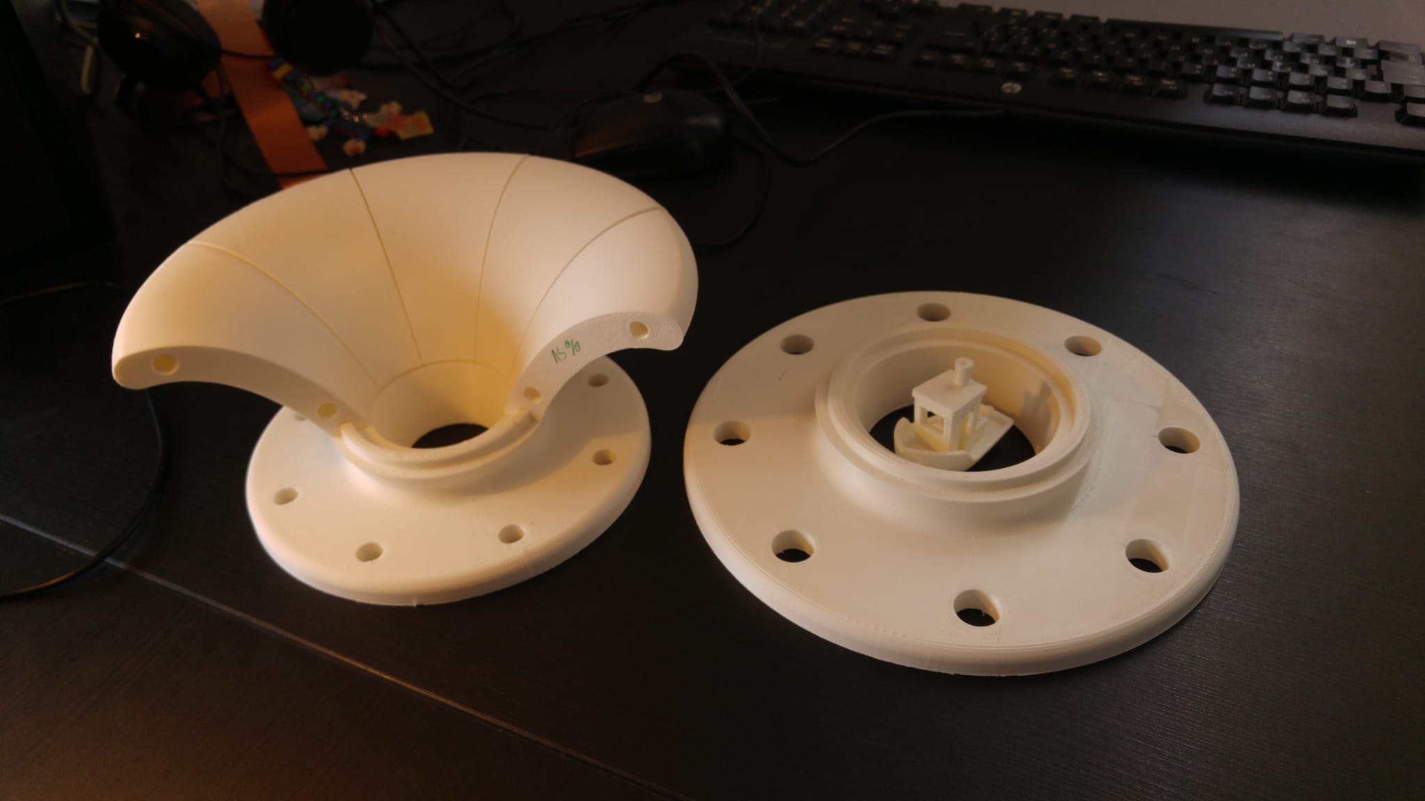

Of course I'm still interested in the project. To be honest, the progress was not as fast as I hoped. I’m not sure whether I mentioned that the primary goal is to build an active horn loudspeaker system similar to Avantgarde’s Trio series, which I first heard in 1994. This is a dream of myself which I have now for 30 years. Buying these is not an option (200k euro). I tested different options like wood and styrofoam, but nothing gave the optical results I wished. Using 3d printing now seems to be the way to go.
I'm now at the point that I feel comfortable with starting to print the 6 horns soon. This is not as easy as one may think. On the one side it means more than 1500 hours printing time using nearly 30kg ABS filament using a modified consumer 3d printer. On the other side a lot of mechanical work to fit everything together, sand and polish it has to be done. I attached some images to give an idea of the first promising parts. Please note that the horns will be 20cm, 60cm and nearly 100cm in diameter. Only the 20cm and 60cm variants are shown.
My intention was to start building the signal processing “device” as soon as the 4 smaller horns are ready. Going this way enables measurements starting from 750Hz. If these results are okay I’ll implement the largest horns because these are the most complicated ones.
Using Rasperries + Camilla DSP is the way to go, of course. Most likely using a XMOS based USB interface is the best way to implement it. It leaves the decision open to use 4x I2S directly for independent I2S input fully digital Amps or converting it back to 4x TOSLINK and giving these signals to common TOSLINK input Amps using a common remote control to adjust the volume for all channels at once.
But still my first question is not answered for me. When using different Raspis with TOSLINK (Digi+ I/O) input output HATs and feeding the same TOSLINK signal to all, will these individual signal processing lines produce output signals with small timing errors (< 5° at highest crossover frequency of about 2500Hz) measured from Raspi to Raspi?! According to my understanding this should be the case. Because there is not a random delay in the input / output path (this would be the case when using different USB output devices). Perhaps somebody can help me answering this question. Even if this seems quite complicated it would make optical connections to each horn feasible and keep “analog” lines very short. I’m somehow fascinated by this idea.
