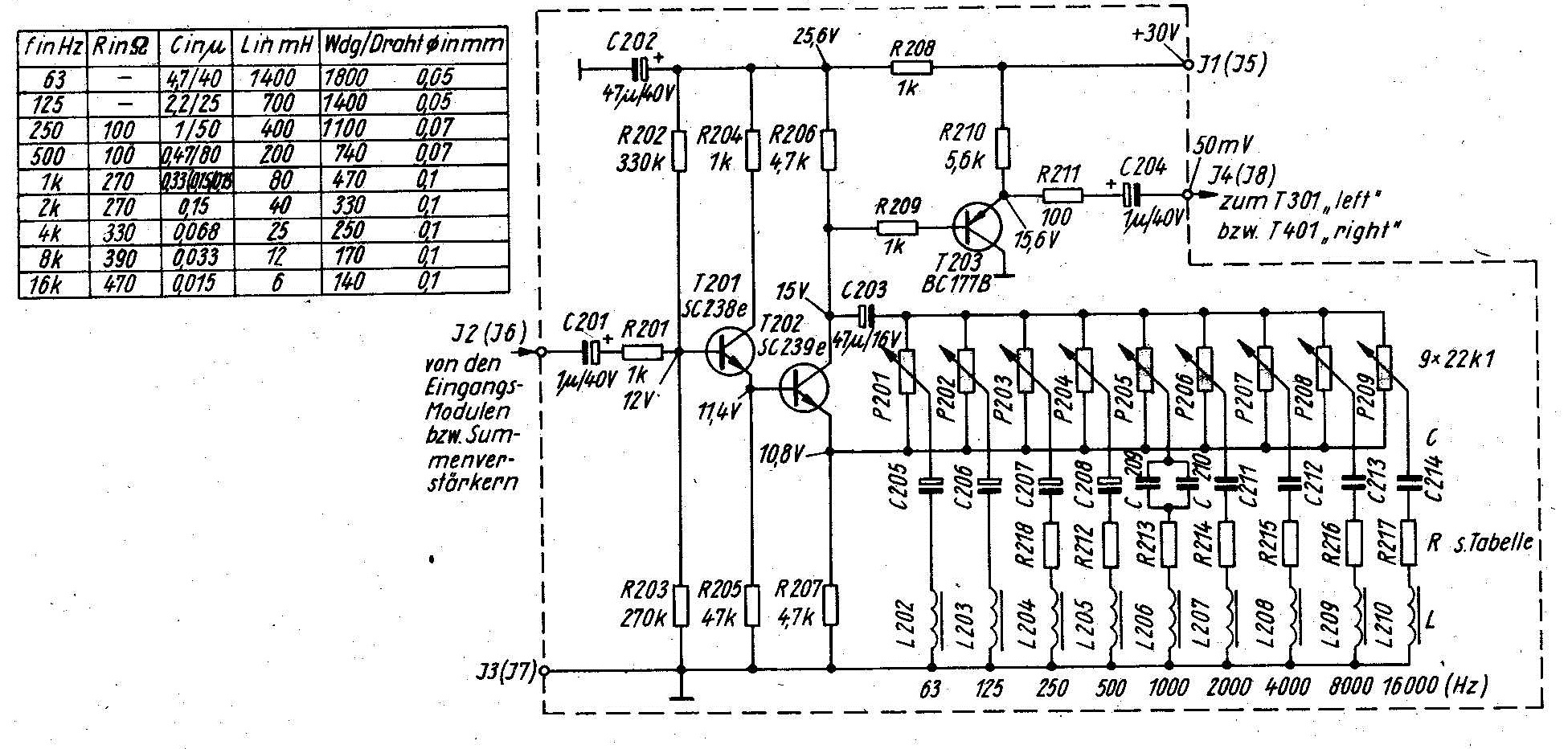

I do the room frequency response using REW and give me the filters to make the PEQ for DRC but I don't know how to make the discrete filter schematic. Attached filters needed. TIA.
