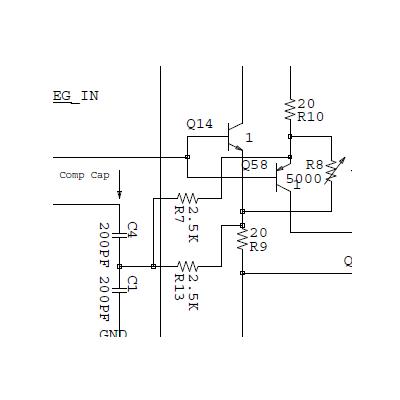

Granted I will match the BF862 jfets as carefully as I can but why can't there be a dc balance tweek up front around that diff amp. ! Ray
No penalty at all, you can make one of those 60 Ohm resistors trimmable (100 Ohm pot) and trim offset there. The easiest offset trim would be a large-ish pot across the two lower current mirror devices with the wiper to Vee. The pot is out of the signal path totally, in fact the other one would be too.
For amusement value both trims can be used together to trim offset to 0 and the Aol to essentially infinite.

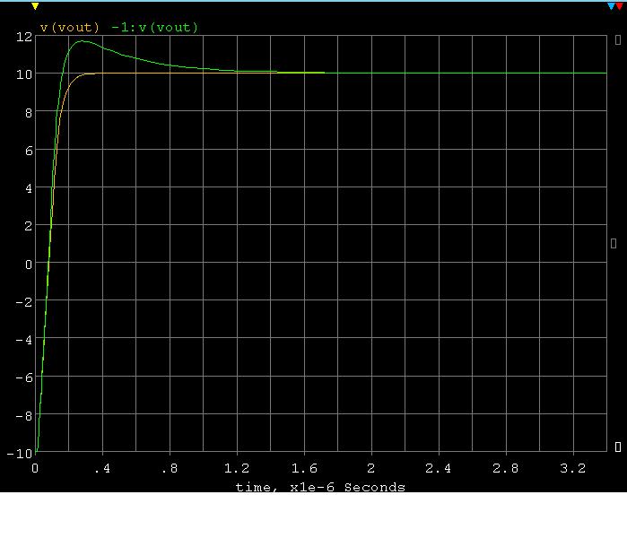

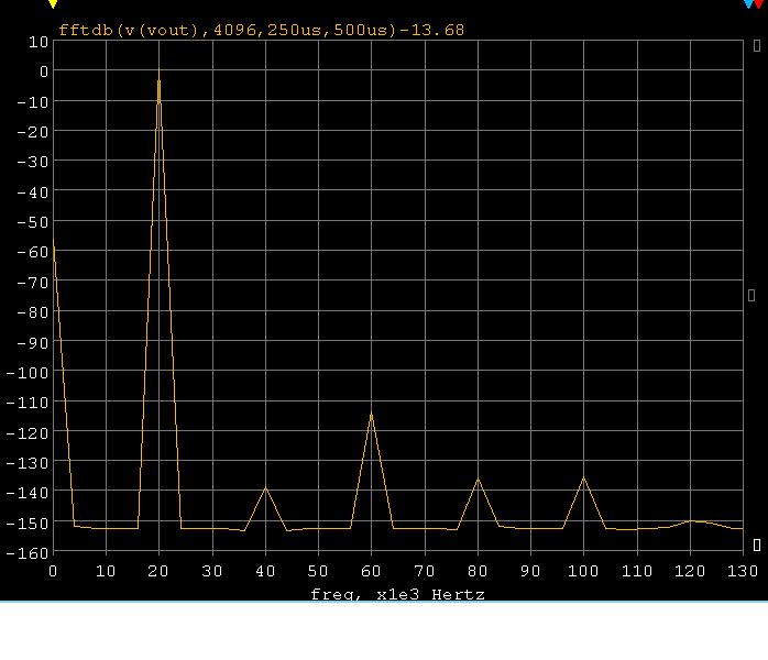

A quick look at jcx's idea. This is not definitive but what I see looks good. As stated before there is a long settling tail but for a line amp or preamp this should not matter. Seconds are now essentially gone, this is 600 Ohms at 20V p-p and 20kHz.

There's some interesting results when playing with how the offset is nulled. Going back to my extremely mismatched BF862s, I trimmed the DC by adjusting the source resistors, the predominating 2nd harmonic was worse by 3db compared to matched devices. So, in the sim I tried resetting these to the default 30R, and only adjusting the current source 60Rs to null output. Now, I get -94db 2nd, and -92db 3rd: nominally superior distortion figures, but of a different nature ...

Correction: I hadn't checked the quiescent output current, it varies as you null the DC out, via the input stage resistors. So both have to be trimmed, there is an interaction. The output stage was running too high a current, hence the better distortion figures -- once corrected, the 2nd and 3rd harmonic were both at -89dB. Meaning, very close to identical distortion with badly mismatched JFETs ...Now, I get -94db 2nd, and -92db 3rd: nominally superior distortion figures, but of a different nature ...
Frank
But, and a mighty big one, the offset is at the mercy of the BF862s. If perfectly matched, LTspice predicts an excellent DC null up to 75degC; above that temp the offset goes a-wandering; on the other hand, if using a severely mismatched pair, with gain of 100, the offset varies between -2.4V and 2.4V in the range 7deg to 47deg (default is 27deg)!
