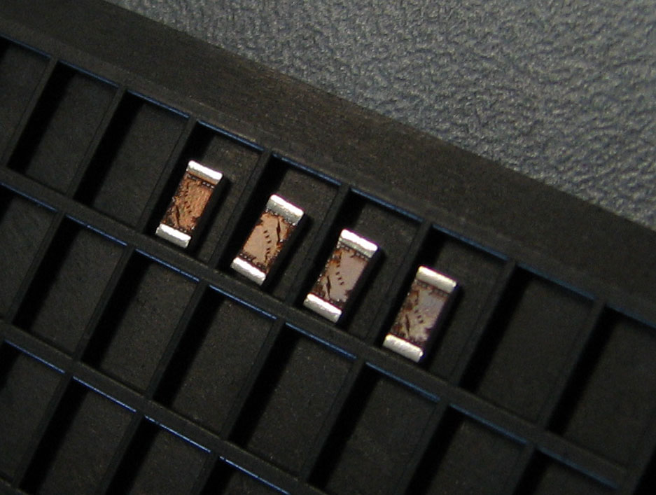

Texas COmponents´Zfoil ASM / ASMP resistors are available from 0805 size to 2512 size. 0805 is possible to solder even with my eye sight 😉
(OK, I use enlargement glasses)
I will stick with the 0805 ASM/ASMP resistors.

Shanghai ham, but DIY. I'm surprised you have not seen the LNL report on SMT resistors? There are several exellent choices. Texas Components is part of the Vishay group, their foil SMD resistors have excellent specs.

yep part of vishay, so much cheaper though, I was really blown away when I went to buy some at digikey one time as I couldnt wait the 2 weeks for custom production. for an equivalent zfoil VPG part from digikey you pay about $40-50USD for standard values in 0.01%; for what you will get in exactly the custom value you want from Texas components in 0.02% for ~$10-12....
you can start to pay up around the $50 mark if you want them to do global value and relative matching in quads or something. global match at 0.02% is fine for me unless i'm going a bit silly, given what you get is usually better than that anyway.
as a bonus you get them with the clear conformal coating so you can see the foil 😀

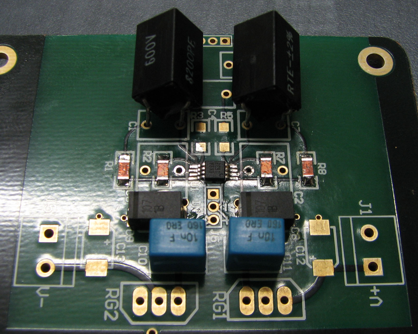

you wouldnt happen to know of any matching quality SMD caps would you Scott? as you can see the RTE polystyrenes are somewhat disproportionate for this filter. theyre over on their side because this id for a portable headphone amp/IV i've been using.
I ended up changing to some copper foil/pps because they were smaller, but i'de love something in SMD

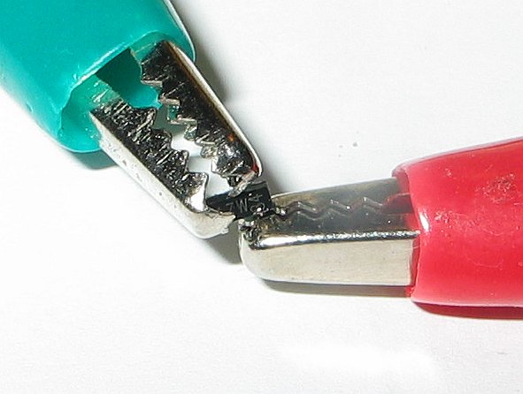

Where can a sot23 socket be had for matching. I've never seen one. Also just applying pressure to the device on a sot foil platform is rather tedious is it not for checking Idss. What if your hand slips and static charge destroys the device??? Don't you have to wait for the device to stabalize a half minute or so?? Thanks, Ray
I found this on the web. Looks like a good rig for matching SOT23 devices or something like it. Maybe it would apply pressure without one's shakky fingers??? Ray PIC SOT23 test socket programming adapter PIC10F
matching anything is tedious, no way around that. I wouldnt think it would be that bad, i'll let you know =) no I wouldnt think you would need to keep it there long to stabilize, given the size of the device/die I couldnt see it taking long to get up to temp

You guys are complicating too much about matching rig for BF862 and other SOT23 devices. 2 crocodile clips will do the job. One clip across G and S and other clip on D. Example is bellow.
looks like more of a pain than pressing it down onto some pads, it would also seem to add unwanted thermal mass. It has the bonus of not having to hold them there though; well if you trust them and the attached cables not to snap little legs off if left to their own ..erm....devices (sorry).
though as bcarso mentioned for this part it has close to zero tempco @ idss, that may not be a big deal, at least for the bf862. think i'll stick to something like Scotts method, i'm sure with some thought some sort of mechanism could be found, but I dont thin I could be bothered at this stage.

Crappy day outside, so I gave it a shot and have a schematic a preliminary parts placement. 0805 passives and top-sided only placement, at this point.Retained original ref des, to make it easy to follow. The schematic DOA-SW01.SchDoc has an error Q17 Emitters are tied to the "Out" net.
