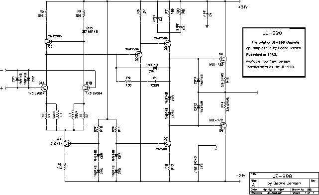

Number two (from post 68) is not too bad. Whose is it? It looks like something that really works.
What?!?! you didn't see the "Je-990" on that one? I assume you mean this one in the middle?
My bad. The one in the middle from post 70, with the dual JFET front end. I like that one.

All I got so far is that it is very old. (1973?)

JE990

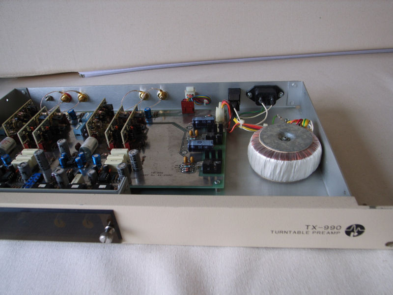

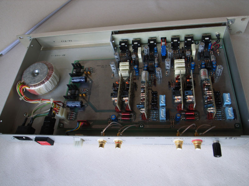

One of the 990's best characteristics was it's stability into (relatively) difficult loads. It was designed by Deane (RIP) to drive his transformers (albeit he recommended output isolators) so it had to be stable. The 990 was quiet enough to make a high-end MM RIAA preamp in 1988, as executed in the PR&E (Pacific Recorders & Engineering) TX990, still a great-performing pre (see attached pix)

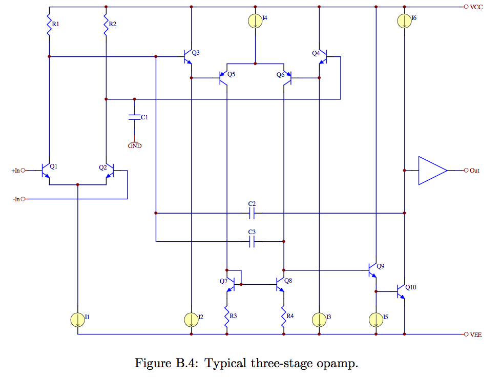

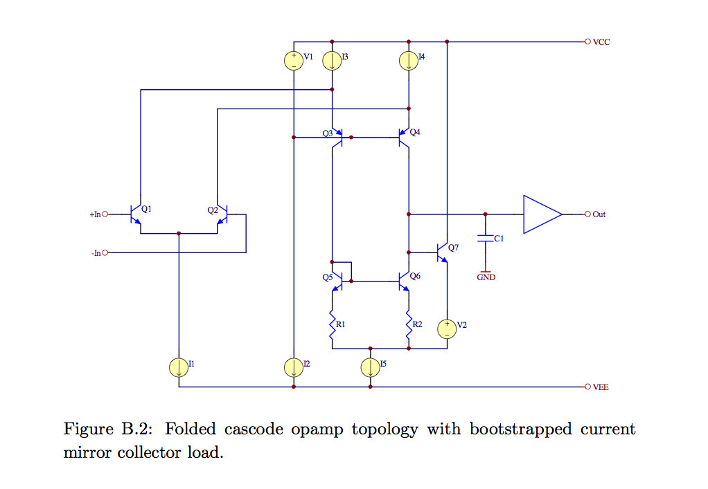

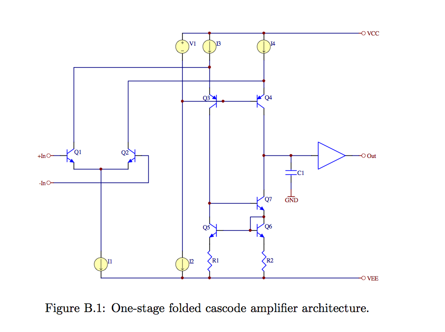

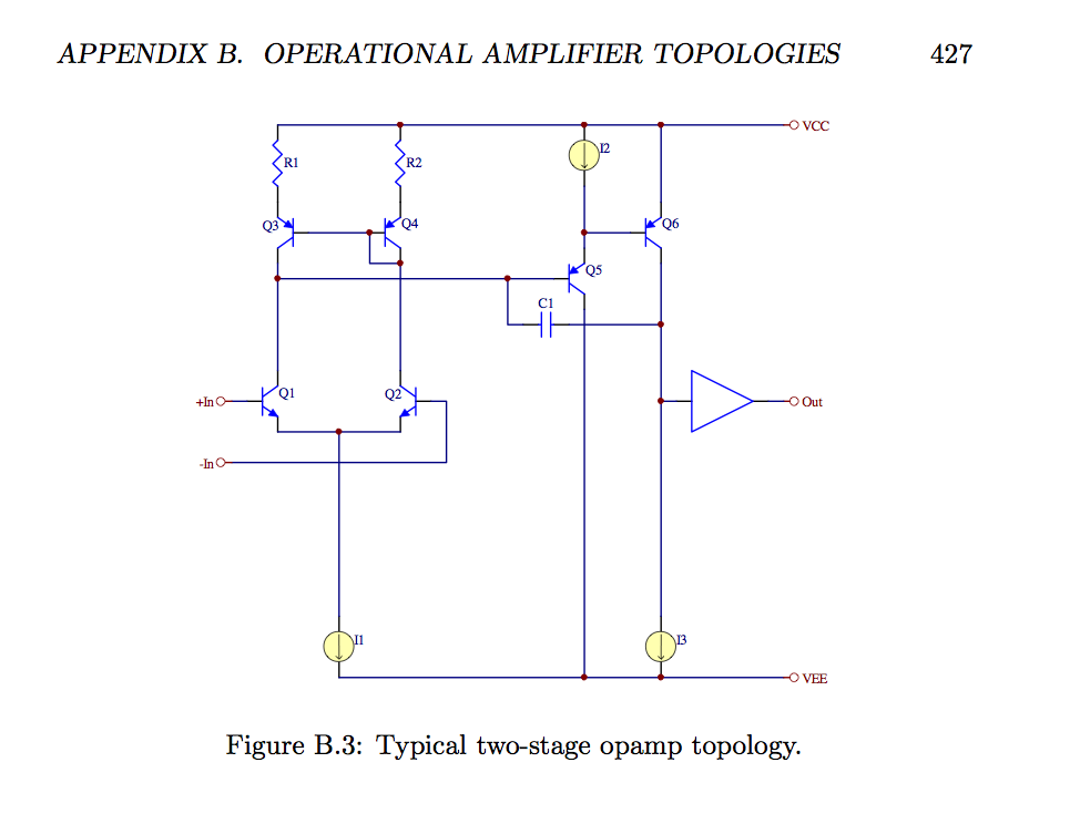

Samuel Groner has shown the most popular topologies for Opamps.
....but did not include in his analysis important one that's been around for ages as discrete design.

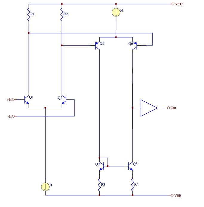

Past standard circuit
I used that topology for a passively equalized phono stage (with fet input) - TAA 3/80. Good basic circuit.
That's (post 94 schematic) also close to what Rich May did as power amplifiers in the Harman/Kardon TC400, although he inserted a common-base stage in the one second stage collector to equalize the dissipations of the second diff pair. He also compensated with a series RC network across the input collectors, and had some emitter degen in both diff pairs iirc. The resulting design had o.k. static distortion performance, and very good and symmetrical slew rate. The output buffer was I think cascaded common-collectors with the fast Toshiba output devices (2SA1302? etc).
