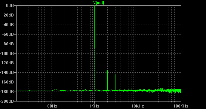

Here is what I've got simulating Scott's design @ 1kHz, 0dBV into 30 ohm (12 dB gain, medium power output bjts running @ about 50 mA Iq - J113s in the front end - didn't have at hand BFs models - real 2 bjts CCSs in place of I1, I2). Impressive 🙂

Impressive results in SIM -
That IS impressive results from SIM. Let's build that one !! See if we can make one perform close to the SIM model. Congrates to Scott. Thx -Richard Marsh
Interesting. Although the harmonic structure is pretty clearly mostly 2nd with a little 3rd, how many harmonics are accounted for in the later plots?
Does your simulator have an option for log scaling?

Usually I'm using 10 or 20 harmonics, in this case I'm using 10.
No problem with log scaling, what would you like to see?
BTW: it takes more than an hour or two to run a trustworthy
simulation.

Later meaning later plots in your list, such as THD+N vs Vout.
An hour or two? Good grief! What simulator, what computer? My fairly old circuitmaker screams along compared to that, although I have many procedures I resort to for cross-checking the results, as I think I described a while back.

😱 5 or 10 sec here to get ~-300dB or so math noise error floor. I have never gotten PSPICE to do just that, we have a mode to force a transient analysis to behave as an ideal jitter free A/D.
We need to pick an output stage and bias it for max load wanted, if I read Dick's schematic correctly the output devices are several tens of mA quiescient.

I said trustworthy.
BTW: my computer and simulator is extremely fast. If you believe that a trustworthy simulation takes a second or two, that is you problem. I've seen enough of such nonsense, be realistic. 😉
agree with Scott: lets pick an ops.
