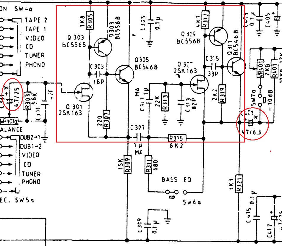

Today got a new pre-amp and that always makes me highly interested in what exactly I have but knowledge is almost non existant I'm afraid. Still I hope it would be ok for me to post this here since this thread seems a good way to see if I 'get' some of the stuff discussed. (perhaps some credit for going through the whole thread? 😉)
If this is not wanted and/or to OT just ignore please.
Anyway, attached a sniped of the pre-amp I acquired today (chuffed 🙂) and some questions.
a. The part in the red square is the discrete opamp (?)
b. The circeled parts are the DC coupling caps you all are wanting to avoid (?) (and thus this design would not fall in the wanted design category)
c. This must mean some sort of DC servo feedback stuff talked about a couple of pages back is non existant and the follow up question would be...
d. Why would the designer chooses for the DC coupling caps (quit a few in the whole design) is cost the only reason or are there more benefits of this design?
e. anything else you like to share, love to learn more!

The JFET and two bipolars are a very high input impedance unity gain buffer that probably works pretty well, but is necessarily single ended and needs AC coupling. The high impedances allow smaller caps and larger resistors to be used so at least they don't have to be big electrolytics everywhere.
