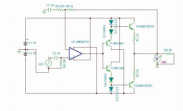

Good Morning everyone. Another day, another schematic. :hphones:
Hope everyone has a nice day.
