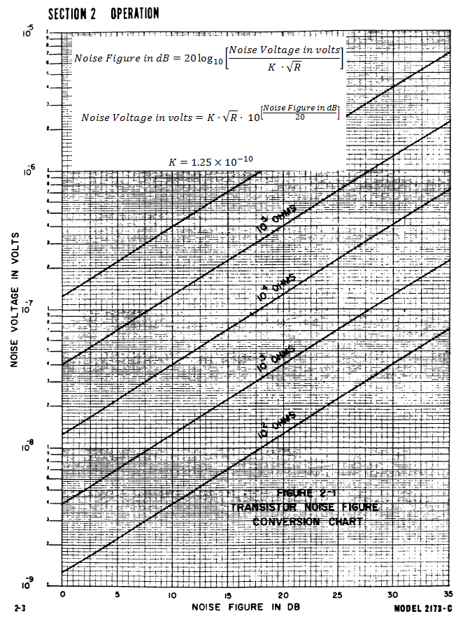

I'll post a scan of the later version Quantech this evening. The opamp variation is simple by comparison. Need PC software w/ noise analysis to make it useful. Maybe a subset of hpw?

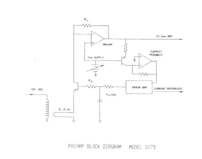

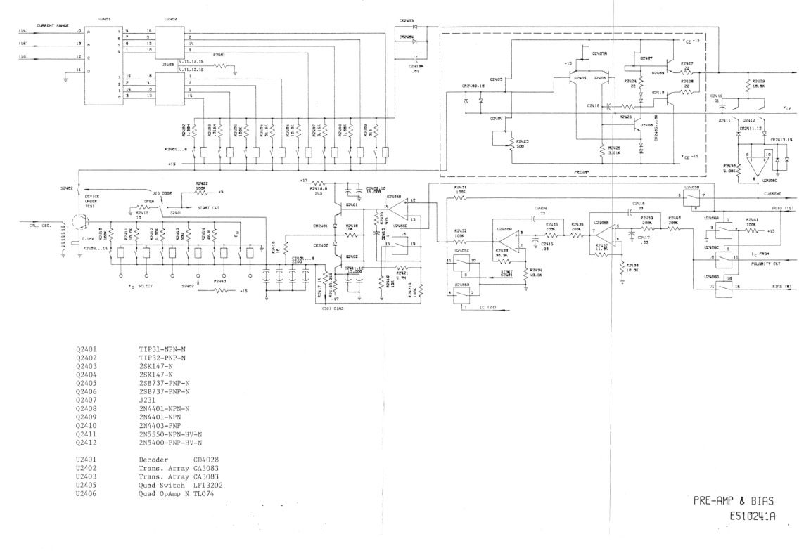

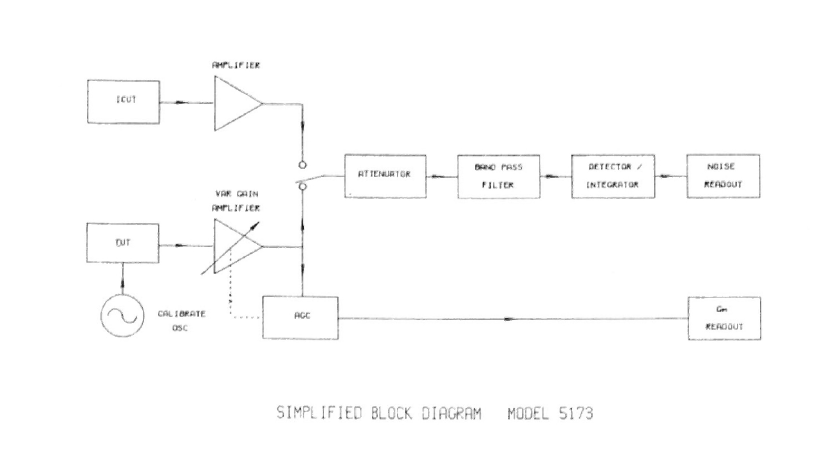

A little behind schedule but here is a block diagram of the 5173, the preamp section and just the first page of the preamp circuit. Somewhat like a curve tracer there are a lot of interacting pieces to make one of these. Mine was hijacked into Constellation production and I have not been able to get it back yet. Finding another is quite difficult.
It may be easier to limit the options some and make it more manual. I have the schematics for the older 2173 but I need to scan those as well.

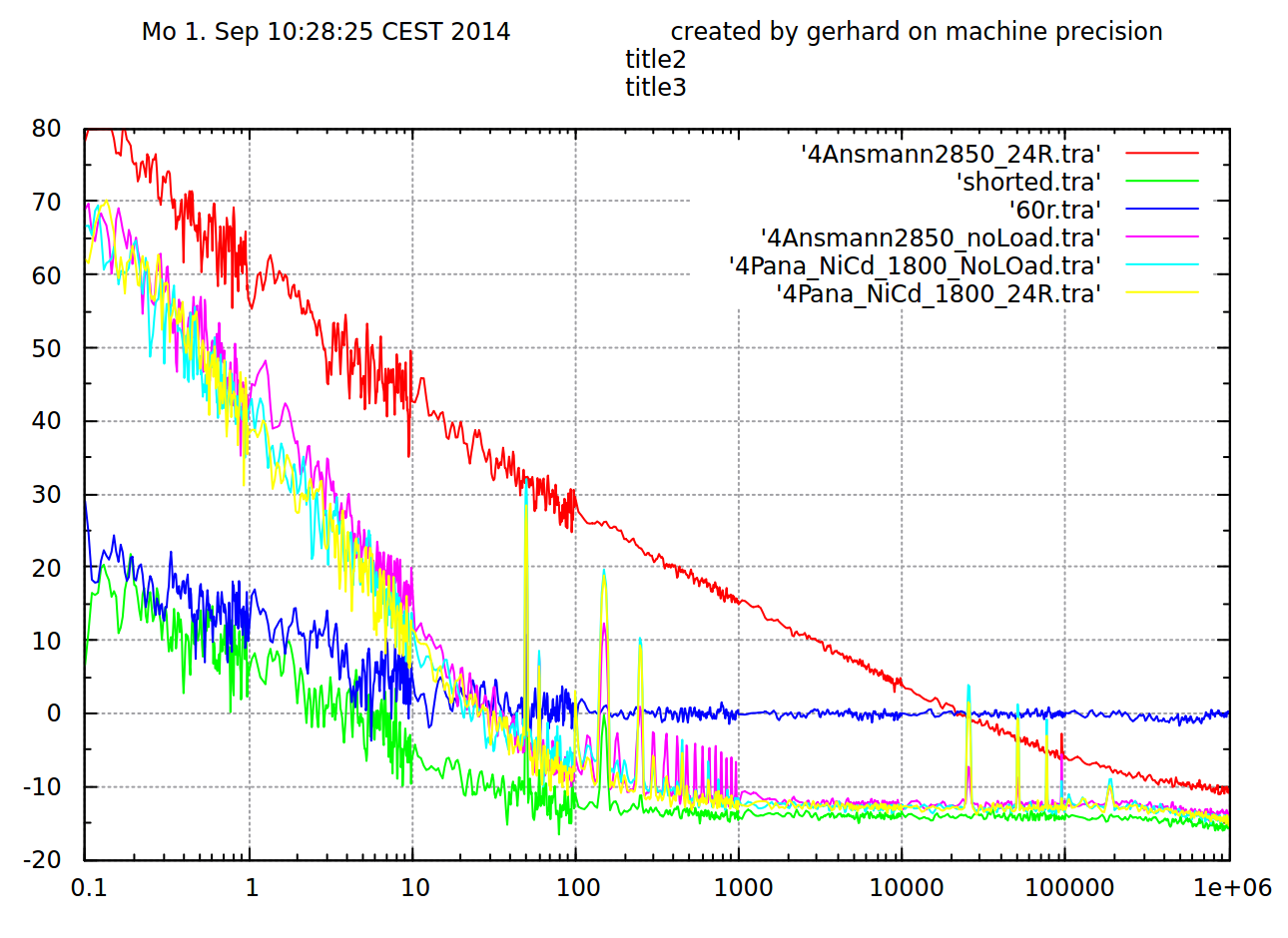

Over the weekend I have made some progress on automating my Agilent 89441A,
the preamp, gnuplot and the control program on Linux Mint. I had allocated some buffers
locally in procedures and got stack overflows, resulted in really wierd and unpredictable
behaviour.... That much for 16 Gig physical RAM and unlimited swap space. :-(
I could make a few measurements on noise density of some batteries:
Ansmann NiMH 2850 mAh AA size with no load and 2*47R wire wound
Panasonic/Sanyo NiCd 1800 mAh C size with no load and 2*47R
Bottom traces are the own voltage noise of the preamp ( 10 pairs of ADA4898-2 in par.)
The dark blue line is the voltage noise of 60R thin film, i.e 1nV/sqrt Hz taken
as reference -> 0dB relative.
It's interesting that the NiMH gets that noisy under load, should be abt. 200mA DC.
There are still some effects that need to be considered, for example the noise below
100 Hz seems to be somehow different and the spurious I get varies too much for my taste.
I need a lot of gain to swamp the 1/f noise of the FFT analyzer.
