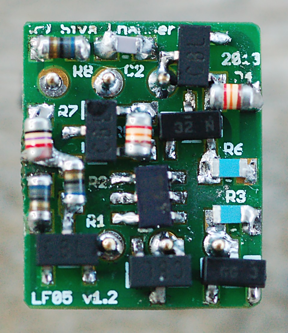

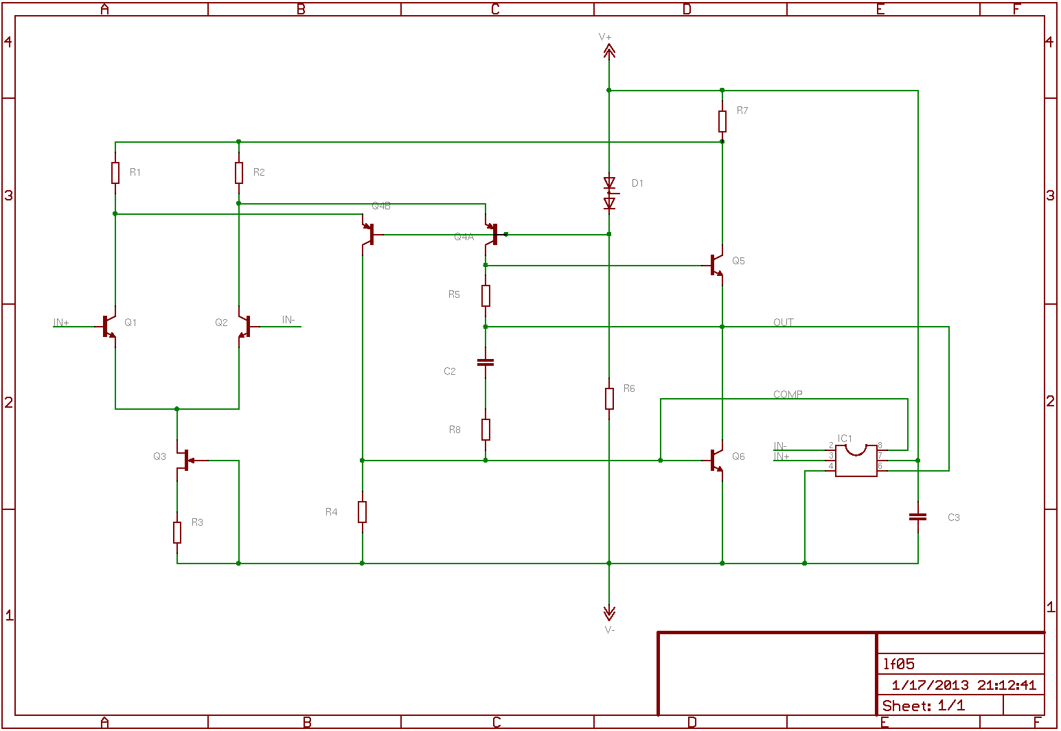

It's within reach, and the discrete-opamp topology (Kaneda-like topology with folded PNP cascode) shown below probably gets close to the voltage noise requirement and surpasses the THD requirement - ~-90dBr 2nd harmonic as a unity-gain buffer at 1Vrms, THD20. It doesn't have performance specs that are comparable to some of the other high-performance discretes in this thread, but it uses Class-A biasing, which helps it sound very detailed and non-fatiguing in typical line-level or lower applications.
The prototype shown uses Toshiba 2sc3324-BL for all NPNs, and micro-MELFs at all key locations in the signal path (a couple of constant-current bias resistors are thick-film SMD).
I've never tried it as a microphone preamp, but if you can tolerate an input bias current of about 2.5 uA (LTP tail current is ~ 2 mA, LTP DC beta about 400 each), it should work OK as a preamp at rails as low as +/- 3V (the sweet spot is about +/- 9..15V, and max rail voltage is about +/- 20V). There's also a fair amount of input DC offset in this topology due to mismatched LTP Icq. GBW runs to about 10 MHz in the prototype, which can be raised to 20..30 MHz if there's no requirement for unity-gain stability.
