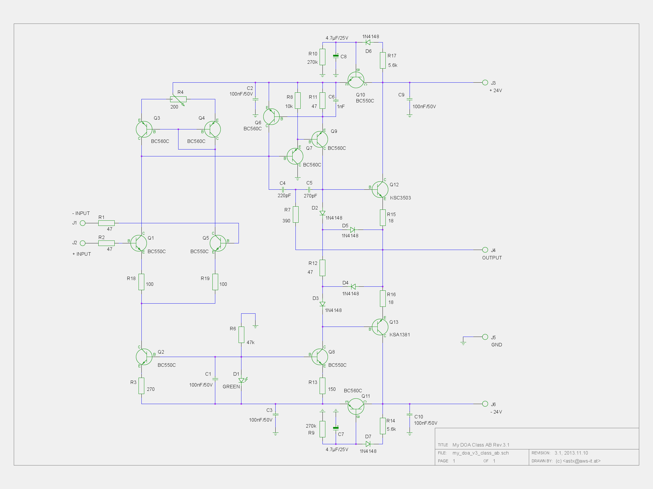

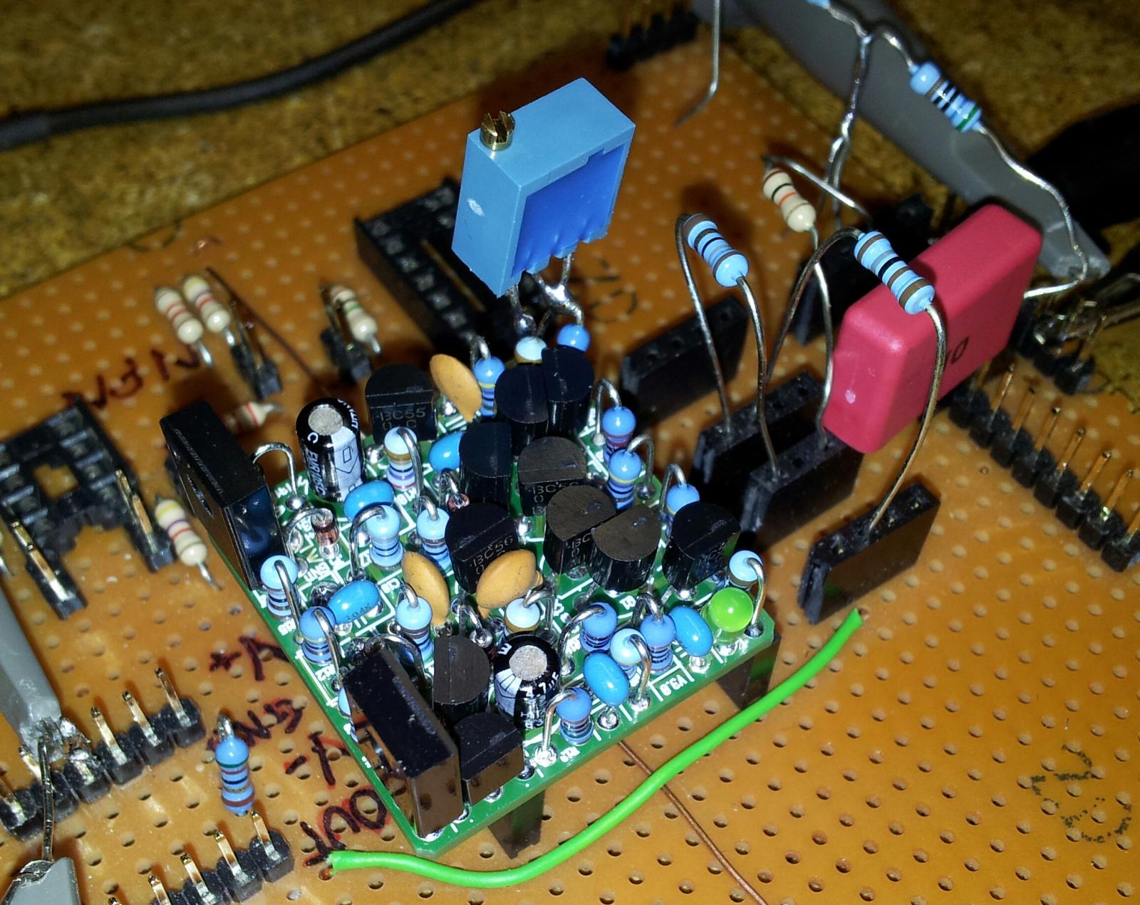

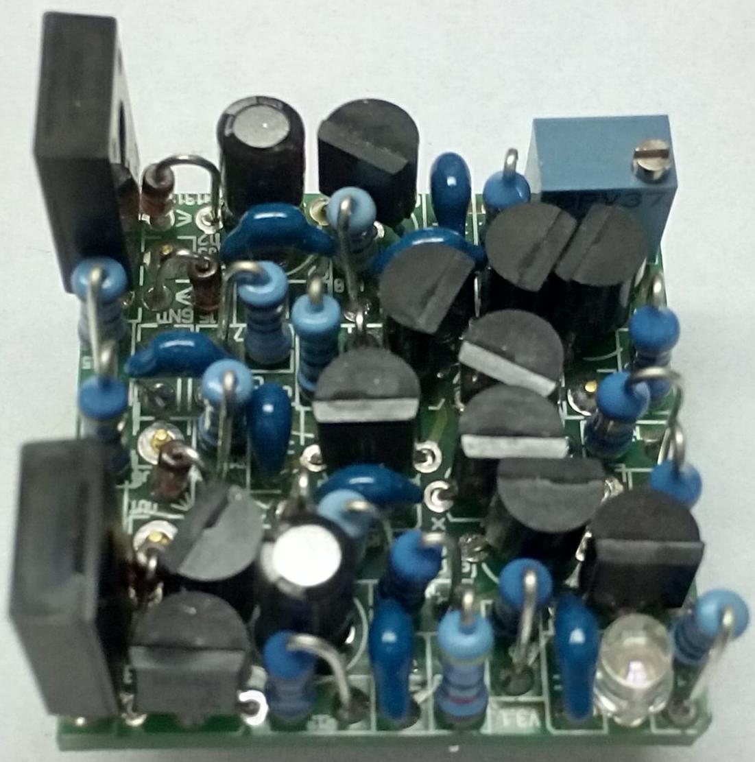

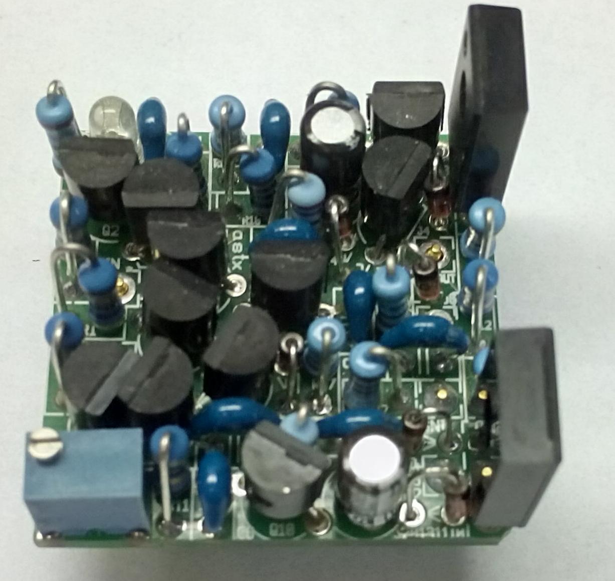

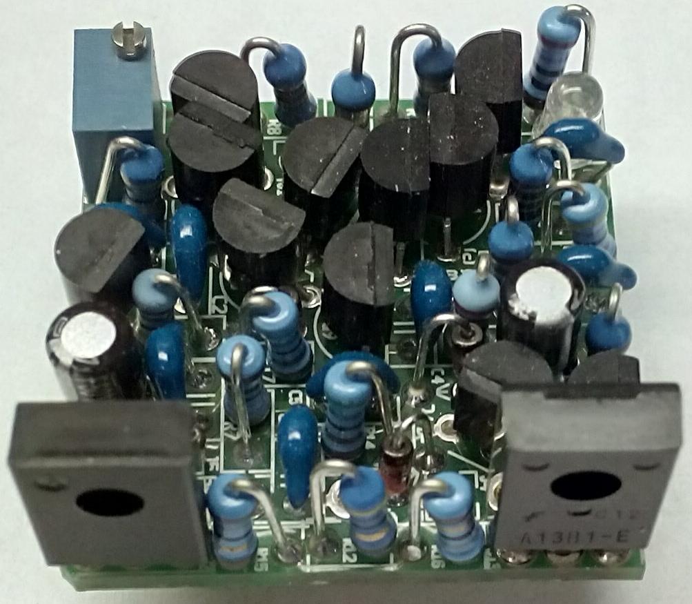

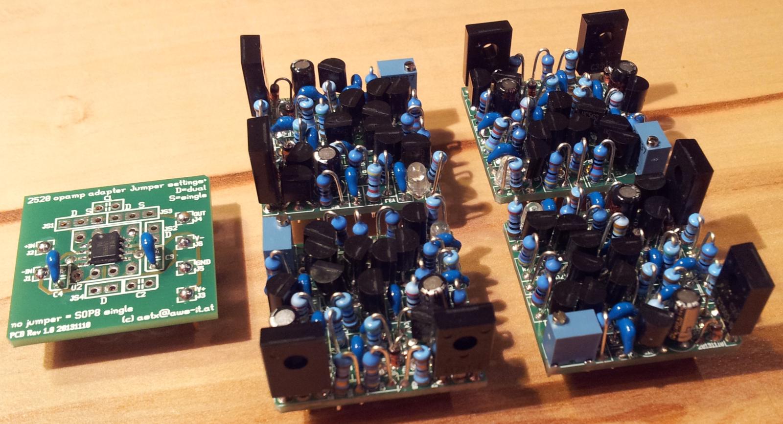

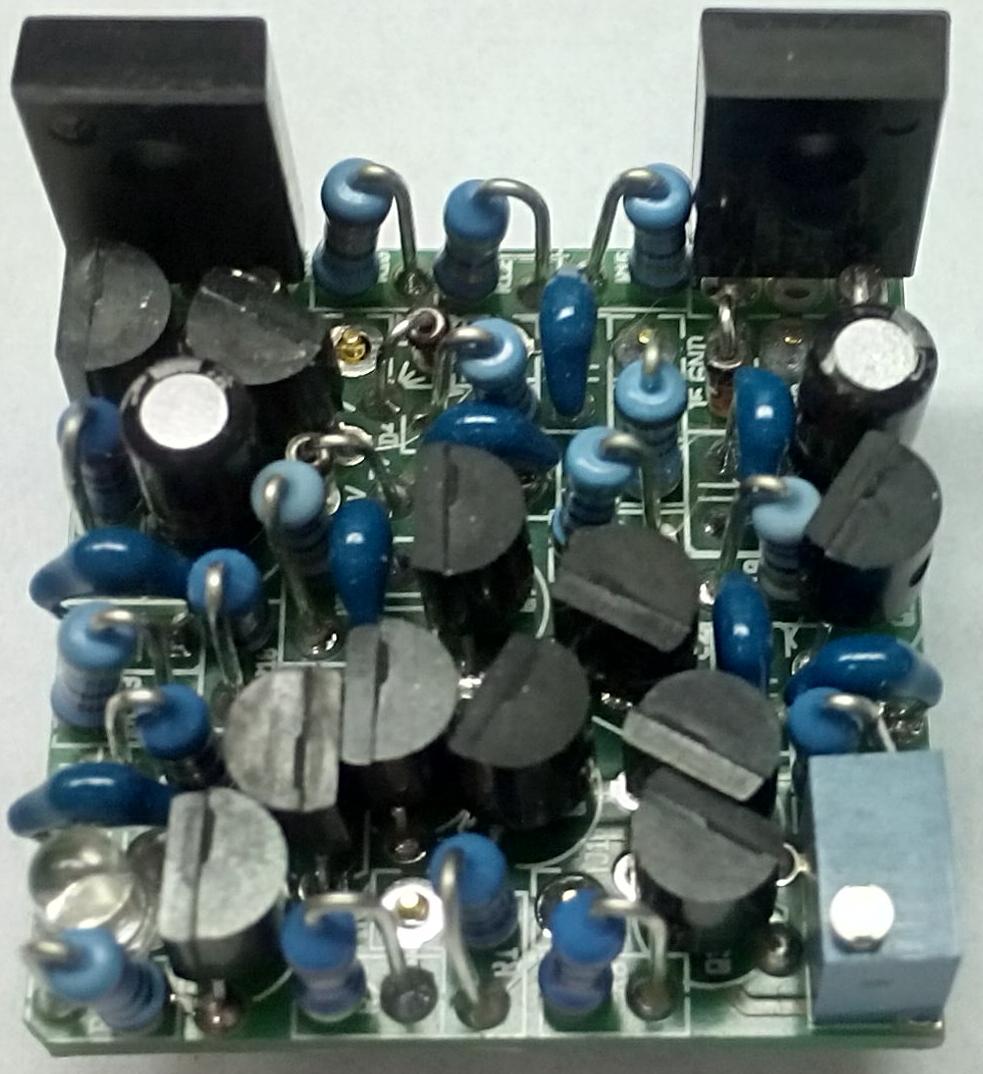

Another discrete opamp with high performance - unity gain stable. Through hole parts only.

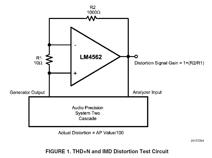

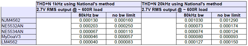

MyDoa v3.1 (schematic) and some 20kHz distortion residual measurements compared to LM4562 and NE5532.
BR, Toni
Thanks - at first glance, it looks like a Blameless/JE990 derivative. The output stage looks like a Self Type I/II hybrid - will take a detailed look in LTspice in due course.
I would separate the biasing for the LTP and VAS CCSes - maybe just superstition, but I use separate JFETs for each CCS in my (SMD) FET990 derivative.
Would call it a "mini blameless" with added capacitance multipliers to increase the PSRR: my teachers are (the books of) D. Self and Bob Cordell and of course many users of the DIY community. 🙂
Separate CCS biasing hasn't shown any difference in simulation so I decided to keep it simple.
Spice files can be found in my amplifier thread - see link above.
Have fun, Toni

Would call it a "mini blameless" with added capacitance multipliers to increase the PSRR...

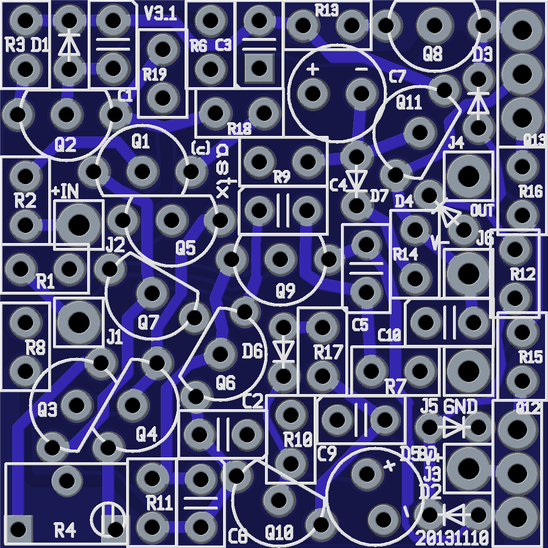

Purely a parts-selection recommendation: C7 and C8 in the capacitance multiplier could be Black Gate PK, or even better - Wima MKS2XL in 5mm pitch.
I noticed that it requires a ground pin, so it can't be DIP8 single compatible unless one of pins 1, 5 or 8 are re-purposed as ground, or a 9th pin is used. Of course, API2520 pinout is just fine.
Of course one can use other capacitors...😉
I have used electrolytics of good quality and they are cheap too. Wima with 5mm pitch would be too big for current layout. See attached pcb picture.

Yes - and removed it due to part count. Maybe I should retry with 3 transistor CM using "national measurements method". During design phase I haven't used this measurement method...

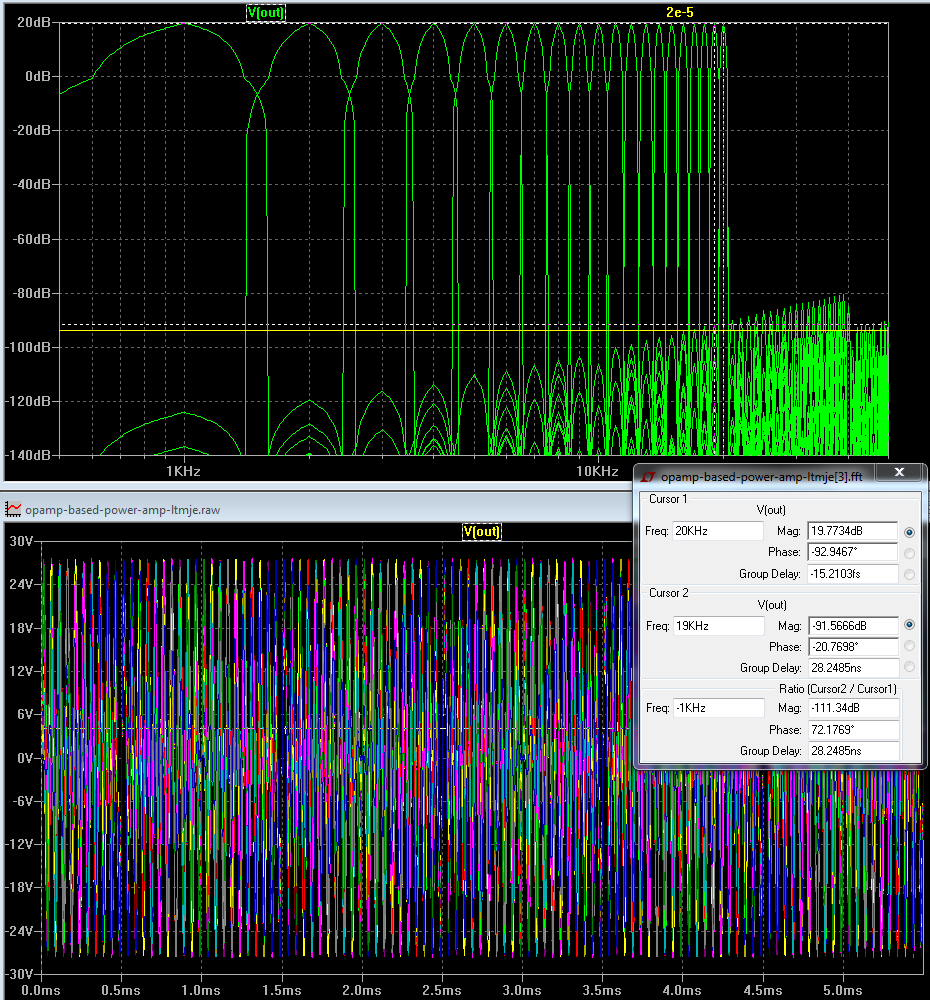

I use 2-tone in sim quite often, with a modern PC, LTspice it really isn't a problem to do with fine enough time step, long enough # of periods
looking at the .tran distortion sim a interesting test is to use 2 sine inputs in series, 1:1 level of 600mV each to give near full output, fix one at 20 KHz, step the other from 1k to 19k in 1 kHz steps - the critical measure of quality is the IMD products below 20 kHz - also has the harmonic distortions of the lower tone
when this stepped 2-tone is done you can plot the combined fft, see just how "bad" the "rising distortion with frequency" is (not)
the yellow line is ~ -120 dB re the peak of the combined 2 tones
you can see all audio frequency harmonics of the 1-19 kHz stepped frequency tones and the IMD difference products of all orders with the 20 kHz constant tone
all audio frequency distortions just barely breaks above -120 dB below the combined 2 tone peak amplitude in the 18, 19 kHz bins - with the original op amp
the level of all of the audio band distortions are all inaudible - below human hearing threshold in quiet if the speaker were giving 120 dB SPL with the amp's full output
with higher loop gain op amp you can keep every audio frequency distortion product below -120 dB in the sim
