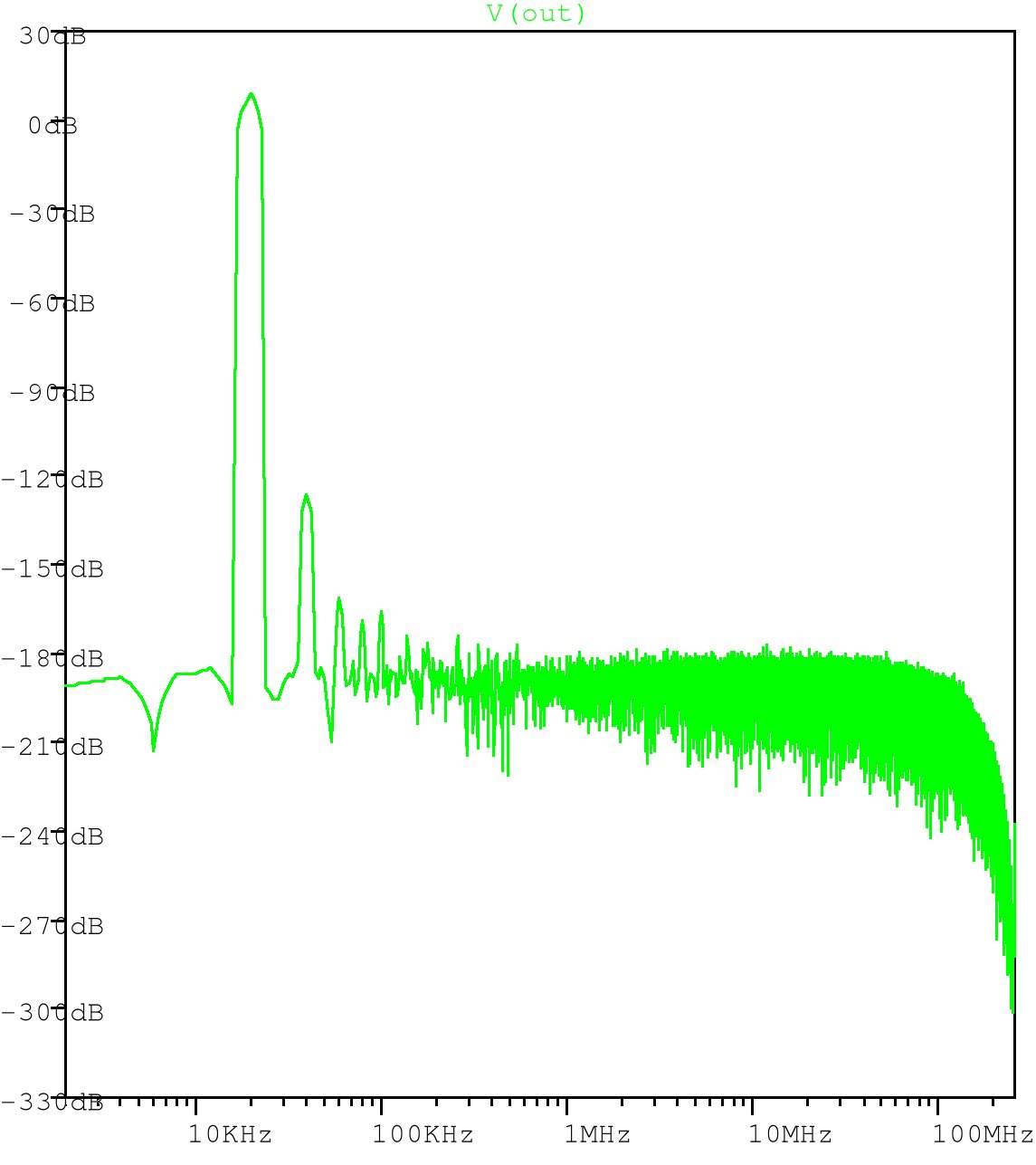

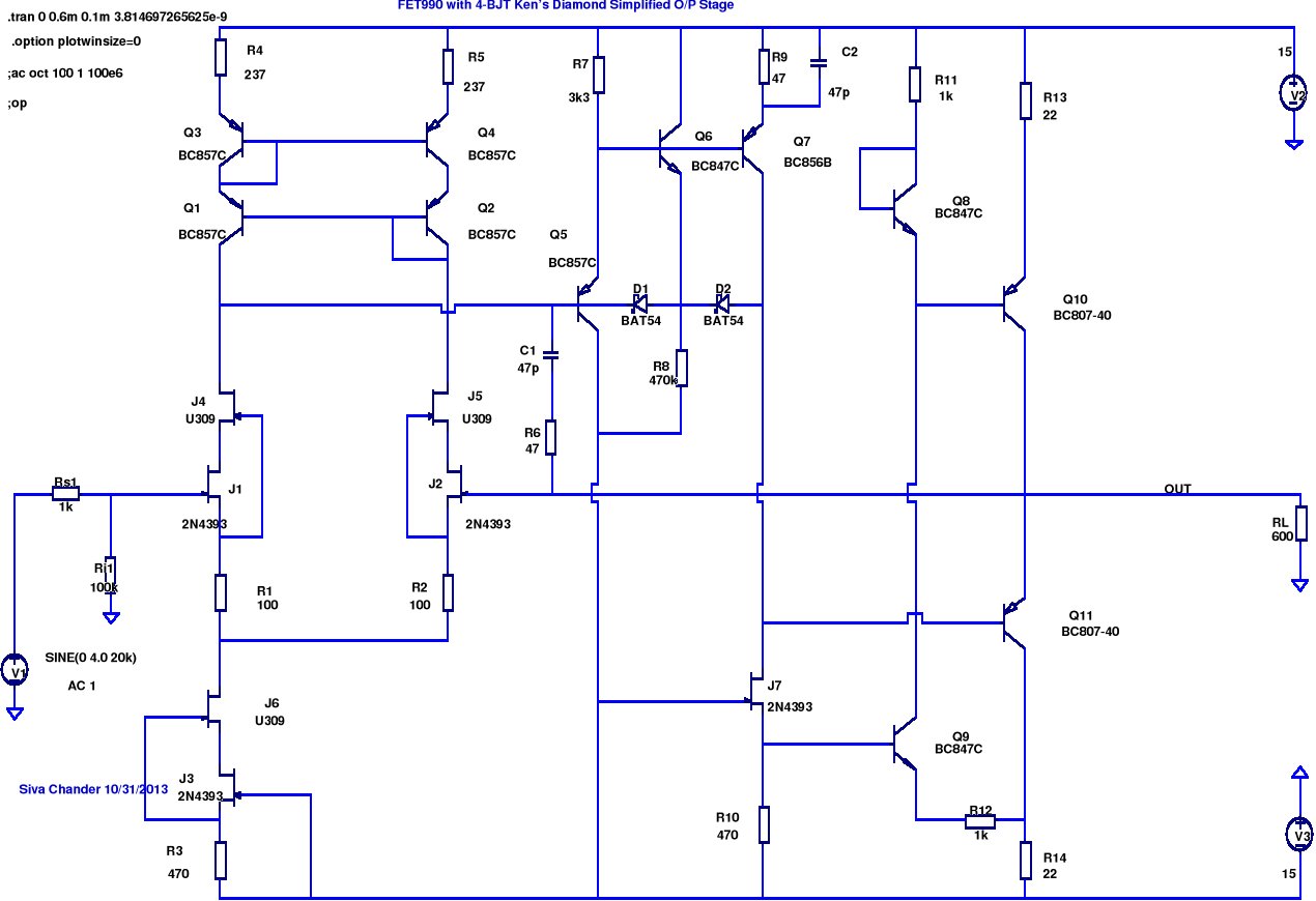

This is a simulation schematic of a simplified 4-BJT Ken's Diamond as the output stage - it's derived from the 6-BJT Ken's Diamond, but the CFPs at the output have been reduced to single BJTs, thus reducing the BJTs in the output stage to 4. The voltage reference has also been opportunistically obtained from the VAS CCS without any additional device.
It seems to simulate with a few dB lower H3 than the Diamond Cascode at similar output stage bias of around 8 mA. It still needs further analysis of stability, phase margin, overdrive and clipping behaviour, PSRR, etc., but it looks to be a viable contender for a Class-A output stage for the FET990.
