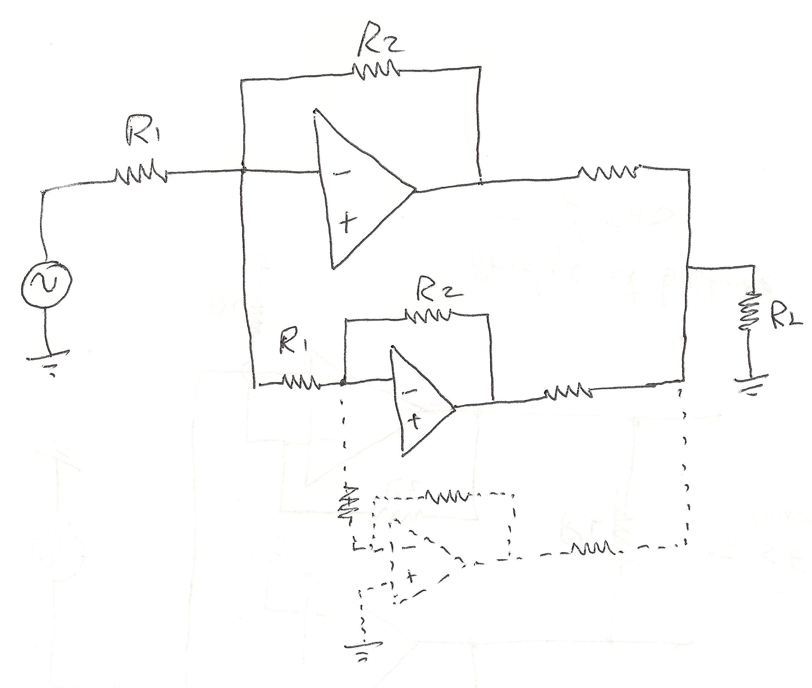

Hi Scott,
The information Ive seen showed improvement for extremely low distortion levels, like around -100db.
Takes the falling fb/response/phase shift associated with it out of the picture -->
(A.Sandman)
(A.Sandman)
What does that have to do with cap load drive? Put some practical numbers up there for say an RL of 600 Ohms and net gain of 20dB. An amusing conceptual circuit but not practical in many cases. Do a noise analysis for instance, or if the summing resistances are much less than RL you get all the distortion back by shoving most of your current into the correction amp.
...cap feed back to output to lower distortion... just caught me funny and I had this zanny idea - image- that it was summing and canceling distortion but another opamp in place of a cap would be more complete... thus A.Sandman's circuit. Sorry, its just the way I think sometimes. Its like a flat rock skipping across the surface of water... one point of contact quickly leads to another and who knows where it will end.
BTW- the circuit was published in Wireless World and taken to a working circuit level... into 8 Ohms. Feb 1974. It has its applications and ought be perfected (in IC's?). Or in discrete?
Oh, never mind.... carry on....
As a unity gain inverter (does not work at all in follower mode) and an inverter with gain again presents a low impedance to drive, so the usefulness?
