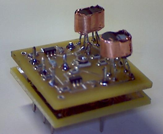

Little slow right now since I seem to have a touch of the flu but I got the output board through the reflow and all seems well, bias trimmed right up and hope to repeat the open-loop performance verification.
Here’s my final breadboard with the output on top and input on the bottom, ground planes facing each other. I used standard square Vector header pins to both connect the appropriate circuit points and feed the output pins out the bottom. I fired up the output, this time I used 2N4401/4403’s only for the diamond and Panasonic DMC/DMG series pairs for the rest, essentially the same performance. At 500 Ohm load .01% thirds only open-loop. This time I tried increasing the source impedance to see how effective the cascoding is in making the loading of the output stage negligible. 200K in series with the input did nothing visible, even at 22Meg there was no visible increase in distortion. At 4KHz the magnitude of the input impedance was ~7Meg Ohms but I didn’t separate the capacitive and resistive components. The input offset current to the output stage without matching is only 227nA.

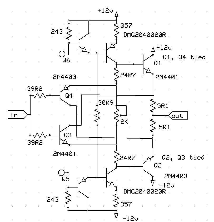

Scott: To those of us who are not EEs, it is unclear to me which output transistors must be thermally coupled to which (bias) diamond transistor. What value should the bias pot be set before turn on ideally with the transistors that you used. What are the Panasonic DMC/DMG number of the transistors you used. Thanks for bearing with the un-initiated! Ray
OK here's the details. For the pot just trim it to 0 and power up for a minute or two and then increase pot till you add the desired current to the total supply current, no finicky probing of an internal node to adjust bias necessary. You can also play in situ and see if you can effect THD in your application. I noted the thermal tying.
The values vary slightly on the schematics simply because the exact values are not that critical (I know it drives some obsessives nuts). Like 39.2 Ohm snubbers rather than 49.9 Ohm, that trip to the bin they might have been gone. That being said I noticed the 357 Ohm resistors could be a tad larger the ratio to the position held by the 243 Ohm one should be closer to 5/3, this only adds 400uA in that branch which does not do much and comes out in the trim.

. . . I noticed the 357 Ohm resistors could be a tad larger the ratio to the position held by the 243 Ohm one should be closer to 5/3, this only adds 400uA in that branch which does not do much and comes out in the trim.
How did you determine that the ratio should be 5/3? I would have guessed that the 357 ohm resistors are almost the least-critical value in the whole design: they simply need to be small enough to ensure adequate base drive to the output devices at the full-load signal peaks (but not so small that power dissipation becomes a problem in the current source and driver devices).
What are the consequences of omitting the thermal ties (Q1 to Q4, and Q2 to Q3)? Is it primarily a bias stability problem, or are there also significant implications for signal performance? Coupling a pair of TO-92's requires a little thought when determining the layout but isn't a major problem to DIY construction. It gets more complicated to couple a TO92 driver to, say, a TO126 output device, and I think it's almost impossible to get meaningful thermal coupling between two SMT devices in this application. (To be sure, you CAN get pairs of transistors in a single SMT package but the power ratings are too low for consideration as the output devices in this circuit.)
Dale
p.s. - perhaps both these questions stem from the fact that I still don't really have a good grasp of the analytical details of the diamond buffer output stage, the advantages it provides over other output stages, etc. I'm still stuck at Fig 1 and Fig 2 of the TI (nee National Semi) App Note AN-227, where the only thing obvious is that the B-E drop of the driver stage counteracts the B-E drop of the output stage, so there is no net DC differential between the input and output terminals.
The thermal coupling does not do that much here, but if you wanted to drive 32 Ohms it shows where it might help. The bias levels are somewhat just one best guess at how to distribute a target total supply current of 25mA. Since the input runs at 5mA a side the 5/3 ratio puts 3mA in the first rank of the diamond (a little is shunted away by the bias adjust), I just thought this was a good number enough but not too much.
