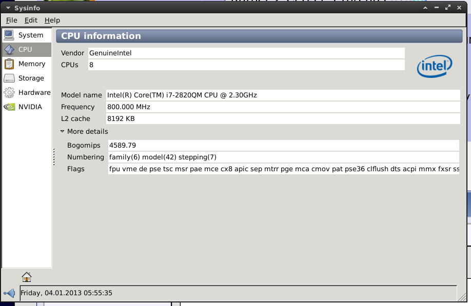

Rather 2 CPUs / 4 threads ..?..😕
No, I paid for and see 8 threads under Xubuntu 🙂
OOhps, it has switched down to 2.3 GHz. Does not wait fast enough.
Gerhard
