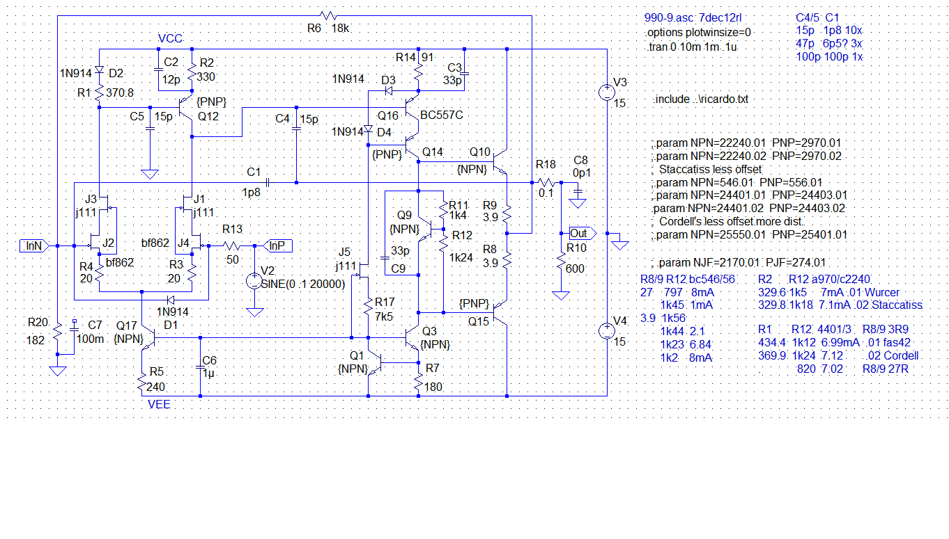

I've been trying to meet at least the spirit of Marshy's requirement for less active devices without spoiling the performance of the #2060 JFET990. Presently, it rivals SW-OPA ... at least in SPICE world 🙂
A key factor in this performance is the 'pure' Cherry compensation which keeps the Q10/15 output bases at very high Z.
Taking the VAS cascode reference to the emitter of Q16 helps and gets rid of one diode. It shows slightly less THD and better stability too. This type of cascode, used in the i/p as per Guru Wurcer, is responsible for good CMR & CM range.
Other small changes are ..
- Q13 becomes D2. R1 value is one area where the SPICE models are inaccurate. I'm certain a diode connected BJT will have less voltage drop than 1n4148/914. But its just a resistor value and this is our tweak point for output offset.
- Q16 is shown as BC557C instead of the 2n4403 cos it gives 100dB from 90dB distortion products. I doubt the difference will be seen in a real amp.
- C9 across the bias BJT tidies up O/L slightly which is obviously an obsession of mine. I try to keep caps small to minimize O/L recovery time.
J5 + R17 is just a CCS and could be replaced with a 0.5mA device provided it could withstand full VCC - VEE. Suggestions for this anyone?
I've been a fan of fet constant current 'diodes' since the '70's. The commercial ones (Siliconix) rated at 55volts are actually cascoded inside - thus the higher v rating- also have higher Zout and thats good for cmr. (for Q17, too) -RNMarshy
Thanks for this Mr. Marsh. It's certainly what's required to replace J5. I'm reminded I have some SPICE models for Siliconix diodes too.I've been a fan of fet constant current 'diodes' since the '70's. The commercial ones (Siliconix) rated at 55volts are actually cascoded inside - thus the higher v rating- also have higher Zout and thats good for cmr. (for Q17, too)
Presently, Q17 and resistor allows flexibility in choice of i/p LTP currents but a Siliconix diode would be perfect for production.
I'm quite a Luddite and in da old days would round up on young engineers whose designs had more bits than the products they replaced. Today, with SM, it's probably worth counting solder joints rather than bits but I still feel parts count is a significant indicator of reliability especially for a DIY item.

This is a segue into another variant of JFET990. While investigating the 'bootstrapped cascode', I came across Baxandall Super Pair which suggested the Great Guru originally developed it for high Ro .. just what's required for 'pure' Cherry.
This little change
- gets rid of 2 more diodes and on preliminary tests
- appears more stable than #2060 & #2321.
- Also overload is even better though we are now at the stage of shoving more than +/- 15Vp down their throats.
CONS?
- Some careful balancing of input currents, current mirror resistors & R4 to get at least Vce=0.5V across important BJTs else the excellent O/L & THD is compromised
- Re-introducing another gain stage may cause stability problems. I haven't done a full stability analysis & investigation. The Baxandall Super Pair thread has many caveats.
- The current mirror has to use smaller resistors so now contributes more noise. But the BF862s & 20R resistors still dominate. May change if we run as much i/p current as SW-OPA. See Sam Groner's critique of Self's PA book for details.

Baxandall (historically, properly attributed to the late Frank S. Boxall who invented it in ~1957) has drawbacks compared to the bootstrapped cascode (the latter also developed long before Hawksford's popularizations among audio workers). The bootstrapped cascode reduces base width modulation, Boxall does not. Transconductance overall is reduced, comparatively. For both topologies the effectiveness of the stage depends on how large the impedance in the main device's emitter is (higher is better for recovering more of the base current loss of the main device, as the returned current divides between the main emitter impedance and the external impedance).
Stability-against-oscillation issues, as you noted for Boxall, exist for both approaches (see my recent note on a mostly-air circuit using the bootstrapped cascode, which needed signficant R in series with the output collector for stability, and various remarks about stabilizing Boxall [-Larson-Baxandall-Shallow etc.] in the Baxandall Super Pair thread you referenced, and elsewhere (?) ).
An advantage of Boxall is the partial temperature compensation afforded by the opposing Vbe's. I stumbled on it way late by asking a what-if when using a complementary transistor for temp-comped bias, as to what would happen if something were done with the bias device's collector current? 😀 It was bad enough to discover that Larson at Tektronix and PJ Baxandall had stolen the idea when I was about 18, but even worse when I found the Boxall ref.
... just what's required for 'pure' Cherry.
... Q16 is re-introduced as an emitter follower (as JE990) but w/o the need for an evil latching diode across the Miller cap.
Referencing the VAS Miller cap to the output node, a la AD797, is right on the money - at least, that's what LTSpice says.
Regarding the diode across the Miller cap, I thought it was a Baker antisaturation clamp for the VAS. The Blameless-style voltage-follower VAS seems to work fine without the diode, and getting rid of its non-linear junction capacitance helps reduce H3 quite a bit.
It also helps to use separate current sources for the LTP and VAS, to reduce the possibility of overload/clipping transients spilling over from the VAS into the LTP. I think Douglas Self went wrong in the Blameless by using a shared biasing scheme for both LTP and VAS current sources.
Agreed
If you sweep the values of Rs (R3/4) do you get a null in any harmonic..... especially at 1/Yfs value?

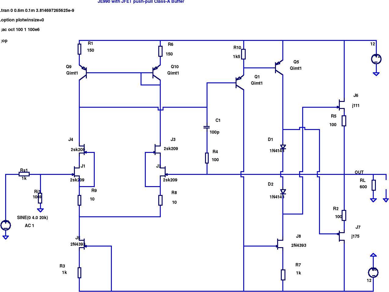

#2323 was a long evolution from JE990+Scott's FET i/p. Each change was tested ala #2306. I don't do fashion changes. Only in response to something which needs improving.
If I get rid of another 2 BJTs I'll meet Marshy's requirements for a production OPA 🙂 OK. I'm cheating by not counting CCS diodes as actives. 😀
This is essentially #2323.If one drives Boxall with a high-Z source, like the collector of another transistor, to essentially remove the base-width modulation effect on Vbe, the performance can be fantastic. See the Danyuk reference in Walt's bibliography for example.
But there are a number of interacting factors in any non-trivial circuit. You can get rid of the evil effects of modulated Cob in several ways. It is most evil when the Common Emitter stage is current driven. You see this if the VAS is a simple PNP with no extra bells & whistles.
Cascoding as in #2321 and my previous submissions, stops Cob from being modulated. Just adding this to the single PNP gives SW-OPA performance with a few tweaks.
Another 'cure' is to voltage drive. Original JE990 and the FET i/p Wurcer derivative do this cos the extra emitter follower on the VAS. If you remove the evil Miller cap diode, you get SW-OPA performance with a few tweaks. Alas you need the diode if you want clean O/L.
Baxandall Super Pair may just be providing a measure of voltage drive. This may be a simpler explanation than 're-inserting the base current into the emitter'. The residuals, even at very high CL gain, for all 3 (cascode versions, Baxandall, 'JE990 w/o diode') are very similar and at levels which suggest they won't be seen above noise in REAL life.
Comparisons are complicated cos the cascodes as in #2321 & #2060 have one less gain stage so at least 20dB less loop gain at LF.
My main interest in Baxandall Supa is SW-OPA performance w/o nasty overload (already achieved with #2321 & previous) but with two less diodes 😀. Gotta finish checking stability.

Hmmm..m. Dun get rid of any active devices. Does get rid of 2 devices in the forward path so lose loadsa Loop Gain.To be more precise, I should say that I meant using Boxall as a compound cascode, with the high Z drive from the collector to the main Boxall emitter. See Danyuk's paper for an example.
Or the schematic that PHEONIX linked to 🙂
Dunno if you need all dis complexity for a full OPA. The fully obfuscating website, Super TIS, is more interesting cos it discusses compensation.
Worth a play I suppose. Doubt if it will provide better performance than #2323, #2060, SW-OPA etc
But if the same performance, but less devices ... or even just less devices in the forward path (so better stability) I might steal ... I mean present an improved version in one of my future efforts. 😀
Ain't SPICE wunnerful 🙂
