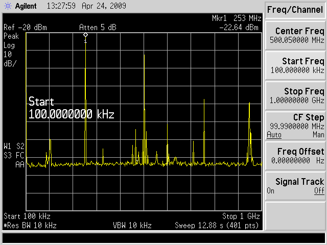

Any circuit with Complementary Feedback / Sziklai Pair followers may oscillate if designed badly but the cure is usually simple. In this case, IF there is a problem, the solution is to change 2 resistor values. In a VERY BAD case, you may have to add 2 resistors.
There are millions of amps with CFB pair O/Ps which aren't VHF oscillators. I'll concede there are thousands, mainly Golden Pinnae, which do oscillate at VHF from time to time.
I have documented the problem in another thread (250MHz oscillations, Agilent spectrum analyzer measurement). Output CFP of DB is prone to UHF oscillations triggered by RFI impulse sent to the output.

Got a link?I have documented the problem in another thread (250MHz oscillations, Agilent spectrum analyzer measurement). Output CFP of DB is prone to UHF oscillations triggered by RFI impulse sent to the output.

Pavel, I could only find thisI have documented the problem in another thread (250MHz oscillations, Agilent spectrum analyzer measurement). Output CFP of DB is prone to UHF oscillations triggered by RFI impulse sent to the output.
http://www.diyaudio.com/forums/analog-line-level/146693-john-curls-blowtorch-preamplifier-part-ii-2996.html I can't believe I've just looked through more than 350 posts to find it.
But Marshy's headphone amp, neither the pic at http://www.linearaudio.net/index.php?option=com_content&view=article&id=161:a-headphone-bufferamp-and-auto-eq-for-headphones&catid=44:volume-3&Itemid=108
OR
#522 on this thread
are standard 'Diamond Buffer".
So are the Agilent plots of some other evil Golden Pinnae device?
