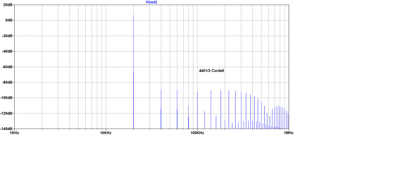

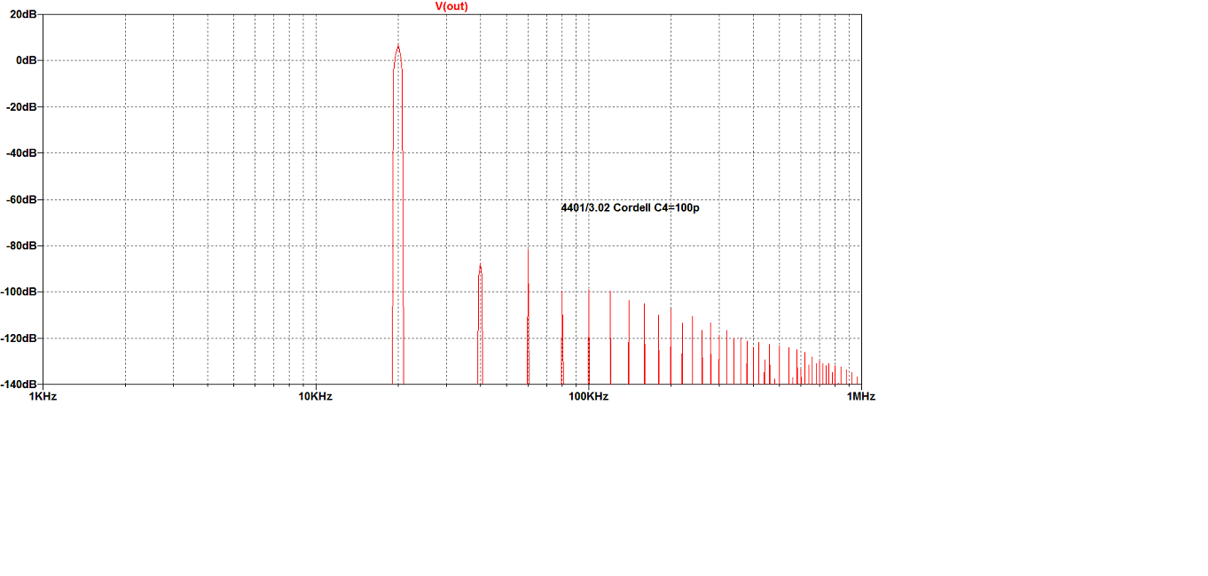

Voltage Followers into 15R @ 3.162Vp
Here's what old topologies can do with some dirty tricks. THD plots for Voltage Followers @ a headbanging 3.162Vp 20kHz into 15R.
#2060 is running 7mA through the output devices. SW-OPA 10mA. I've used Cordell's 4401/3 models cos they are worst case for both distortion & stability in these sims.
You can see the characteristic rising spectrum of crossover distortion with SW-OPA but remember these products are 90 - 100dB down.
More Iq and medium power devices will reduce crossover but #2060 will always show less crossover at the same current.
The best ADs/DAs today are juu..ust 20b so 117dB [*] is about the measurement limit today for distortion residuals. See Scott for his experience of a Panasonic AD with true 24b performance that was declared un-manufacturable.

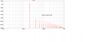

I've been studying Jerald Graeme's "Feedback Plots define Op Amp AC Performance", sboa015.pdf from the TI library, while playing with stability of the FET990.
There are 2 considerations for stability which also lead to 2 definitions of 'Unconditional Stability
  • Stability with different levels of NFB. This old warhorse is fairly (??!) straightforward. Easy to have a different version for gain less than 3x etc or a single NPO ceramic to change. These are my C4/5 recommendations in post #2060. Graeme helps me formalise much of my experience & thinking and introduces at least one new dodge. Prof. Cherry is excellent if you ken reed, rite & kont.
  • Stability with load. This is the important one with Power Amps as you don't often tweak NFB but you do have loadsa different loads. Output Inductors are a big help for this but for a supa dupa GP OPA, SM inductors are truly evil and muck up your 1 ppzillion THD for various reasons. But easy (?!) enough if your noise gain is fixed.
