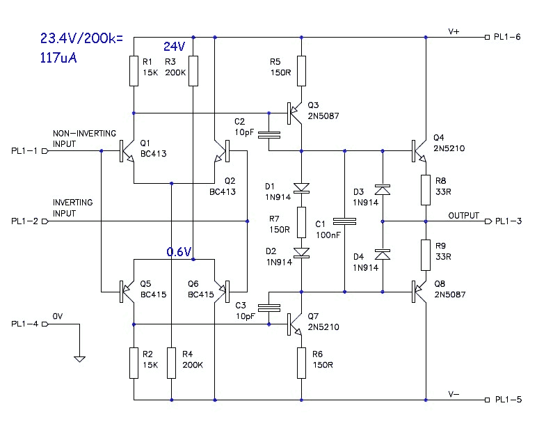

My idea here is to make these op-amps perform as well or better than the original design. My main problem is finding a replacement for the outdated BC413/415 transistors.
These two designs are from Bryston. So they appear to be two different versions of the same opamp, for two different products. Albeit with a different supply. one is 33V and the other is 24V. I'm guessing even with that current setup it's not enough to be a problem, maybe it has to do with the noise specs for each transistor, I don't know, guessing here.
My goal is to find a pair of transistors that looks as good as the BC413/415 stated in their datasheet, but seems to be more difficult than I thought...
The higher the voltage the worse thermal drift issues will be, and the harder to get rock solid protection built-in too. One of
the brilliant features of (nearly) all opamps is full short-circuit protection.
One issue I've just noticed is the lack of back-to-back diodes across the inputs in either design - this is essential for a low noise opamp to prevent the input transistors having their EB junctions undergo reverse breakdown - this rapidly erodes noise performance and any BJT used for its low noise needs this protection across its base-emitter junction (or for differential pairs you can simple use the two diodes across the inputs).
See the graph on page 32 of this lecture: https://www.uio.no/studier/emner/matnat/ifi/INF5460/h16/undervisningsmateriale/f8-1p.pdf
You'll note bipolar opamps like the NE5532 have these diodes fitted if you look in the datasheet schematic. The AD797 schematic doesn't show them, but the absolute max. section says the differential input voltage must stay within +/-0.7V which means they are there.

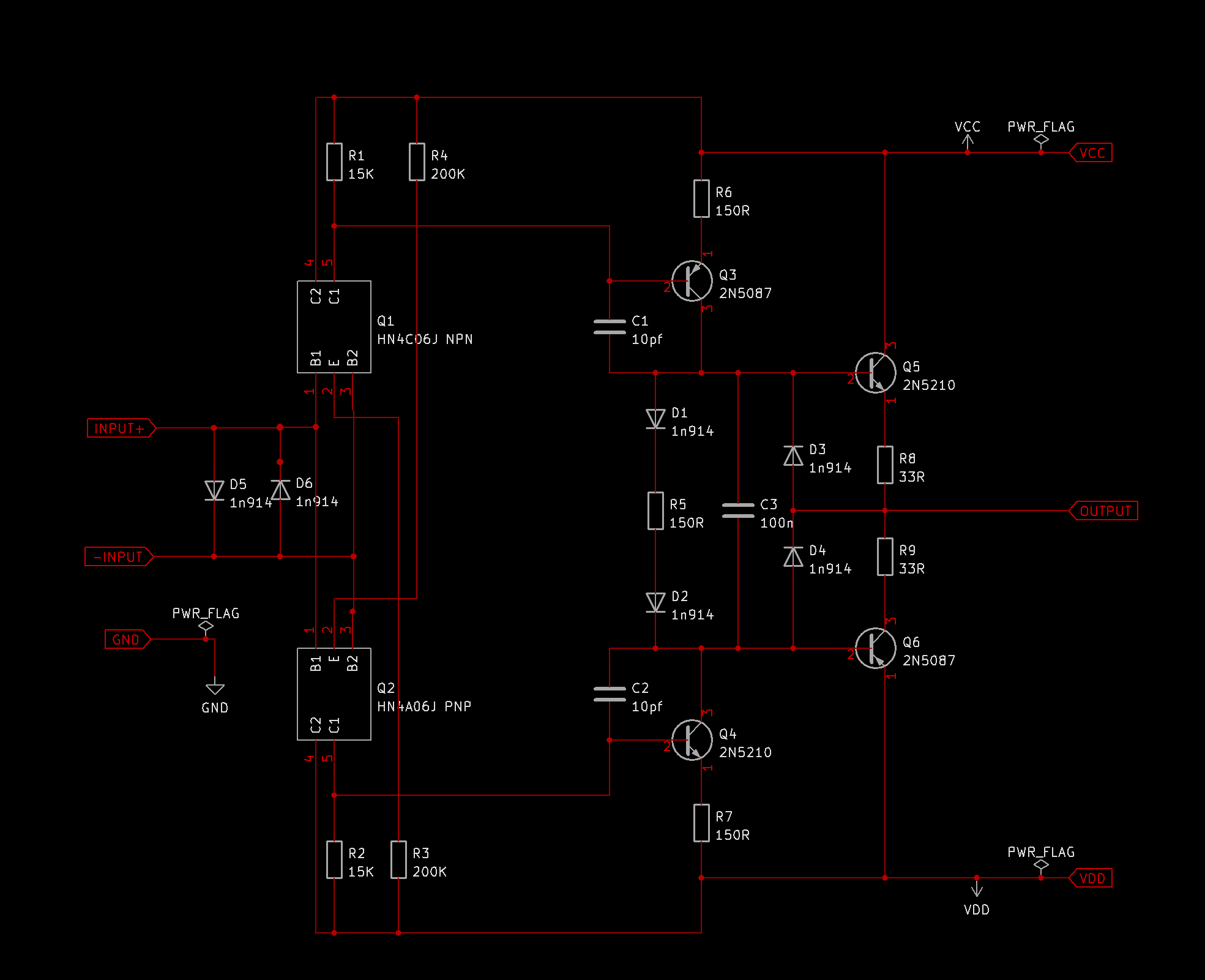

Well I think I'll give the new Toshiba part a shot, at least it has some noise specs on the datasheet. I'll try to put the protection diodes on the board, it seems like a good idea.
I may need some help on how to get this device to work within that 1db noise window.
Correct if I'm wrong, with this source resistance, I should choose collector/emitter resistors so that Ic is about 20mA?. What would be the best way to do that?

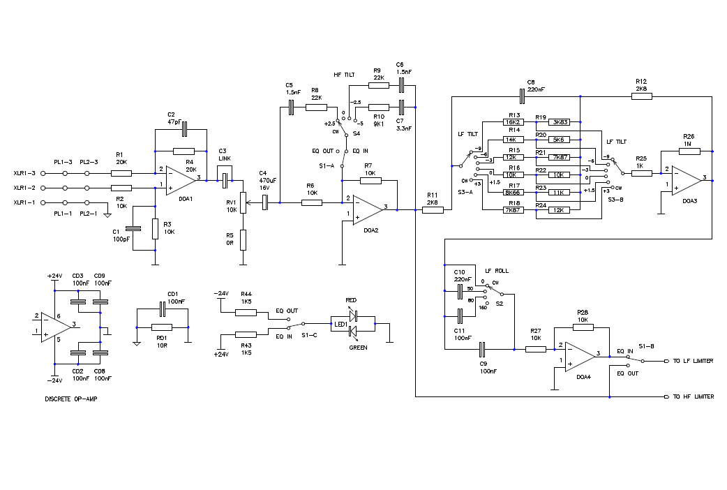

This are my main studio speakers. DOA 1 and 2 go bad quite often for some reason and start to make noises, (maybe the lack of protection diodes as Mark pointed out)
I used to replace the diff pairs to solve the issue but I run out BC4XXs transistors.

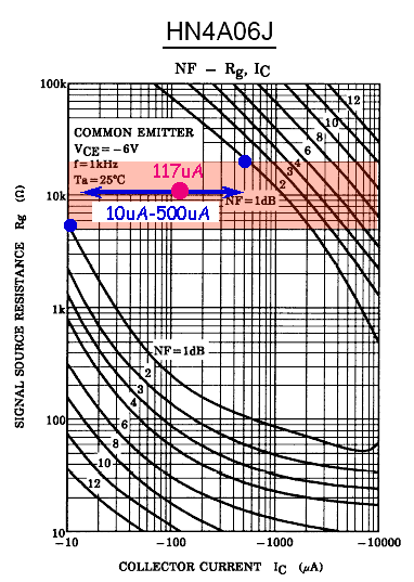

datasheet only shows the "Typ." value while the old ones used to show the Maximum
Did they? In any case: a BJT's hiss is known from physical constants, unless it has dirt, a defect. In 1969, transistor processes were un-clean. In this day of million-transistor CPUs, Silicon processing is reliably clean. Are "ALL" transistors low-hiss? No process is perfect. But hiss-testing is VERY expensive. And 99.44% of users today do not care. Why would they pay for hiss-test? When even if they do care, 99+% of their products will be nearly minimum hiss?
Note that "known from physical constants" implies that different transistors of the same junction area will have the same noise curves. Unless they have excess resistance (few do today). So you mostly do NOT have to adjust operating conditions for the general-purpose 100mA-500mA small signal devices. As long as you are in the BJT sweet-spot 1k-50k. Yes, as you get into 10 Ohm MC cartridges even a few Ohms parasitic matters, and you must be clever. High impedance also, though today we have excellent JFETs. And your 5k-20k is not "high" for modern high-hFE low-leakage BJTs.
Without thinking "is it 5k or 20k?", we can block-out that impedance range in pink. And tick-off the extreme 1dB NF points in blue. You will be 1dB NF for 10uA to 500uA. And the schematic suggests you are working at 117uA. Which is really as close to the middle of the 1dB NF ellipse as can be.

@PRR I worry that 117uA of tail current, evenly split between Q5 and Q6, produces a worrisome small voltage across collector resistor R2. So small that temperature induced variations in the VBE of transistor Q7, produce worrisome LARGE variations in 2nd stage DC bias current.
0.117mA/2= 0.058mA
0.058mA*15k= 0.87V
2N5210 data: https://www.mouser.com/datasheet/2/149/2N5210-193106.pdf
Assume@25c @1mA, about 0.65V?
0.87V-0.22V= 0.22V across 150r makes 1.467mA, reasonable.
At 125C, 0.200V less Vbe, yes, this is a problem, if the weather is above boiling, and maybe on a hot day in the Mojave.

Just to report that the Toshiba transistor pair (HN4C06J) ended up working very well on this opamp. Im thinking on using two of this opamps for another project as an output diff amp because I need a 24v opamp there.
I added the protection diodes at the input, but Im wondering if I need to change the output devices for increased output drive current. Any advice on how to improve this opamp desing are welcome, thanks!
What is not not doing well?
How much current do you need? (Don't buy a 63Amp circuit to light a 0.046A LED-lamp.)
As shown it can do 36mA. Not limited by the transistor but by diode clamp and emitter resistor. How much do you need?

Ideally it should be able to drive a 600 ohm input transformer at around +32 dbu, with a long cable.
It's for an output stage of a double balanced mic preamp
