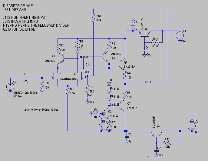

discrete op amp
thought some here might find this interesting, has a lot of similarity to a power amp design. original design came from the Apt-Holman preamp, except that the Holman had a fet and a bipolar in the diff amp, but that causes a lot of offset, so i replaced the bipolar with another jfet. also replaced the RIAA network with just a resistor in the feedback loop.
-3db points are 2.5hz and 35khz
distortion: -60db (as-is with no tweaking) mostly even harmonic.
unclejed613:
Nice design, simple to understand.
A few questions:
- Did you just simulate it or have you actually built one?
- Temperature stability? PSRR? Output impedance?
- Why do you think one should/would use a discrete op-amp vs a modern audio opamp (2604, etc)?
Very interesting posting, hope you cna show us a picture soon of the working prototype.
AndrewT:
Can you explain your suggested changes/questions?
Hi Giga,
moving C3 takes out the Miller compensation and gives NFB over two stages rather than one. The Miller comp cripples the LTP.
I think the rather narrow 35kHz bandwidth is due to the gain being set to near +60db. I suspect that this discrete will never be used like a true opamp and it would be fairer to set the gain (and see the CL BW) to nearer where it will be in practice.
tnx...... it's what i get for working late hours..... q5 and q7 are backwards............. i'll redo it and rerun it.....
actually the circuit in it's original form (with a 2n3904 in place of j2) was a very successful phono preamp in the Apt-Holman preamp
tnx for the heads up out there...... unfortunately sims rarely tell you that you just let the "magic smoke" out of components..... those 2 backwards pnp's definitely would have given a nice smoke and light show.......
hi
it is a very simple op-amp circuit
very much standard,
except for
1. the JFET input
2. current mirror 'on top'
3. noise reduction transistors in supply rails
All these 3 features will probably add to improve this amplifier.
We can still get fantastic good performance from these kind of amps.
:) Often much more performance than we ever need.
At least if the load is not extremely 'heavy' (=very low resistance)
Nice circuit, unclejed
Regards

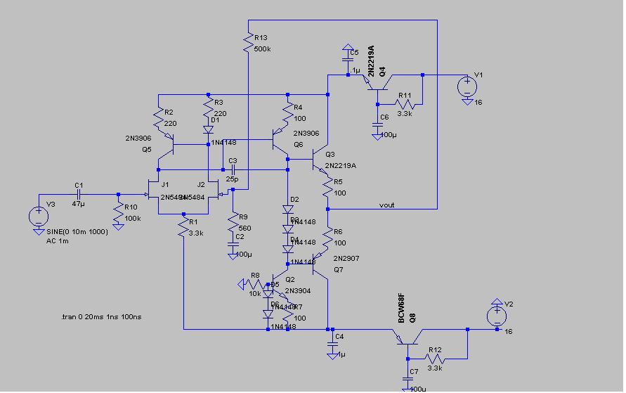

ok, here it is, corrected..... simmed it, and even harmonic distortion is gone, if you change the 25pf cap to 5pf, high freq -3db point is 90khz.....
ok, i guess i figured out how to tell when one has done something stupid in a sim..... if you make a fatal mistake (backwards transistor, applying negative feedback to an inverting input (i.e. a "double negative) or positive feedback to a noninverting input, etc...), the sim either takes a long time to find a dc operating point solution, or never finds one......
just like the rules for building a physical prototype, the rules for "sim building" should contain the following:
if you can't figure out why it's not working quite right, and you can't remember a> where you put the solder, or b> what transistor you were supposed to flip before adding resistors, you need some rest......
i'll be protoyping this after i get my parts unpacked.....
and to answer another question..... yes, but off the top of my head i can only remember.. the japanese equivalent of a 2n3904 would be a 2sc1318, and the 2n3906 would be a 2sa945, for the others, the "output devices" are 60v/800ma devices, and the jfets are 80v low noise jfets
the original gain of this when it was used as a phono preamp was about the same, but it's frequency response was an RIAA curve.....
now that i know what i did wrong, i'll try the combo (fet/bjt) diff amp again and see what, if any advantage there was in using it.
as far as the transistor power filters go, the published noise specs of this as a phono preamp are : 74db below 5mv (about -100dbV).

all that needs to be done to reduce the gain is to change the ratio between R13 and R9......
i'm thinking that if the filters are removed, and R13 were replaced with a pot, this would make a great headphone amp as-is.
what interested me was it's similarity to a power amp...... it could be scaled up, replace the resistor in the diff amp with a current source, use a current mirror-current mirror to drive the VAS symmetrically, change the diode stack for a bias transistor, bigger output devices, higher voltage rails, etc......
i did sim it with a 2n3904 in place of j2. it lowers the distortion a little, but the offset is several volts at the output, even though there is a dc correction cap (C2) at the inverting input...... i think it has to do with the difference between the 0.7v bias required for the bjt, and the negative 1.5v required to bias the fet in the linear region.
btw, i was wrong about the pnp japanese transistor..... 2sa970, not 945
can of course be used with any lower gain
a headphone amplifier would not often need more gain than 4
sometimes only x1 = unity gain
The idea of using a input pair of transistors
is that they should be as perfectly alike (matched) as possibly can be.
Otherwise you get no good results, and of course an offset.
If you change the input pair, you should change both J1 and J2
to same type, and in reality these 2 transistor exemplars
should not only be BOTH 2N3904, but also
should be chosen to have as same data as possible:
- same Volt BE is the most important
- good if they have same hFE gain
Offset.
Try replacing D1 with a transistor, one 2N3906,
to match Volt-BE of Q5
... this replacement transistor (for D1) should be used like a diode
You attach Collector to Base
and the drop across this 'diode' will be = Base-Emitter
This may correct offset.
If you still do not get output offset around 0 Volt,
change the value of R4 ( 100 Ohm ), step by step,
until you get lowest possible offset.
For lower gains you could try removing C2,
as there is almost no base-current into a JFET, causing any offset-drop across resistors.
(unless maybe they are as big as R13, 500k)
Try for example R13 =47k, R9=15k and remove C2.
Instead connect R9 directly to Ground.
this will give a gain of:
(47/15) + 1, which is like ~ 4
When you lower gain, you may get instability.
If so, you should increase C3 (5pF) a bit .. maybe to 22/47pF,
until it is stable.

i found out why tom holman used the jfet-npn diff amp, even though it caused offset. it was to reduce noise.
i removed c3. -3db point moves up to 200khz, GBW becomes 70 Mhz, with the phase shift reaching 180 degrees at 35Mhz, while the gain is still 12db. without c3, this amp is not stable at gains of 12db or less, so it definitely cannot be used at a gain of 4, or unity gain without oscillating.
with 5pf compensation, the amp is stable to unity gain, GBW is 46Mhz, -3db point is at 94Khz.
with 2n3904's as the diff pair, the GBW is 66Mhz, and 180 degree phase shift at 36 Mhz, while the gain is 10db, which puts the amp back in unstable territory again. this is probably because of the junction capacitances of the NPN transistors. using NPN transistors bumps up the distortion about 10db. this is still with 5pf compensation
this amp seems like a good model to play with.... i think i'll test the jfet diff amp on other designs, especially one of the ones i've been working on that has instability problems.
i also played with different bias levels on the output transistors, and found that less bias causes more distortion.
