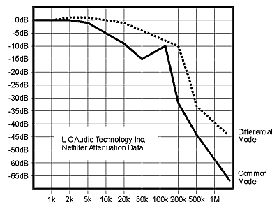

Using air-core inductors you would likely pick up as much noise as you filter out. With the toroidal cores, as in the pic above, the magnetic path is closed (pretty much) so pickup is not a problem.
The use of iron powder cores gives a distributed air gap, raising the saturation flux of the core. Iron powder also becomes lossy at higher frequencies, making it even better for EMI suppression.
Layout is crucial with an EMI filter - there is little point in spending lots of $ on filter components, only to have the noise skip around the filter through parasitic capacitances.

The comment about the transfomer forming a low-pass filter is quite valid for differential noise, less so for common-mode noise.

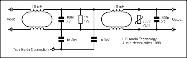

1 megohm to discharge the caps sounds too high because the time constant will be very long. As an example 10K uF discharged by a 1 meg resistor will take 10000 seconds to loose only 33% of its charge.

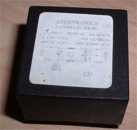

I found these new filters here.
They are very good quality and they shouldnt supress dynamics of power amplifiers because the series resistance of the coils is extra low.

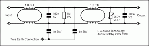

DIAR, are you awre of that inductors are usually winded on a single core, "common mode inductor". It's also essential to keep the filter compact in order to get the highest filtering properties.
The filter looks exactly the same. The caps value is determined by the max continous current.daly41k said:Has anyone designed a dc blocking circuit for incoming AC for 120 volts US operation? I would like to put this circuit inside my power amp. I already have RF and EMI filter. thanks, dave
