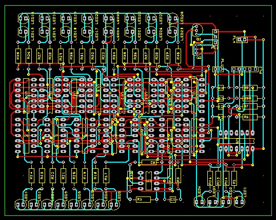

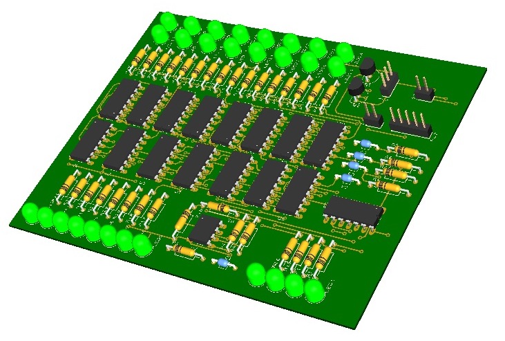

Well, You asked and I delivered!
Here's an extension of my previous design WITH Data logging!
It supports up to 8 testing trials with trial # indication AND the X state in each trial! (Green LED = A, Red = B, yeah... i know you can't see it.). Pressing "Randomize X" again at the 8th trial will reset all recorded data.
If you do a PCB, I'm in!
I used Auto-route in Designspark PCB...
Hope it works... :S

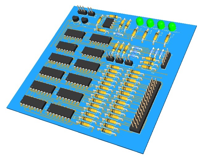

ABX box Revision C: (Probably final revision)
Instead of logging individual X states, it now counts the total number of trials and number of correct guesses.
During each trial, the user can switch between "A", "B", "X" and "Mute" then press "Guess A" or "Guess B".
Once the switch box receives an answer the "trial counter" goes up by 1 and the "correct guess" counter will also go up by 1 of the guess it correct.
Both counters range from 00 - 99, when counters are at 99 and a +1 signal is given, nothing will happen.
During any time in the test, the user can also press the "reset" button to reset the test.
because different people may need different relay configurations depending on their applications, relays are not included on-board, instead, 2 open-collector outputs are given for each of the states (A and B).
due to the variations in 7-segment display pinout, they are also located off-board, a 30-pin connector with V+ and 4x7=28 open-collector outputs is given...

EDIT:
The On-board BOM says that the 74HC32 is a NOR gate, it's actually an OR gate
Attached Schematic, PCB layout, 3D view:
(The schematic is kinda messy....)
