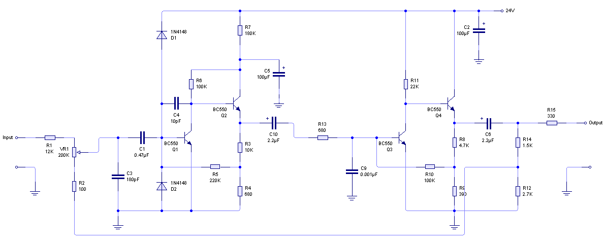

I was reading "The Audiophiles's project sourcebook" from Mr. G. Randy Slone, and came across a dicrete preamp that has 2 inverting gains stages and in between a tone control network (figure 3.6).
The thing is that there is feedback applied between the output of the 2nd gain stage (thru a voltage divider) and the input volume potentiometer (right where you normally put it to ground). Also, this feedback line passes thru the tone control network.
I was wondering if I can just make without the tone control network and still use both gain stages with this kind of feedback without changing any other parts.
The tone control network is coupled thru capacitors to both gain stages.

HI W,
Ok. Thank for your kind reply.
This could be the modified preamp, without the tone control network and what I had in mind...

Too many coupling caps and not a modern design.
Pass, Curl, PMA, and others have better designs if your going to use your time to build something discrete.

The volume control in the feedback loop varies the amount of feedback around the circuit to change the gain, hence change the volume. It changes the ratio of the input resistor to the feedback resistor; analagous to Rin and Rf in the attached diagram.

the advantage of the post5 inverting opamp circuit is that it can give both +gain and -gain by changing the ratio of Ri:Rf
The disadvantages are that it is inverting and that Ri is seen as the input impedance by the previous stage.
