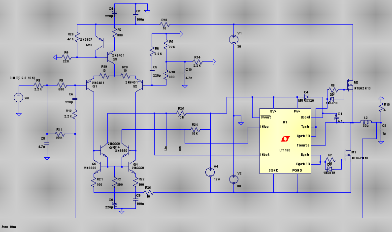

Since my last project streo class-d amp with HIP4081 I am trying to implement a good input section to improve sound quality. Althoug my amp is good on sound scope results tell me some improvments.
Any way I tried a discrete input comparator section of UCD amp. This comparator eliminates input opamp/integrator. Probably it is very usefull for full bridge desing but, for an half bridge one have to implement a FB network to it.
You all experienced DIY'ers on Class-D "Baldin,,Fumac, RX5, Luka, BWRX and others" please tell me how can I implemet the FB network to this input?
All comments are will be helpfull.

Try modeling the HIP4081 as a transmission line with propagation delay (~50ns typical or ~100ns max according to the HIP4081 datasheet) and the mosfets as current or voltage controlled switches. Add the LC output filter and feedback loop and you can start experimenting with component values. Look at the diagram in the first post of the "Philips UCD application note" to see the feedback network and some component values that will help get you started.

I enclosed a signal result. This input section is not only for HIP4081 but also IR2113( R1 still adjusting the dead time). Power supply lines can go up to +/-50 or +/-60V for a high power full range amp. I do not thinking about a IC version of UCD. As you can see it has a triangle wave input. Therefore it is not self osc. type. Inverting input of this comp will get overal audio signal and FB. Question is that, should I use the FB network after the filter inductor?

Ok , Ok I see and the answer resulted itself by reading Bruno Putzeys' AES paper. I understand that , Hysterisis mode swiching can be achieved before the filter inductor and UCD mode is more audible than hysterisis mode. OK, see the enclosed IC version of UCD . It is based on a slow mosfet driver LT1160.
I will try this input modulator with IR2113. The resistor (R1) adjusts the dead time but this time decreasing its value inreases the dead time.

Hi Whortless. Please don't get discouraged if you don't get many replies. You're working on something that not a lot of people understand very well - I'll freely admit I fall into that group!
I don't have my windows computer anymore, so I can't open the asc file. Any chance you could post a GIF image of the SwCAD schematic?
Experimenting is one of the best ways to learn how part changes affect circuit operation. You've read some good documents all ready. There's also a good thread by SSassen about designing/building a non-discrete UcD amp. Might be worth having a read through it: http://www.diyaudio.com/forums/showthread.php?threadid=58476

Thanks for the reply. I enclosed the lastes shematic version in GIF format. In my view the advantage of using a mosfet driver is not to striving with component values of two PNP transistors in UCD.
Now, let us to try the increasing the sw frequency for better sound quality.

Try this on last shematic ; R1=680, R11=33K, C8= 470p and R12,R6,R5+ C10,C5,C2=open. Get the FB before the filter inductor. What the swiching topology is now?
Driver IR2113 and I get 500Khz without heat. Tomorrow I will show the scop results if I could get. Hýým , Do not forget to apply audio signal otherwise will not oscillate.

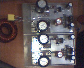

Any way, to day I did my small UCD 🙂. It works at 370Khz on idle. All the components are SMT except the IRFP250Ns. Here is the tested channel's photo. Other will be tested soon. It is an easy and cheap amp. Some times it is very hard to find some special components, therefore I could not decide to put which one to my car. HIP4081 amp will wait for other four channel for my home theatre 🙂 and UCD will go in to my sub's box. I am planning to add four fullrange channels to this one and certainly will add some protection circuits.
If a diyer interested I can post the PCB files and shematic of this amp. I tested this with single ended input but, one can put differantial inputs to it.

PS. sorry for the low resolution, my KODAK's charger broken and waits for me to repair it 🙁.

Amp looks very good, nice and small. I like it
