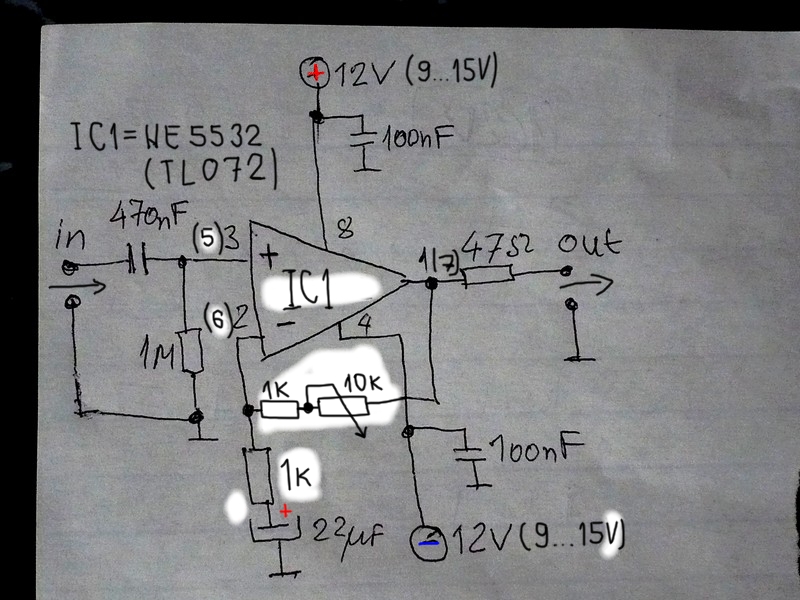

Hi all!
Here is simply a good schematic that can do the job!
IC1=NE5532; LF353; OPA2228 etc,...
The input resistor (1MOhm) connected to ground determines the input resistance preamplifiers. For example the violin ceramic pickup should have a value of 4,7 MOhm, for a guitar pickup from 1 .. 3,3 MOhm!
With the trimmer 10k or (1 ... 470k) raises the gain to preamplifiers.
Cheers!
