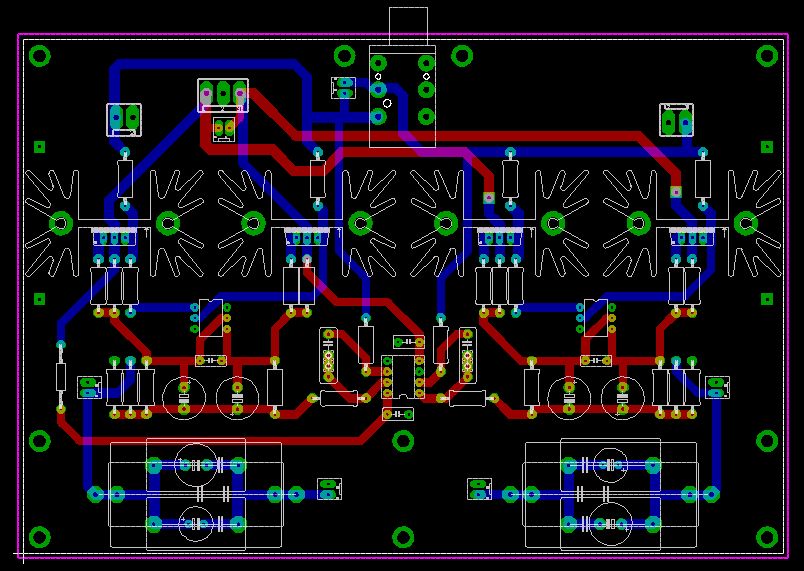

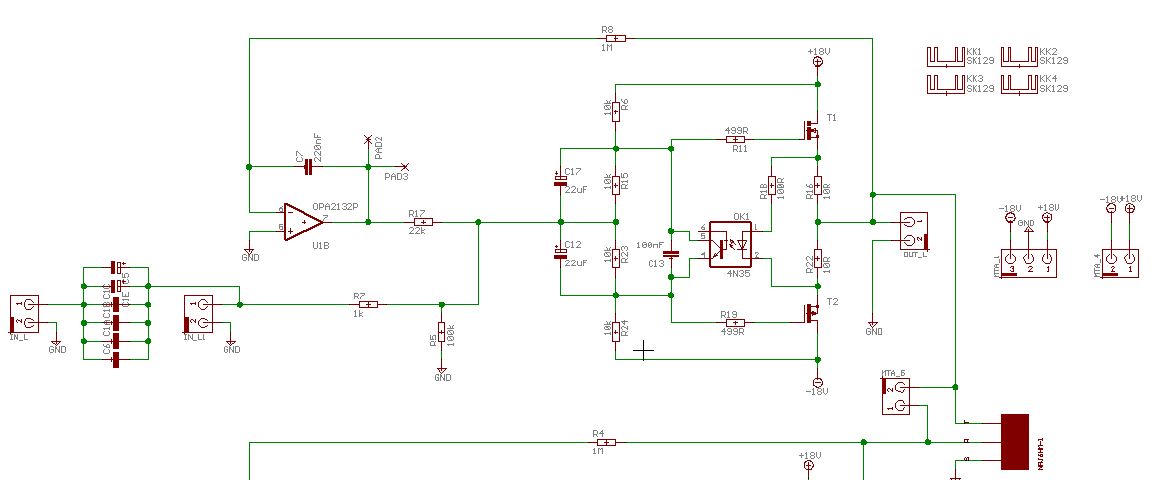

I built a prototype last week.
Unfortunately I made a mistake with the MOSFETs.
2 pieces are smoked...
I corrected that with flying wiring and the function test was successful (only one channel due to the lack of other MOSFETs).
Bias 120mA, offset 2mV constant with servo.
It takes about 8 seconds after switching on until the offset goes down to 2mV.
-> Could this be speeded up by shrinking C7?
Without servo offset = 250mV but very constant.
-> Is there an alternative to the servo to push the offset to 0?
My source (BA3-FE) delivers about 8Vrms.
At the output of the power amp I have about 7Vrms@40Ohm, that's pretty decent.
At the end of this week I will get new boards with a corrected layout.
And new MOSFETs.
Then I can continue to do tests and, above all, a hearing test...
(R16/R22 are 5R not 10R)
