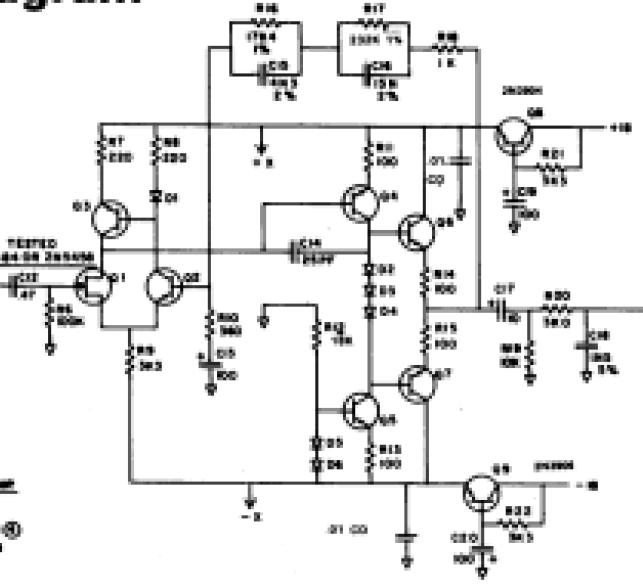

you might find the following interesting..... this is the phono preamp from the Holman preamp. you will see that it IS a discrete opamp it has a FET and a BJT as the diff pair in the input stage, which does give the output a 2V dc offset (which is why the "opamp" has an output coupling cap). i suppose you could use a pair of BJTs or FETs instead. you can do a lot with this circuit. the feedback loop has caps and resistors in it which gives it an RIAA frequency response curve. the RIAA network isn't necessary for this being used as an opamp. the gate of Q1 is the nonimverting input, and the base of Q2 is the inverting input. for phono preamp use Q1 was a device hand selected for low noise. Q8 and Q9 are capacitance multipliers which act as active filters for the supply rails.
