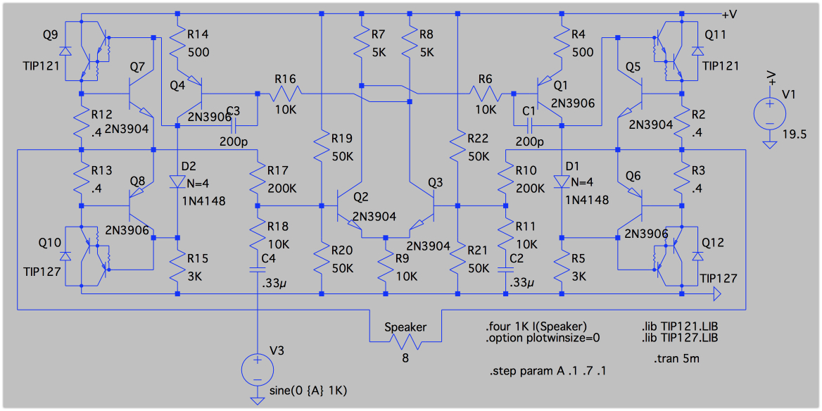

Thanks for the inputs so far. I reckon to generate the two differential input, I will just use a transistor and 2 resistors. The amp I am looking at might be a simple class a comprising of a common emmiter with 3 diodes driving two transistor in push pull.
However I am planning to run it from single rail supply. So I wonder how do I keep the bias to both sides in check through different voltages, temperatures etc. I think those chips solve it by using a common bias voltage divider. Any other tips of these designs would be really helpful to me.

Here is the PowerAmp schematic from LTSpice examples.

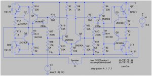

However, for practical use, this kind of circuit normally requires a common mode control loop (CMCL) - a simple implementation is shown at the 2-nd picture.
