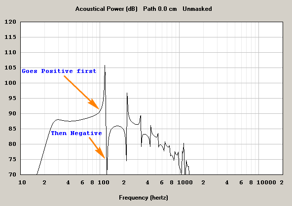

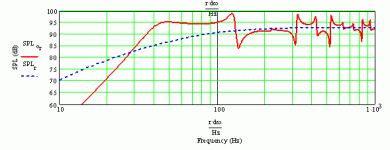

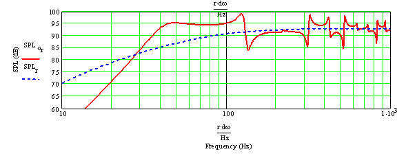

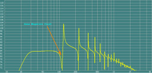

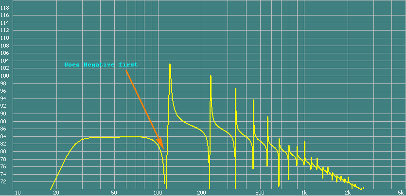

Comparing an Identical driver/data etc with Dayton Audio RSS265HO*4 between WinISD v0.7.0.950 & HR v39.90 sims, essentially all the results were very similar, with ONE exception, which i hadn't noticed before !
HornResponse simmed with no masking of enclosure resonances. WInISD simmed with "transmission line"-model for port simulation.
See the difference between the graphs ! Is the the reason HornResponse is showing just the enclosure resonaces & WInISD just showing the port harmonic resonances ?

I find it interesting that the major difference between the two program graphs, are the inverted rising/falling points, inbetween the others ! It's those differences that i'd like to know the reason for ?
@ Brian Steele
The harmonics do change with both programs, but that's not what i'm wondering about.
But, please explain the reason for the differences shown for the positive going responses versus the negative going responses, between both programs ?
I have no idea why the WinISD combined response results should be different to those generated by Hornresp. They look suspiciously 'neat' to me, so perhaps there is some simplification of the port 'transmission line' model somewhere. The Hornresp combined power response results are consistent with those produced by AkAbak, and by a simulation program developed by Dr Bjørn Kolbrek to assist with his horn loudspeaker research.
How do the non-combined separate outputs from the driver and the port compare in WinISD and Hornresp?

just trying to discover why they differ re the Pos V Neg areas ?

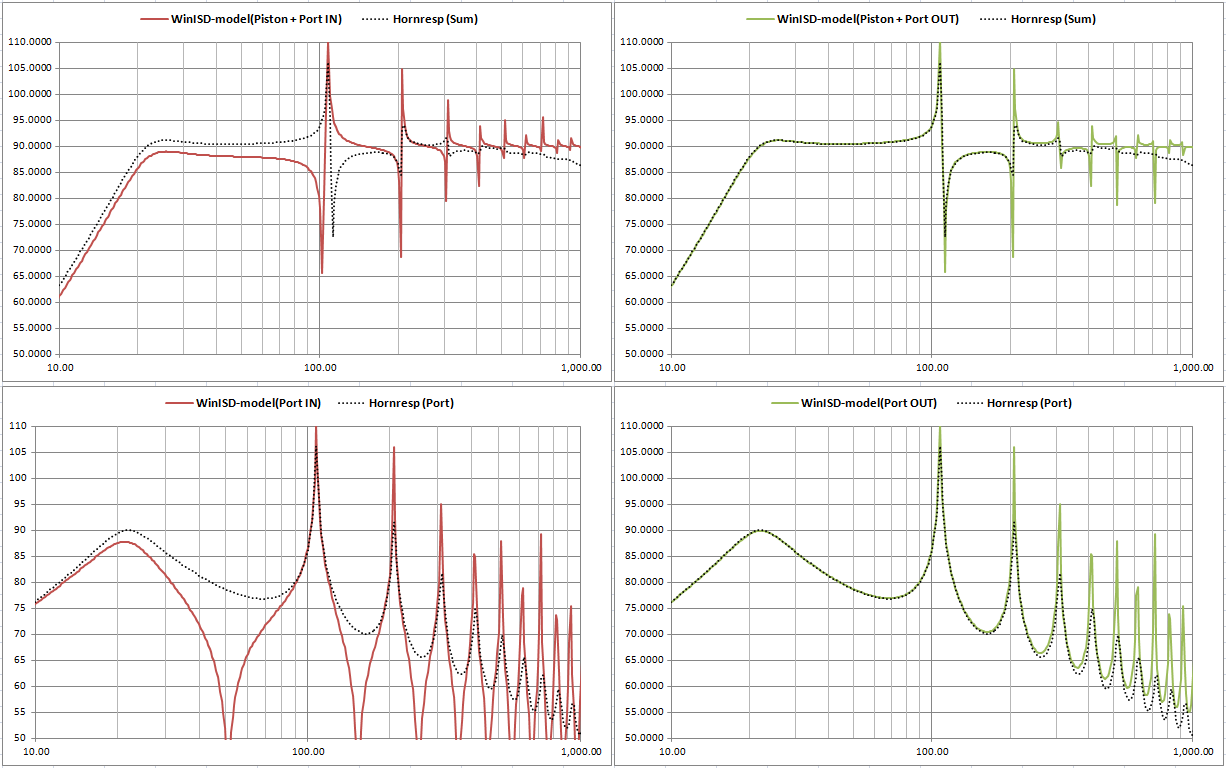

I stumbled on a white paper(attached) on the box modeling approach used for WinISD here:
http://jahonen.kapsi.fi/Audio/Papers/enclosuremodelling.pdf

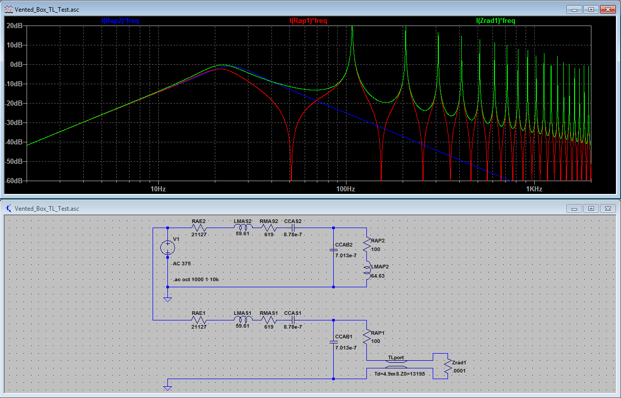

Scanning the equations used for modeling the port of a vented enclosure, it suddenly came to me what was wrong with the WinISD “transmission line” port model. In simplest terms, WinISD is basing the acoustic output of the port on the volume velocity “ENTERING” the port from the enclosure side. Hornresp bases the port output on the volume velocity “EXITING” the port to the listening room. The assumption is that the air in the port is acting like an ideal lumped mass moving in and out of the port in perfect unison. In actuality, when the wavelength of sound gets smaller than the length of the port, this is not a good assumption since air has properties of both mass and compliance. Both magnitude and phase between entrance and exit will be different.
For an example, I used a LAB12 driver in a 100L enclosure tuned to ~23Hz with a 1.6m long port 20cm in diameter. Voice coil inductance was ignored.
Pic #1: Spice modeling comparison of the WinISD lumped and transmission line port modeling.
- Blue curve is the volume velocity thru the port modeled as a lumped mass
- Red curve is the volume velocity entering the TL port model
- Green curve is the volume velocity exiting the TL port model

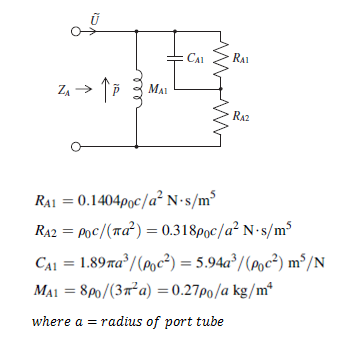

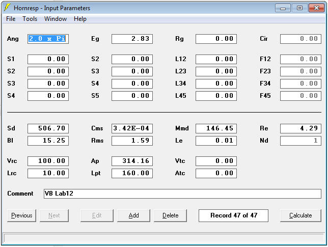

Pic #2: Time to do an apples-to-apples comparison with Hornresp; here are the inputs.

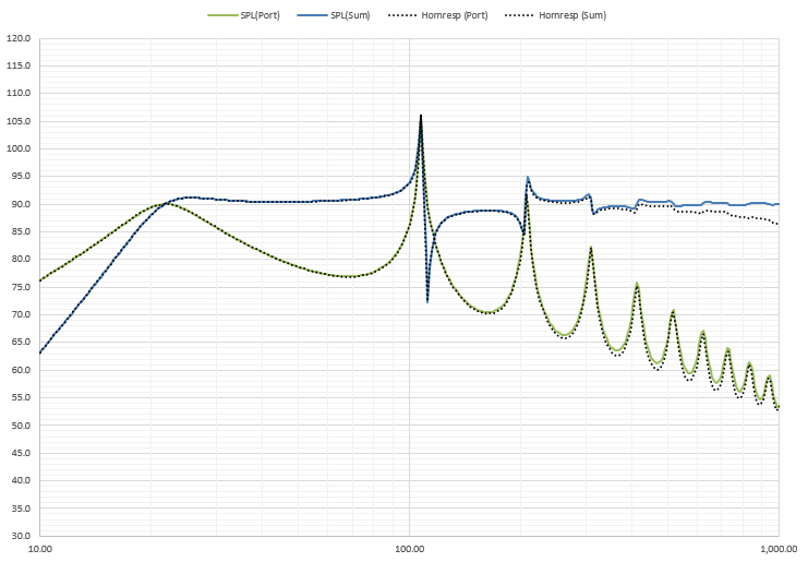

Pic #3: Port and Piston+Port comparisons with Hornresp.
- Left side comparison plots are using the volume velocity entering the TL port model
- Right side comparison plots are using the volume velocity exiting the TL port model
It is easy to see that using the volume velocity exiting the TL port provides a satisfying match with Hornresp. The differences in the amplitude of the peaks at higher frequencies are due to the simplified port model used by WinISD. Looking at equation (41) in the white paper, the port is modeled as an open ended tube. If radiation impedance(airload) at the port exit was included, the match would be even better…but probably unnecessarily complicated considering the purpose of WinISD.

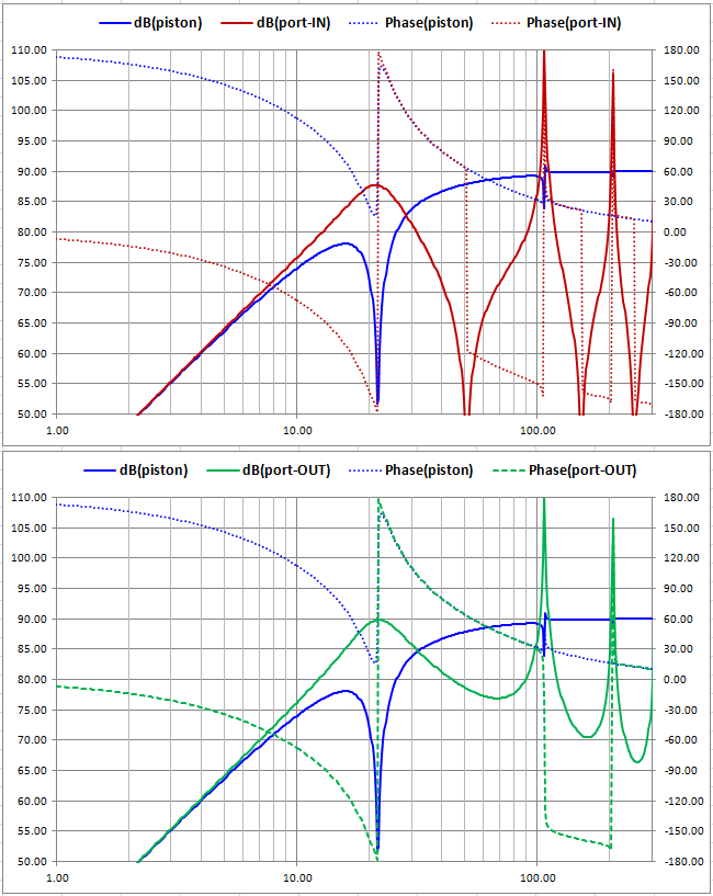

Pic #4: Plots showing piston and port magnitude and phase. Looking at the phase just before and after the first peak(~110Hz) you can understand why the WinISD plots were showing a "dip-peak" while Hornresp was showing a "peak-dip".
For a constant cross-section port, there is a simple two term equation to calculate the port exit volume velocity from the port entrance volume velocity. I will email the author of the white paper to see if there might be interest in updating WinISD with this improvement.

Just for grins I tried adding the simplified radiation impedance model from Beranek/Leach to the end of the port to see how well it would clear up the remaining discrepancies. Survey says....surprisingly well, for such a simple model.
