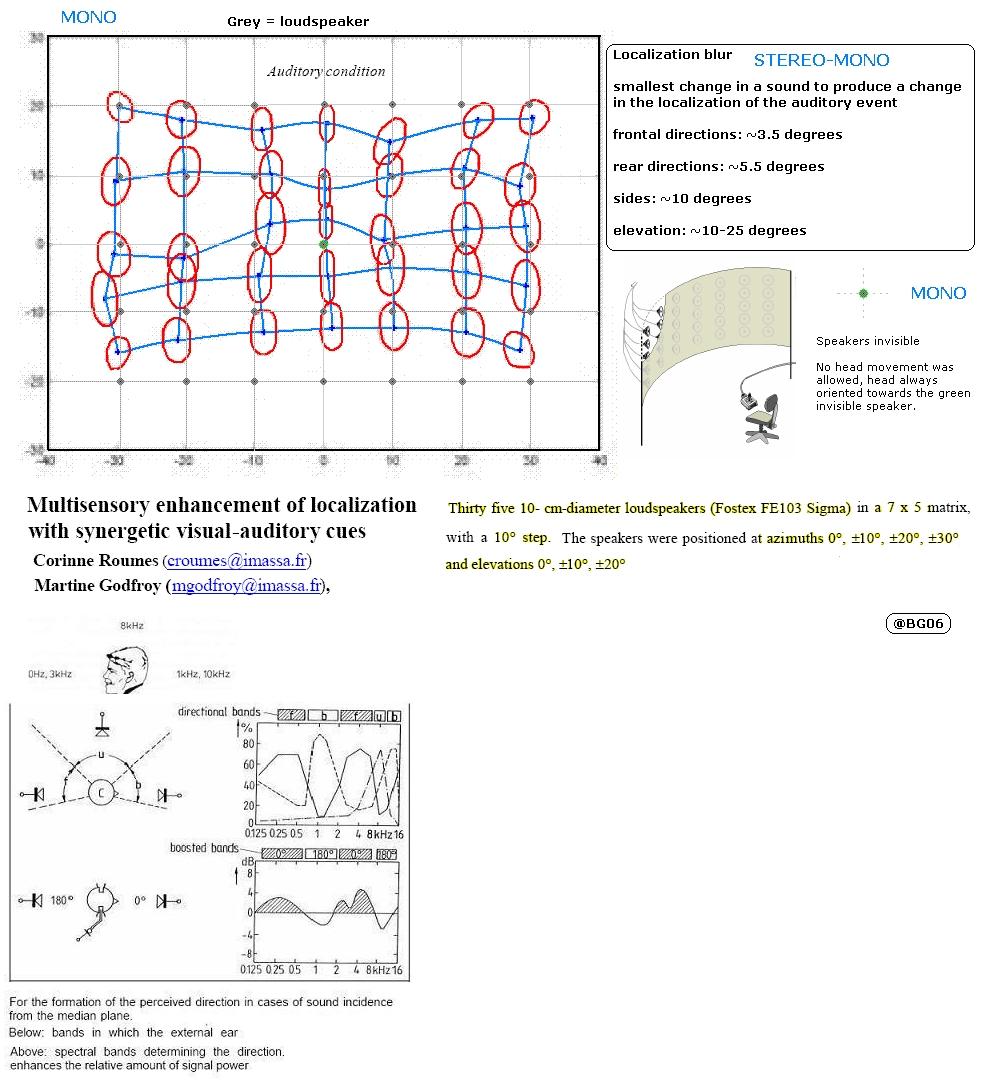

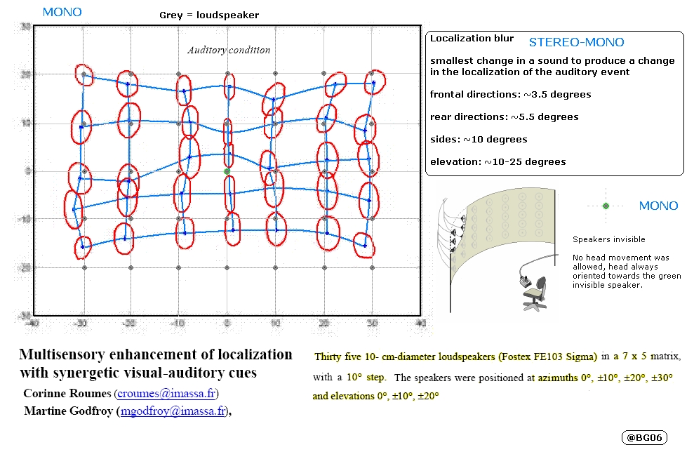

Yes, there are ~3 different mechanisms involved
1. The Pinnae effect.
2 The localization due to spectral BW. and
3. The Cultural (learning and age) depending effect (Hear is what you see),
Pictures: 1-3....
