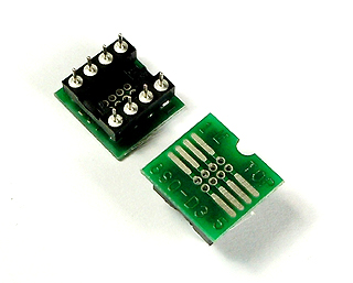

If you want the best properties of the duals, you can always use standard NXP , Infineon, Toshiba etc. duals in SMD format. The matching will be intrinsically close and you can mount them on miniature adaptor boards to allow you to plug into a DIL socket as these examples or in matrix board for trials.

Just out of curiosity- did you ever find some of these that came mounted on a DIP Adapter board?
