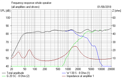

I just ran a sim for a 450uF capacitor. It does next to nothing. The dotted line. 😕
If it was a 47uF, the effect would be a dramatic loss of bass below 200Hz. Turning it into a centre (voice) speaker for home cinema.

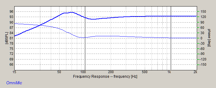

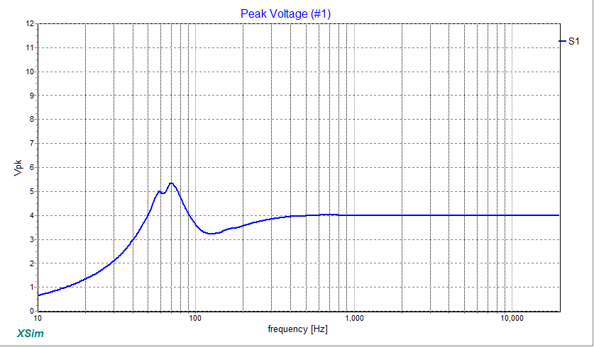

Here is the voltage bump given by a 1000uF series cap into the impedance of a pair of paralleled woofers in a sealed cabinet I have here (resonant peak at 91Hz). Without the cap, it's just 4V across the woofers.
attachment.php
Q of this cabinet is pretty high, but I think with lower Q it would work a little better.
in dB:
attachment.php

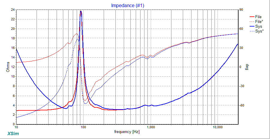

This is the impedance matching the situation for the plots I showed above. You can see how it works -- the impedance just below resonance with the cap (blue trace) is reduced compared to the "without cap" (red trace), which puts more current through the woofer(s) there. Then, a little lower the impedance goes up as the capacitive reactance increases again.
attachment.php
Kind of like a simple passive Linkwitz transform circuit (though lots less versatile).

The sim does not lie. The dotted line is the effect of an ideal capacitor:

Hardly worth doing, I'd say. Any ESR (resistance) in the capacitor would reduce level too right across the basses output range. Any perceived boosting effects on bass just show how difficult subjective evaluations by memory are.
