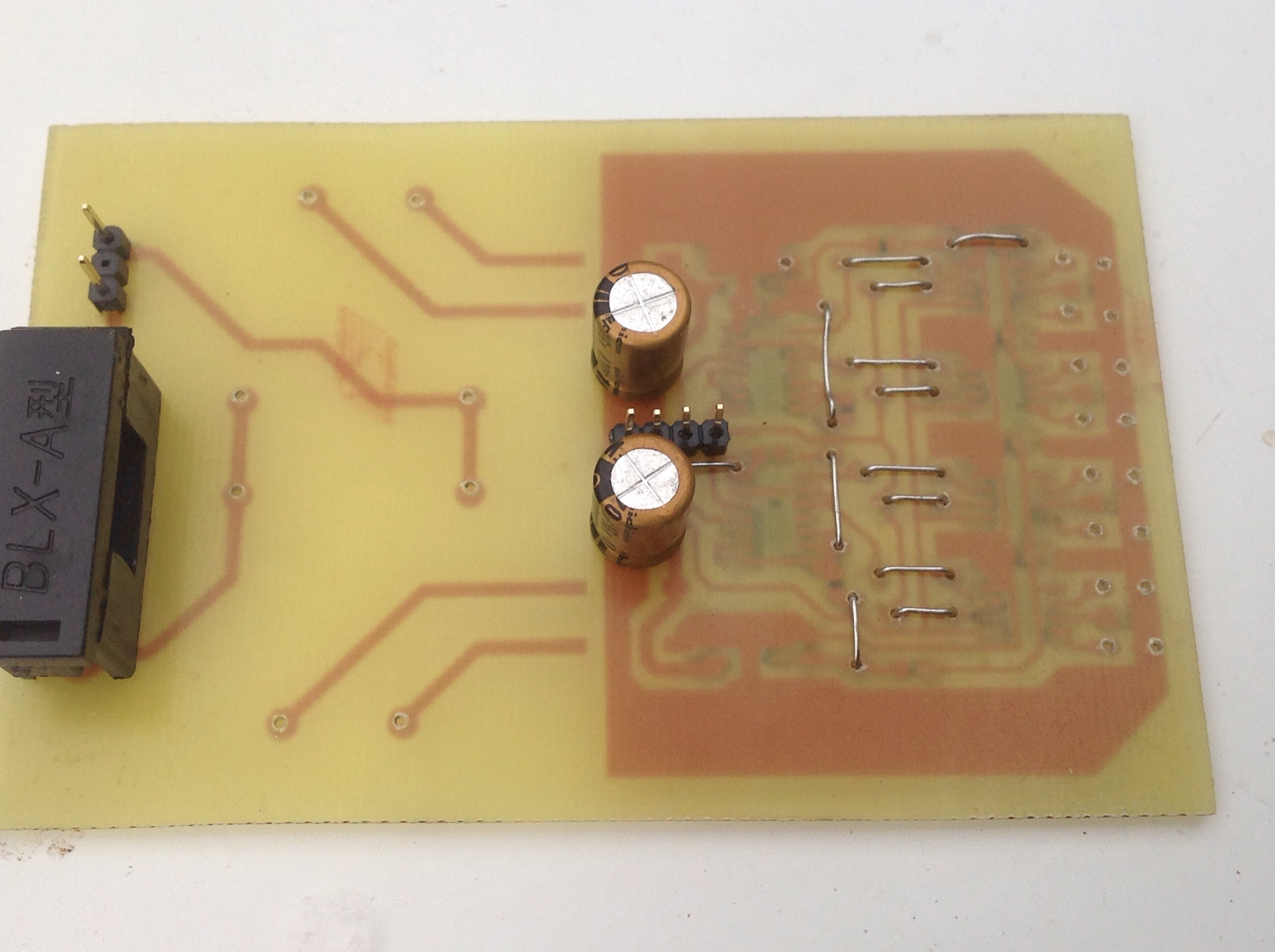

Good to see more designs using the TDA1387 🙂 You'll find that ceramics on pin7 don't sound as good as largeish electrolytics, particularly in the bass.
I will try that at a later point. On the other side from the pcb there is space enough.
I use a CS8416 board for de input, just €12 on Ebay.

My PCB has almost all the possibillities you mentioned.

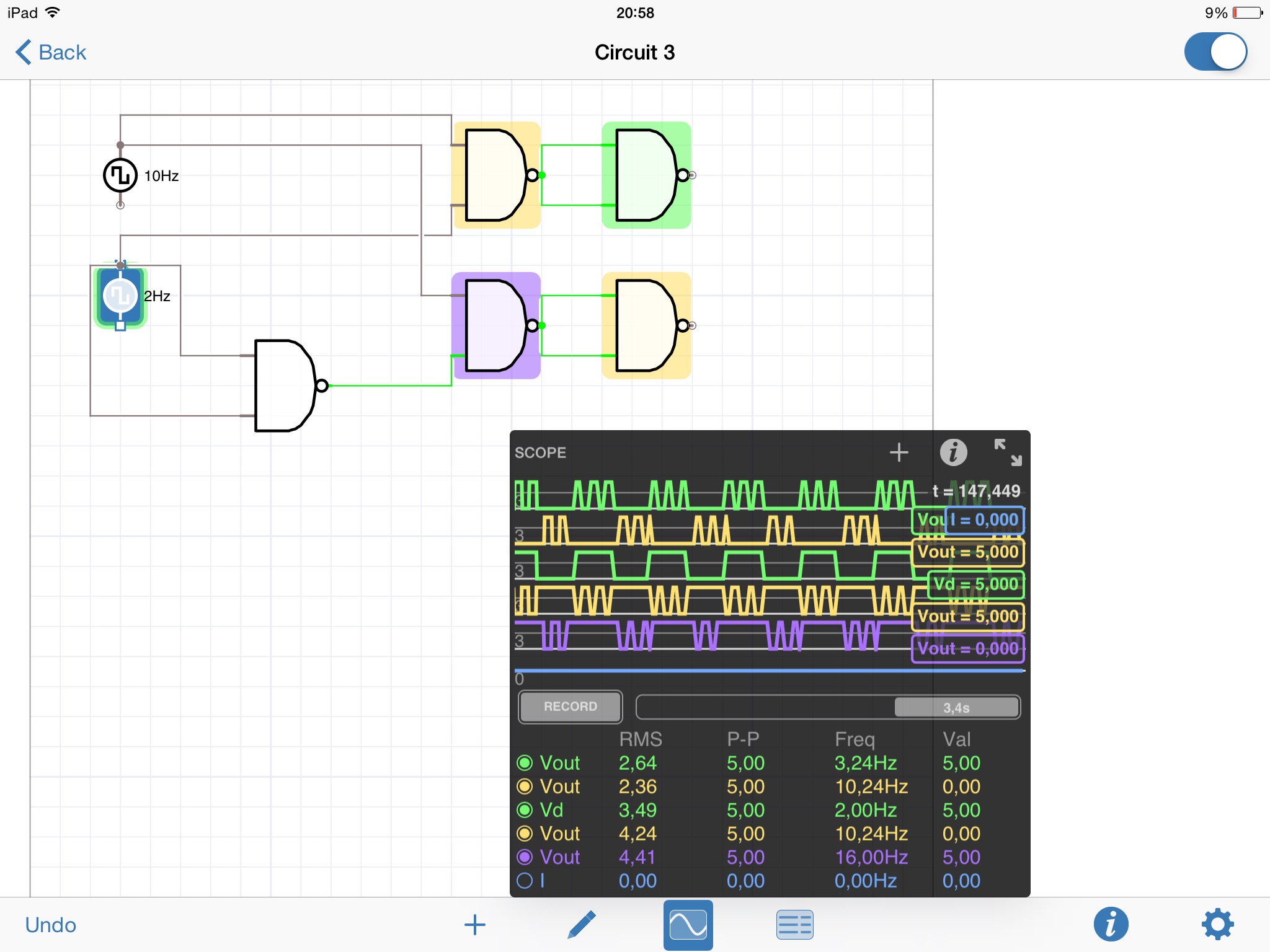

Below a picture of the dirty datasplitter with 74ahc00 nands.
2hz = WS, 10hz = Data input.
